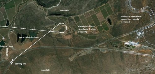

Curious questions. Was the road the only option or first option that became more prominent ? Were you at any stage worried about cars coming from behind that you might loose sight of when consentrating on the landing spot ?
These are questions that usually maul through my mind when I'm flying.
From my bird' eye view of the scene, Len made 100% correct decision to go for the N1 road.
To put the area into perspective, we were right at the end of the Hex River Valley commencing with a climb out over the mountain pass at the end of the valley. Len had mountains on three side of him, and the only option was from him to do a 180' back into the valley. The cultivated areas in the Google image below are actually pole & wire trellissed vineyards! :shock: So basically Len's landing choices of flat surface area were the dams on his right (visible in the video) or the N1 highway :( There was another road next to the N1 but which was blocked by a tall cell phone tower. Under the circumstances, and watching the events unfold "at leisure" from above, I absolutely believe Len made the right landing site decision.
