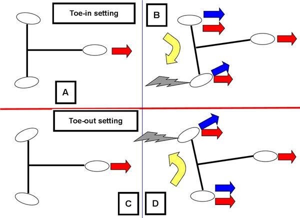

Hi,Petrodactyl wrote:The manufacturer may specify toe-in on the back wheels, but my intuition tells me that if the main gear of an aircraft toes in then the wheel that touches first will try to tuck under the aircraft, whereas if they toe out, the wheel that touches first will bring the other down, which I would think is better.
A toe-in setting is a prerequisite for directional stability.
In the diagram below , the starboard wheel would have more drag and tend to guide the trike back on centre line.
On the other hand (Darren), in [D], the port wheel would have more drag with the toe-out and tend to pull the trike further off line.
John ZU-sEXY
Re: Goose-step?
John Young wrote:Hi,Petrodactyl wrote:The manufacturer may specify toe-in on the back wheels, but my intuition tells me that if the main gear of an aircraft toes in then the wheel that touches first will try to tuck under the aircraft, whereas if they toe out, the wheel that touches first will bring the other down, which I would think is better.
John ZU-sEXY
Thanx John that makes sense. Spoke to Rainbow and they recommend toe in for directional stability as you said. Spoke to a well known instructor at Springs (once a builder on trikes) and he recommended toe out because of the wheel "tucking" under the aircraft..... The diagram makes it simple.
