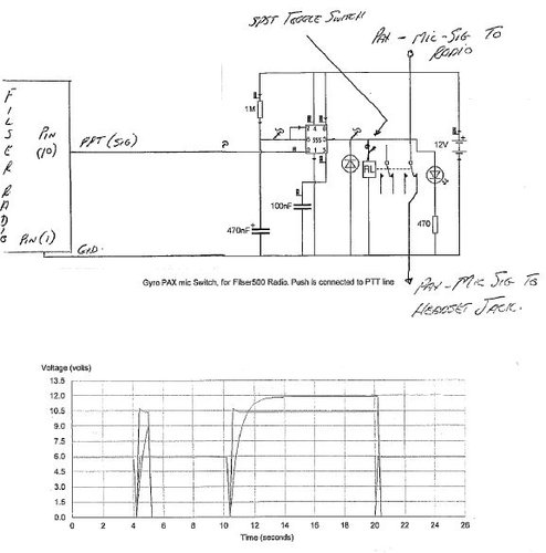

Hi Guys
Herewith is the little circuit, that cuts out the PAX mike when transmitting to improve the signal to noise ratio, when carrying a one. I also change the VOX level from 3 to around 4~5 when in flight with a PAX onboard to avoid the intercom being activated all the time, hence avoiding listening to the constent outside noise, when on the ground, VOX back to level 3 and normal chatting can occur whilst taxing and shutting down.
The use of the circuit is at your own descretion. hope it can assist... (^^)

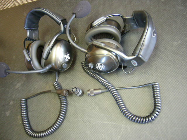

Paul has sent me two sets of headsets wich I received last week via Piet Meyer - thanx Piet. :wink:
The two headsets are linked via an Air magic intercom system, without a radio interface, BUT our major problem is windnoise through the intercom anyway, so that is what we'll be testing. According to Zulu the radio interface for various radios is a piece of cake if the system works. 8)
First impressions - WOW - great headsets, comfortable, high quality, intercom clear as though not through a headset - tested in my office. :wink: Unfortunately my gyro's rotorhead is in for a service and I've been away for the long weekend. Me and Mak decided to give it a test, but the crappy weather snookered us the past week. Tomorrow if all goes well, we'll be in the air - testing. :mrgreen:
According to Piet Meyer this stuff is ehhhrrr........ MAGIC on the trikes. :lol:
If anyone intends buying new headsets, maybe wait a week or two. :wink:

So after all Low Level’s excuses ran out not to fly with me and his failed attempt to do a conversion to fly from the back seat legally (as he is "currently" grounded) we finally got to test the headsets that Paul has sent us and we are very impressed. They are comfortable with a good fit around the ears. We only had the two headsets connected without the radio interface, no Vox or squelch setting possible, but even without this interface and Low Level hanging out in the wind (to test the system) the outside noise was minimum and the intercom worked perfectly and was very clear. We could speak in a normal tone, no shouting required to hear each other over the wind or engine noise.
I can only think that with the radio interface and correct Vox & squelch setting this would be the almost perfect system for open gyros with zero engine or wind noise.
Hopefully we will get a report from T-bird once he has tested the headsets.

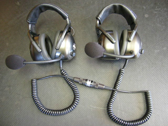

Connected
Showing the 7 pin plugs and intercom interface

An update, after discussing with low level we have made the units in the picture ANR (Active noise reduction) with our inbuilt wind reducing microphone array. They will be sent up early next week with a interface so they can operate with a microair radio. They have a on/off switch, trouble is I think that as you hear nothing they may be dangerous for the pilot.. Maybe the worlds first headset designed for a open gyro ?
Proof of the pudding is in the flying. We will continue the research with him.
