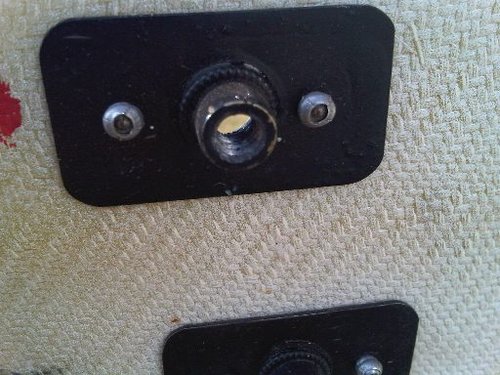

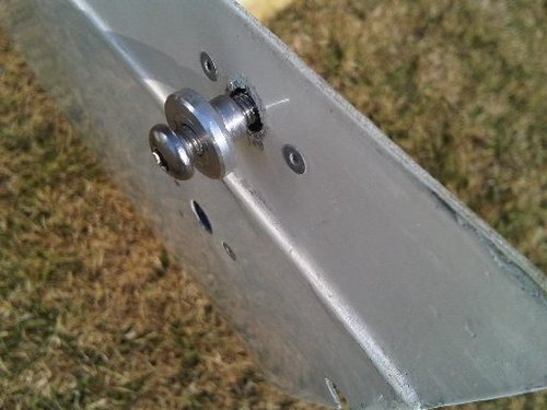

Also maybe consider a plan for the 3 dzuz (each side) that hold the cowling to the firewall side. Maybe it's easier with S.Steel DZUZ but with the allie ones its a bugger. See pics for fastners that work..
Cheers Ian

The fasteners looks like a good option, I must say I do not like the current setup! Will make a change.
