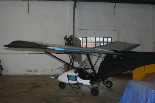

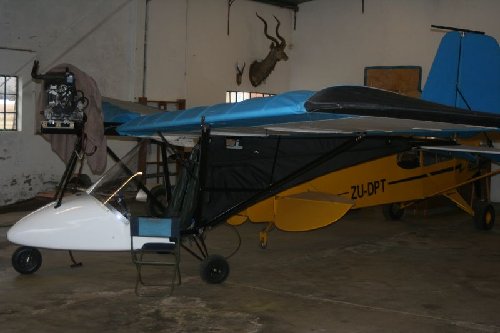

Have been useless at taking pics but it's also parked in between 5 other planes so not easy to get pics.

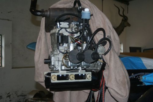

But so far. Airframe together - wings on - tail feathers all done. Engine on and complete except for wiring the mag switches and charging electrics, fitting a gearbox and prop and doing the radiator brackets.
Avionics and gearbox still missing. Have a prop on loan to test. So now we wait. Last pictures I took was when I pulled it out to wash. Here goes.

Engine 99.9% completed(just throttle and choke cables to be fitted). Will most likely start this weekend.
Wiring to be done + 1 x instrument acquisition and fitment to be made and we are there. Switches etc. all bought.
