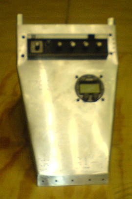

Sometimes I wish I had one of those 'bells and whistles' workshops... Spent 1.5 hours just cutting out the hole for the transponder. Measure 3 times. Drill relief holes, drill starter holes, rough cut with a jig saw (I think I am deaf now), then finish off the last few mm with a file (and my arm is about to fall off).
BUT it does look good after all that effort. It is nice to see the transponder in the panel.

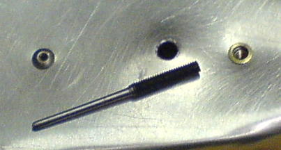

Just been experimenting with a home made rivnut tool. I decided to attach the non structural bits (mainly the instrument panel) with rivnuts. I don't particularly want to invest over R1000 in a tool to pull a handful of rivnuts, so I decided to make one...
I saw a picture on aircraftspruce.com showing a simple tool (that sells for USD10) to pull rivnuts with a standard hand riveter - so I tried to copy it:
Basically took an M4 bolt, annealed it, then turned it down to a 3mm stem to fit a standard rivet mandrel. Pulls perfectly! I managed to pull the rivnut out later, but not without tearing the aluminium I set it in.

1) I shouldn't have annealed the bolt - it is way to soft now. (It was the only sane way to turn it in a drill press though.)
2) I think I pulled a muscle in my shoulder setting the sucker. I need to modify the riveter to use a slightly shorter throw, so I can grip it in my hand, rather than squeezing with two hands.

Thanks guys. For now it seems my makeshift puller is working perfectly. Sets the rivnuts absolutely solid, and works as easily is a pop rivet :D . Wouldn't try to set anything bigger than an M4 rivnut though!
I did have to remake it without annealing the bolt though, as the first one sheered off after the 2nd pull!

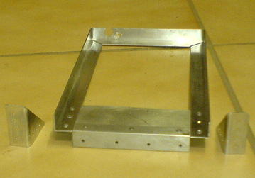

Also made a stuff up measuring up the transponder bracket. Was going to rivet it in, but with all the holes skew, that wouldn't work. Used rivnuts instead, and it should be OK. I don't like it, but the extra holes will be covered anyway, and they don't affect the strength. And I really don't feel like remaking that panel!
Naturally, I didn't come anywhere near meeting my targets for the night, but here is a super bad photo of the almost complete centre console.

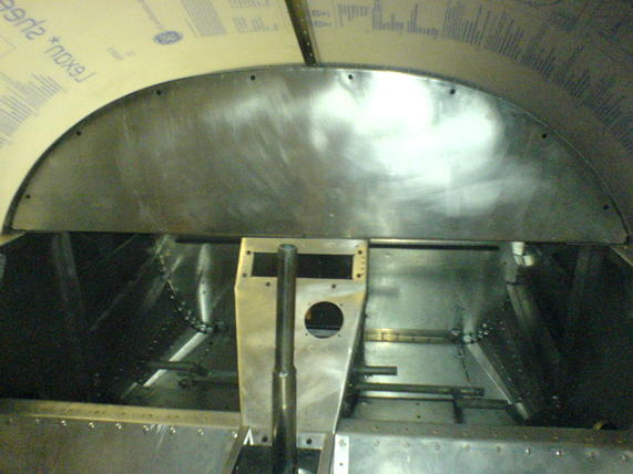

The main panel, redone with rivnuts, cleaned up, and the centre console fitted. Also took out the fuel tank while I had the panel out. Need to replace the filler neck with a short one, and put a propper strainer on the outlet.

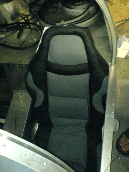

Trial fit a seat. If tomorrow is still hot, I will do the layups for the final seat backs.

Only made one seat back today, and fixed the backup ASI (second hand - had a static leak).

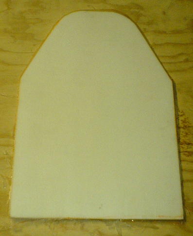

Really boring photo of the seat back:
Got the design on ch601.org. 2 layers of depron, and covered in 290g glass. Weighs in at 430g. Original zodiac design weighs 800g per seat. So much effort to save 740g... Was it worth it? I suppose time will tell.

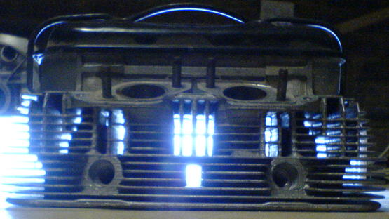

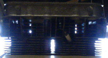

Just as a matter of interest, I took some backlit photos of the type 1 and type 4 VW heads.
Type 4:
Type 1:
This is why the type 4 can handle so much continuous power. Not only much bigger fins around the outside, but a large amount of finning on the inside - every part that doesn't have to be solid, is hollowed out and finned. All the valve guides, between the cylinders, around the ports - the works.
The type 1 has some finning around the exhaust port, and a huge hole through the middle. A tiny fraction of the fin area of the type 4.

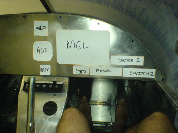

Been playing with paper planes, or at least paper instruments:
I made a template of each of the instruments, indicating the maximum external dimensions of all of them, and stuck them to the panel, to confirm visibility, accessibility and spacing.
Aside from these requirements, the only other goal was to place the compass as far from the electrical systems as possible.
Any comments?

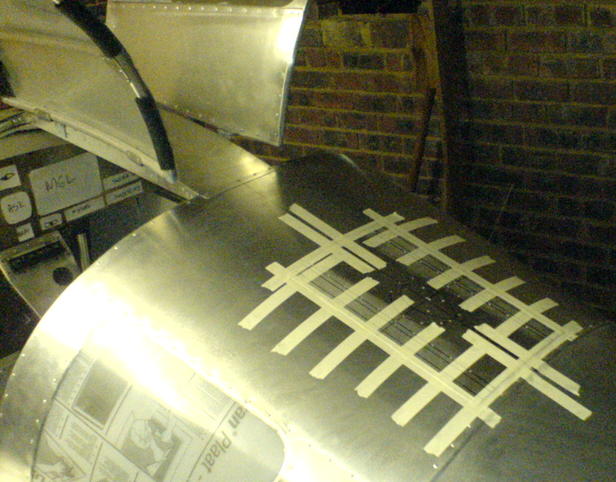

Antenna doubler:
Taped to the outside of the fuselage for match drilling. Will obviously be mounted inside, with all mark folds downwards. Hope I am not stuffing this up. Calculations say that the measurement difference between inside and outside is only 0.1%, and accessibility from outside is soooo much better...
