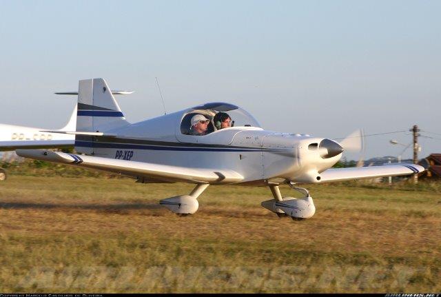

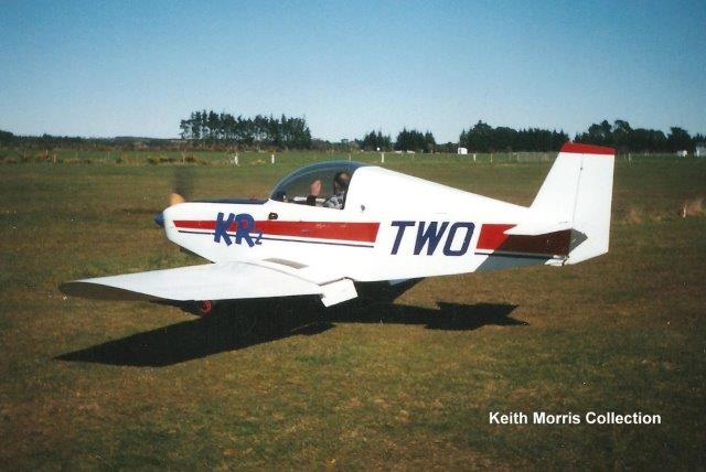

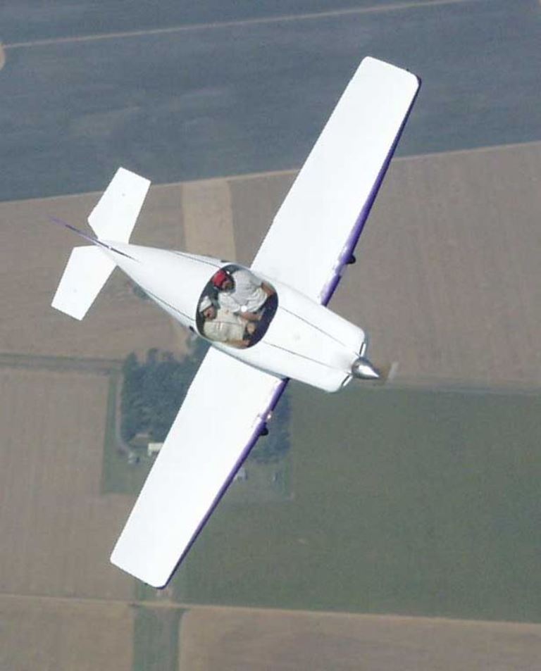

Long distance two-up KR2

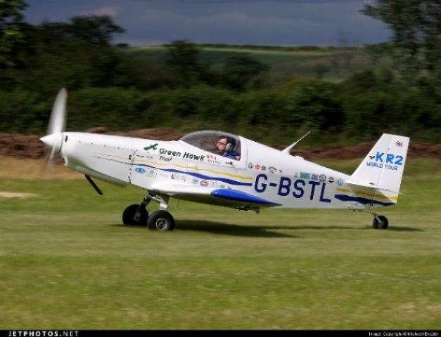

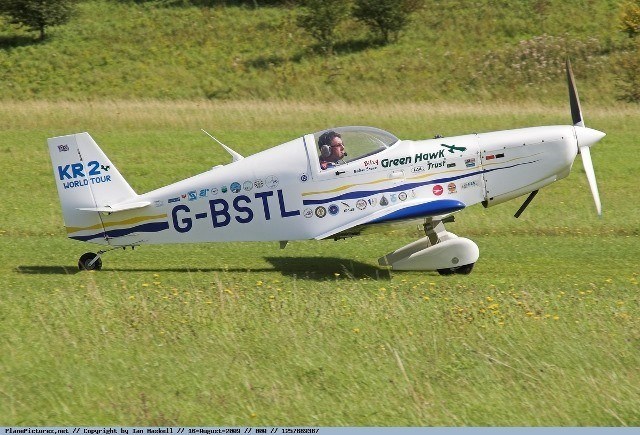

Henni, I know in the USA many guys fly 2 up, maybe one of the reasons we see it less seldom around here is that many of our runways are a bit shorter than in the USA?
The British couple did fly 2 up plus LOTS of luggage and even a raft at one point from the UK to Australia in a standard KR2 with a 80hp Jabiru engine.
It also depends a lot on the size/weight of the 2 people....

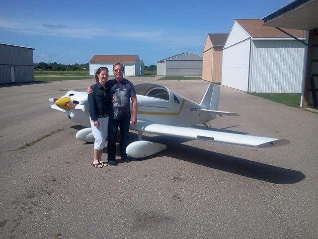

Doran wrote:My kr2 has been flown with two people in it since 1993.
The two brothers I bought it from flew it cross country together and had no issues with two up flying.
Also their mother flew with them on a regular basis. They were not heavyweights average Pilots 160 and 180 pounds. With the exception of their mother of course! She was lighter!
I have yet to fly it with my wife but we plan on doing quite a bit together this summer.
My plane is a stock KR2 weighing in at 612 pounds. Power is a Great Plains Volkswagen conversion 2180. 70 hp at 3400 rpm.
Doran
N186RC
See the pic of Dorans KR2 attached!

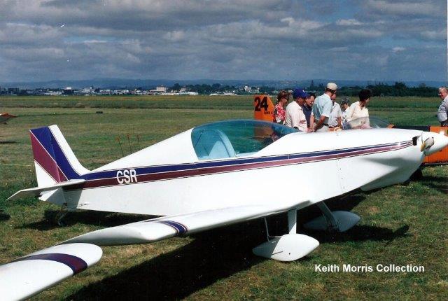

Quote wrote:I am building my KR2S now with 2 up in mind. This is why I have widened the shoulder. Area to 43" outboard width instead of the plans spec.
I have increased the rest of the fuselage to compensate for the differences

Mark wrote:I've said many times that the width of the "plans-built" KR2 is simply too narrow for two normal adults. I weigh 138 pounds and my wife is about the same (both skinny by American standards), and we're a tight fit in N891JF.
I've flown in serveral stock-width KR2s, and I can tell you that anything longer than an hour is going to be painful for two folks that pass for "normal" these days. The big problem is what to do with the passenger's shoulder and arm, because two people's shoulders can't occupy the same space at the same time! So the passenger has to put his arm behind the pilot's head. Sounds easy enough, but the geometry of humans is such that it's very uncomfortable, and that hand has to be folded up because there's an aft
deck there and the hand won't fit otherwise. Hands don't like to be
folded for an hour.
What people may not understand about the KR2S is that it is built to exactly the same width. The one dimension that begged to be changed the most, went untouched! I'd flown in KR2s with several folks before I got to the boat stage on mine, and widened mine 2.5 inches at the shoulder. That number was arrived at after measuring my wife and I with an inch between our shoulders.
Wider folks will want more width. Widening the plane is not a huge hit to speed.
Weight is another consideration. I think nothing of flying folks in N56ML,
especially light ones. The difference in climb rate and pitch sensitivity is barely noticeable. Throw a 250 pounder in there and it makes a difference on both fronts, especially climb rate, and I have 130 HP out front, but it's still doable, and at least they physically fit. I've already decided that N891JF (stock width KR2) is going to be a single seater, unless the weight and balance has improved since I last flew it.
According to the W&B sheet, it starts out very close to the front of the CG range with a light pilot and full fuel, and it was still noticeably more pitch sensitive than N56ML (widened KR2S). I'll be doing a new weight and balance soon, and I probably shed a few pounds during the "refurb" effort.
Let me get some more hours on it and I'll report back, but for the moment I'm thinking it's a single seater except for kids. Some Brit can correct me if I'm wrong, but the Brit rules for KR2 gross weight and CG location is so tight that kids is all they can carry.
For more on this kind of stuff, see http://www.n56ml.com/kopinion.html .

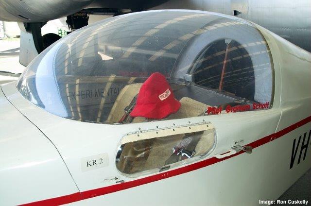

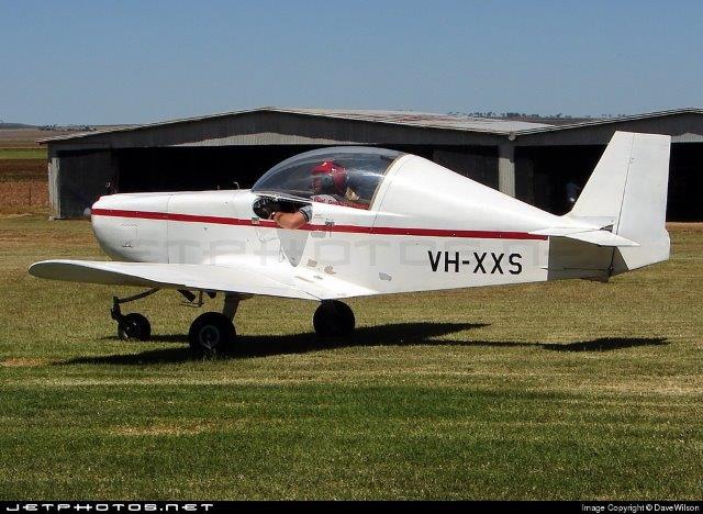

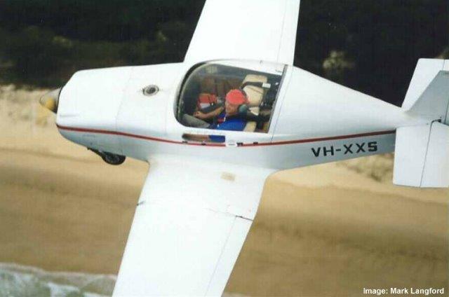

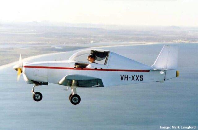

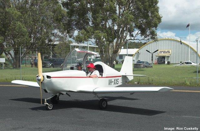

Paul wrote:The canopy was fitted about 6" above the longerons to improve headroom. This
left him with a blank area of infill in which he built and installed a
bubble window. This bubble, as well as improving visibility, could be opened
to improve airflow on the ground while taxying as well as a convenient area
to stick an elbow in a tight cockpit.
Unfortunately we lost Graham 6 months ago to cancer. Some notes from the
secretary of our local SAAA club (edited slightly):
I have some sad news, one of our long standing SAAA members passed away on
the weekend. Graham Schott lost his battle with cancer.
Graham was a staunch advocate for SAAA. Always promoting SAAA where ever
he went in his little plane VH-XXS (XXS for eXtra eXtra Small). I can't
remember how long Graham has been flying his little KR-2 but it seems like a
long long time. Sue and Graham have flown that little plane everywhere.
All around Queensland's outback, Avalon, Mangalore, Cowra, Wagga, Narromine.
If there is one thing that Graham has inspired me to do it is to fly my
plane like he flew his. A plane should be flown and not sit in a hangar,
and Graham and Sue got the max out of his/their little plane.
There a many stories to tell about Graham and Sue to many to tell here but
to mention a few, their flying outback trek around Queensland, the time he
lost his prop due to a crankshaft failure, Avalon and back, and they would
turn up at all the major SAAA events and have a story to tell. Graham and
Sue were also involved in the Caloundra Flying club with Graham and Sue

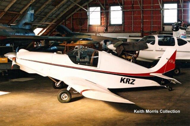

Paul wrote: Had a friend with a standard KR who built an 8" deep cushions for his
wife. The cushion was hollowed out in back and could be filled with
clothing. They went everywhere in that little bird. Google "VH-XXS"
stood for eXtra eXtra small :-).
Paul, Brisbane, Australia.

Read more on VH-XXS here.

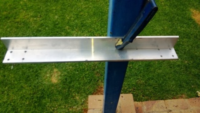

Gave all my tools to my sons as I seriously thought I'll never build something again. Now I pay the price for it. But alas, I've at least "started" to create something again & that is a good start. The flu still has the better of me, so nothing goes fast.
On my to get list:
1. a Vice!!!
2. a File!!!
3. a Press drill!!!
4. a Proper hacksaw!!!
5. a Workbench!!!
6. a Garage would be nice, but for the moment the carport will just HAVE to do!
Last pic shows the cockpit space of a plans built KR2.
Keep well all,
Henni
Ha, how's this for a "vice"...
Yup, between the flu & the age comes the chair...
Using my "vice" again...
At last, a part has been created - now for the rest...
How small is it inside?
