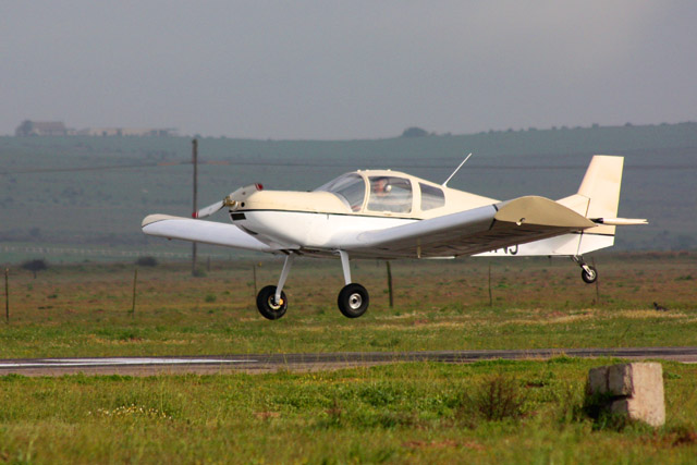

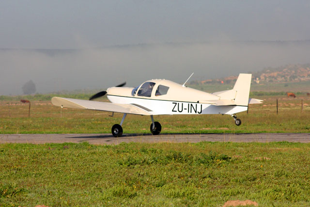

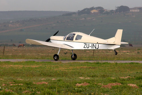

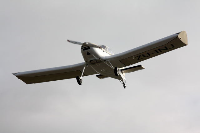

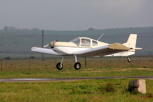

Postby Induna » Sat Jul 12, 2014 7:10 pm
Some pics... vhpy
