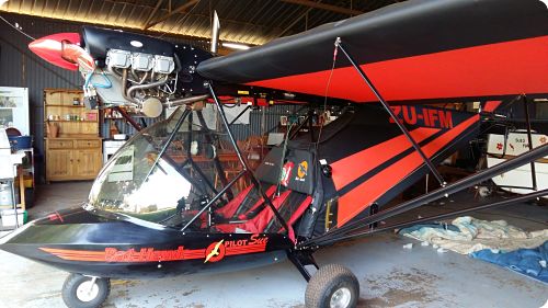

Can say with certainty that after leaning out my Baby going nicely now at about 16. vhpy 5 litres/hr at 2700 rpm /68 kts cruise , oat 13 degrees average, Camit just gets better and better . Must say as well that Piet still makes the best wooden props. (keep in mind that Camit stipulate the use of wooden props on their engines)

That is exceptionally economical.
What are the egt's reading at cruise?
Egt should max at 720 at 2850rpm
Cruise at 2850 would normally use about 22lph
Careful not to go too lean. Just 2c. Regards.
