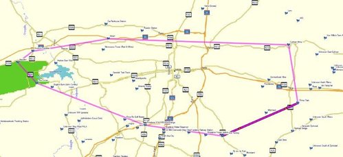

Just taking a wild 1'st stab at this, would like to route Rhino <-> Harties
Would be nice to check out as many of the fields on the other side of the world
What route would you regulars suggest?
I was thinking something like this:
Google Earth pic:
Much appreciated

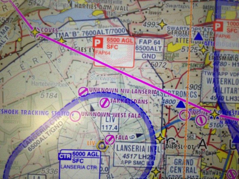

Your leg from N14/R55 to Coves is taking you slab bang over the Lanseria Tower!! Don't think they are going to be impressed.
Loco
Posts: 1097
Location: Crosswinds
Re: Advice please: Rhino <-> Harties
Postby Loco » Mon Jan 28, 2013 2:48 pm
Air Hog wrote:Your leg from N14/R55 to Coves is taking you slab bang over the Lanseria Tower!! Don't think they are going to be impressed.
Hi Johan sorry you 100% sure?
I checked on my map and it looks OK, I'm not going through FALA CTR just under their TMA?
Ant
Anthony Hugo
Crosswinds
D2O
Posts: 528
Postby D2O » Mon Jan 28, 2013 2:56 pm
Most VFR traffic route around Lanseria CTR via the Kyalami / Sandton VFR route. You would have to backtrack to Kroon after Coves, and maybe route Kyalami (Red & white radio mast to Gerrotek race course to Attridgeville quarry to Kyalami racetrack), but join Pinedene route where that route intersects more or less at the N14/R55 interchange. Alternately, you'll have to route back the way you came via Magalies Ridge, but you'll have to talk to Waterkloof ATC to get clearance to go through.

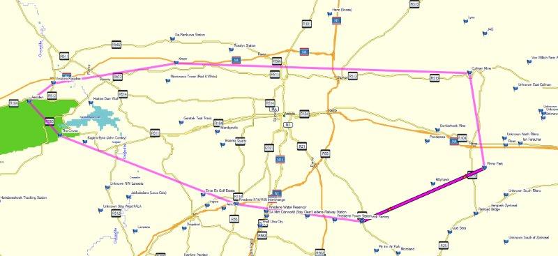

And this routing seems much more scenic & I'll be avoiding FAP64 (Pelindaba Nuclear Energy Plant NO-Fly zone):
- N14/R55 interchange
- Gerotek Test Track (S 25 45 30.00 E 28 0 26)
- The Coves
Basically follow the southern side of the dam to The Coves:

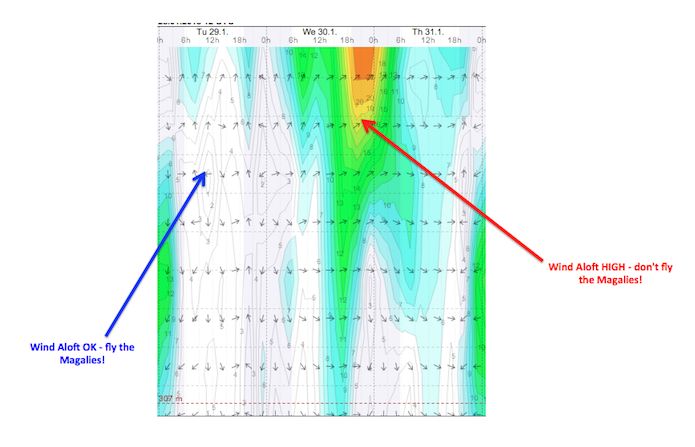

Firstly, yes, you are right, if a northerly is blowing you will get bounced on the leeward (southern) side of the Magaliesberg. The wind speed, particularly at 1000ft AGL, will determine the degree to which you will get bounced (read: size of rotor). So the trick here is to check the weather charts for Aeroden on the morning of your flight http://www.windguru.cz/int/index.php?sc=395350. If the winds aloft are less than 10 knots (white or light blue on the Windguru chart) you are good to go over the top!

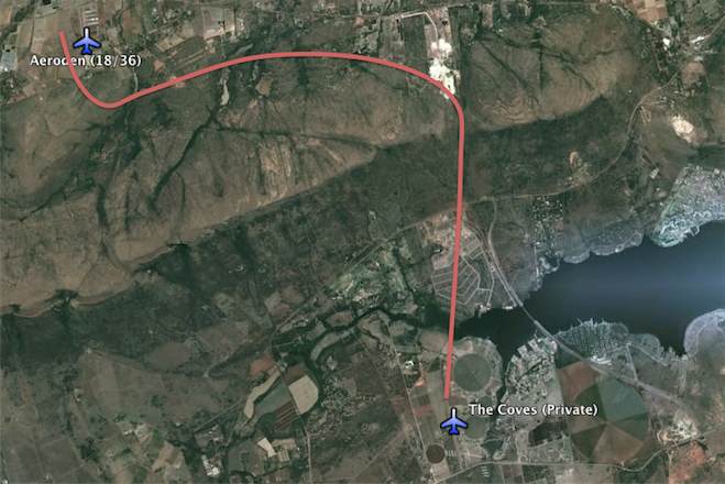

What I do more often than not when flying over from the area of The Coves to Aeroden, is I sneak through the nek directly in front of The Coves 36 (on Google Earth it is identified by the silica quarry just to the north of the mountain). The northerly wind tends to funnel a little through the nek but you trade a little more head-wind speed for having to climb over the top and getting bounced in the process!
