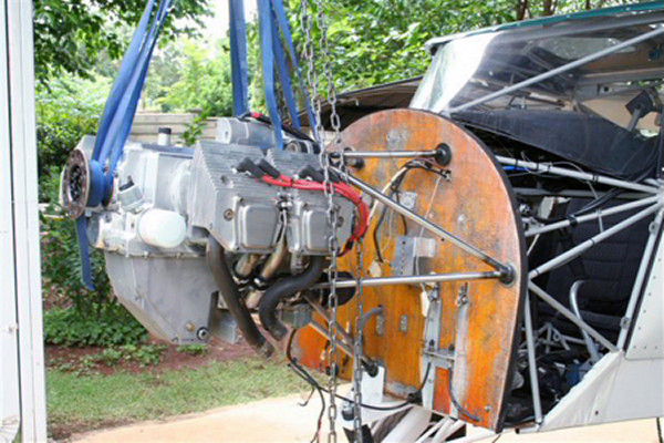

The next step was to install the engine and connect all hoses and electrics.
Engine installation.JPG (83.98 KiB) Viewed 7149 times

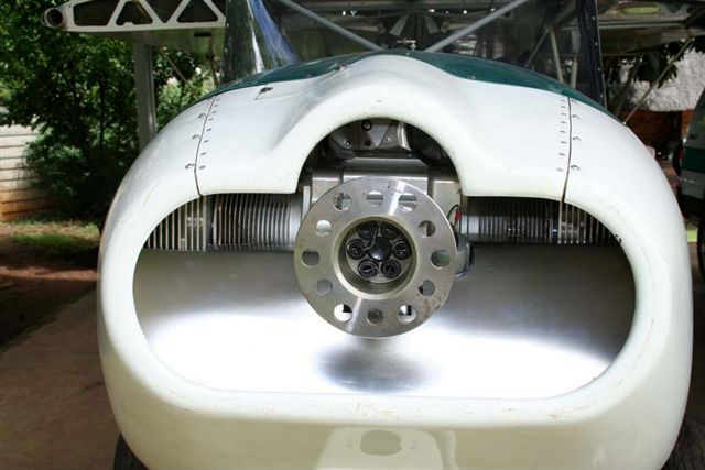

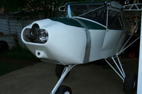

Since the Jabiru is lighter than the original Rotax 912, the engine had to be moved forward by 50 mm to maintain C of G.
The cowling had to be extended 150 mm to fit over the engine.
I also converted undercariage from tail dragger to trike.
Extended cowling.JPG (56.51 KiB) Viewed 7151 times

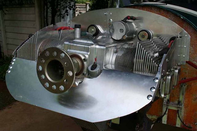

The biggest problem with Jabiru engines, apart from the prop size limitation that the direct drive poses, is cooling.
Here are pictures of the baffle plates that I made to ensure proper cooling.
Cowling Baffles.JPG (54.16 KiB) Viewed 7135 times
Baffle Plates.JPG (60.37 KiB) Viewed 7134 times

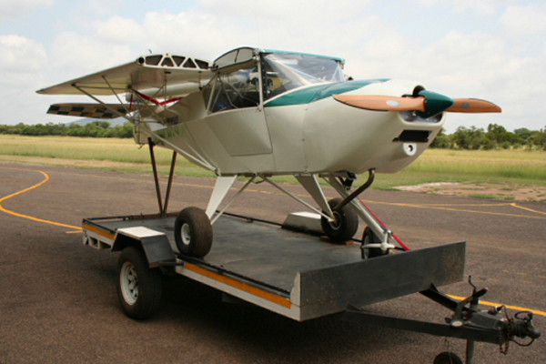

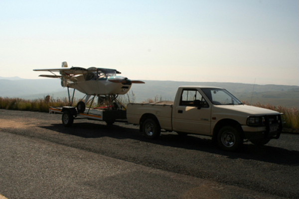

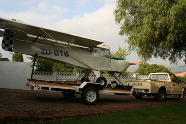

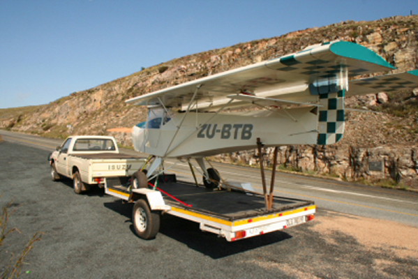

Dr Johan vd Berg invited me to have the Bushbaby tested and approved by Jan Loedolff, an instructor and AP of fame, at their field.
Here are some pictures of the transportation process:
Over the Steenkampsberg Pass 7648 ft MSL
Wished I could have flown instead of trailering!!

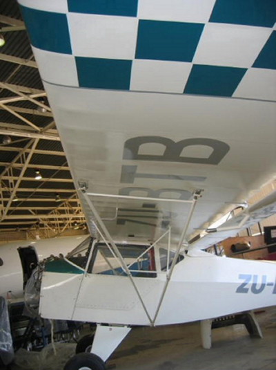

Postby Chris Liebenberg » Wed Mar 05, 2008 9:46 am
Arriving at Groblersdal FAGL
What a friendly bunch of people!!
Neat setup and well kept hanger area.
Arriving FAGL.JPG (67.51 KiB) Viewed 7094 times

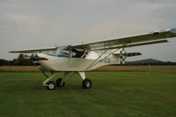

Postby Chris Liebenberg » Wed Mar 05, 2008 9:51 am
Note the 32" Brent Thompson prop on the previous foto.
This was recommended to me by Andrew pappas who did a lot of experiments with different props on his Apollo Fox's, and found this prop gave best performance.
This is part of my solution to the short prop problem of the Jabiru engine.

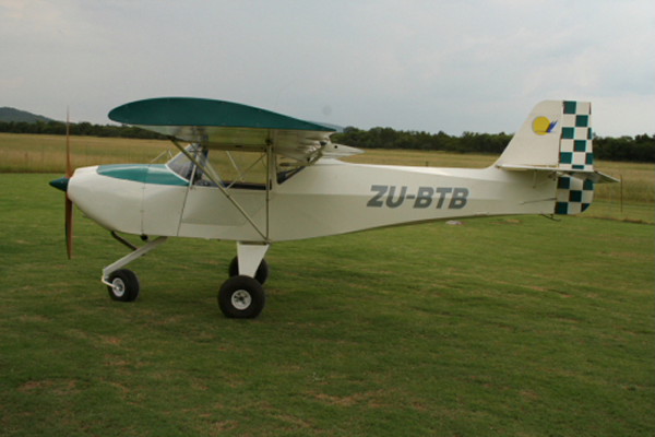

Finally it is time to spread the wings!!!
What a beauty!
Wings spreaded.JPG (48.26 KiB) Viewed 7074 times
Side View.JPG (54.51 KiB) Viewed 7071 times
