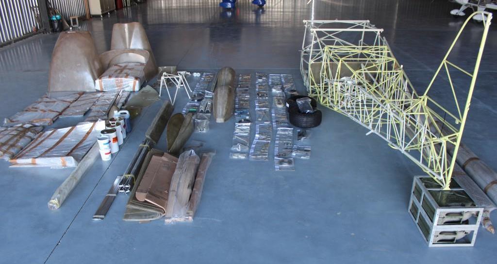

I visited Kitplanes early in September for a tail-wheel conversion. I was so impressed with Stefan and his crew's work and professionalism that I abruptly abandoned all plans to build a Sling and rather ordered a new Safari Adventure kit. 5 Weeks later Stefan personally delivered the full kit at Morningstar in Cape Town!!!
Full Safari Kit (ex Matco products) packed out

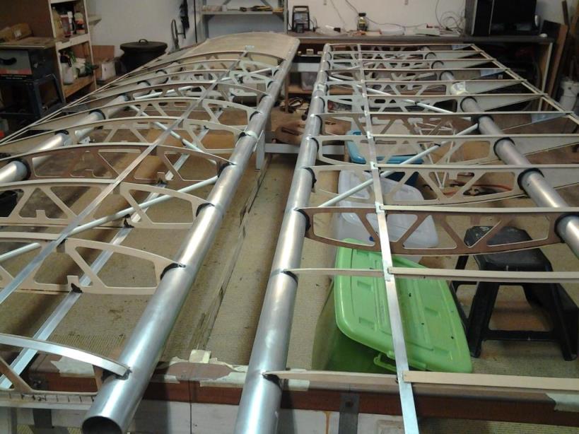

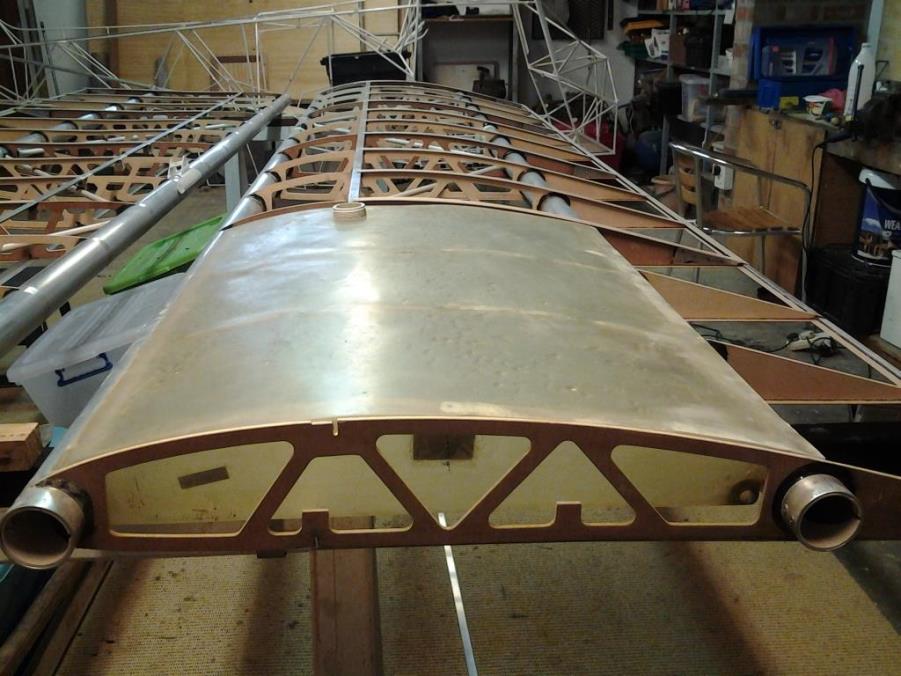

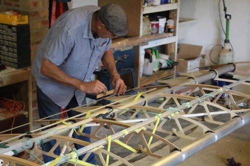

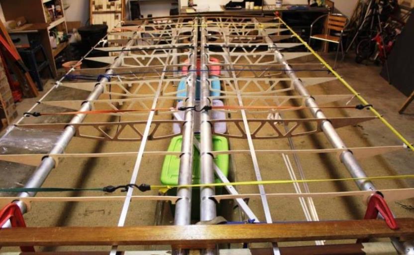

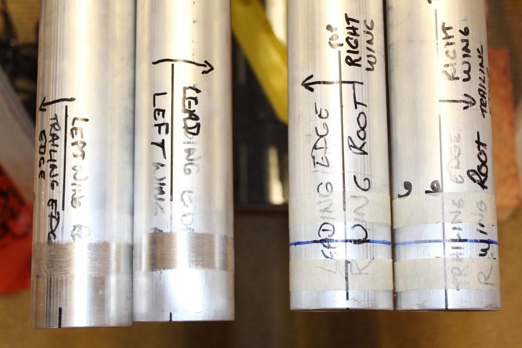

Decided to build 2 wings together. So I set up a set of trestles wide enough to accommodate both wings and leveled them with a pipe level.
2014-11-03 Mark wing spars clearly to aviod confusion
2014-11-04 Building 2 wings together side by side
Both wings with cross braces and cap strips

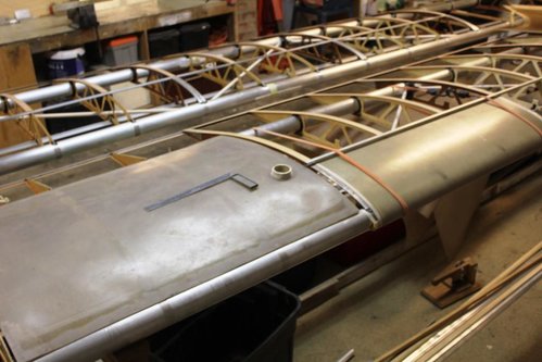

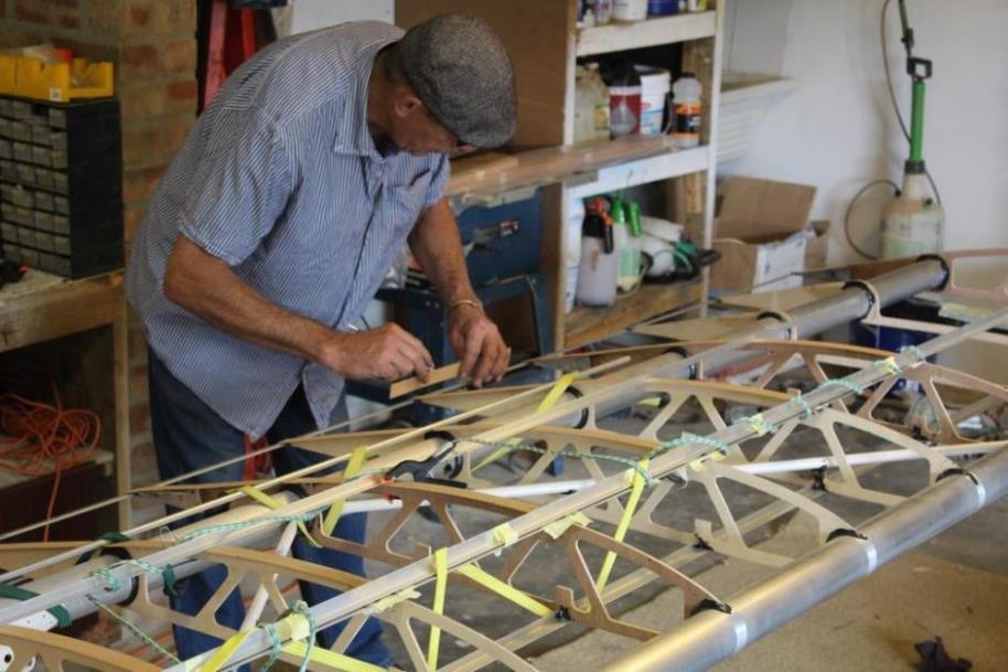

Fred fitting cab strips
Right wing Fuel tank being fitted

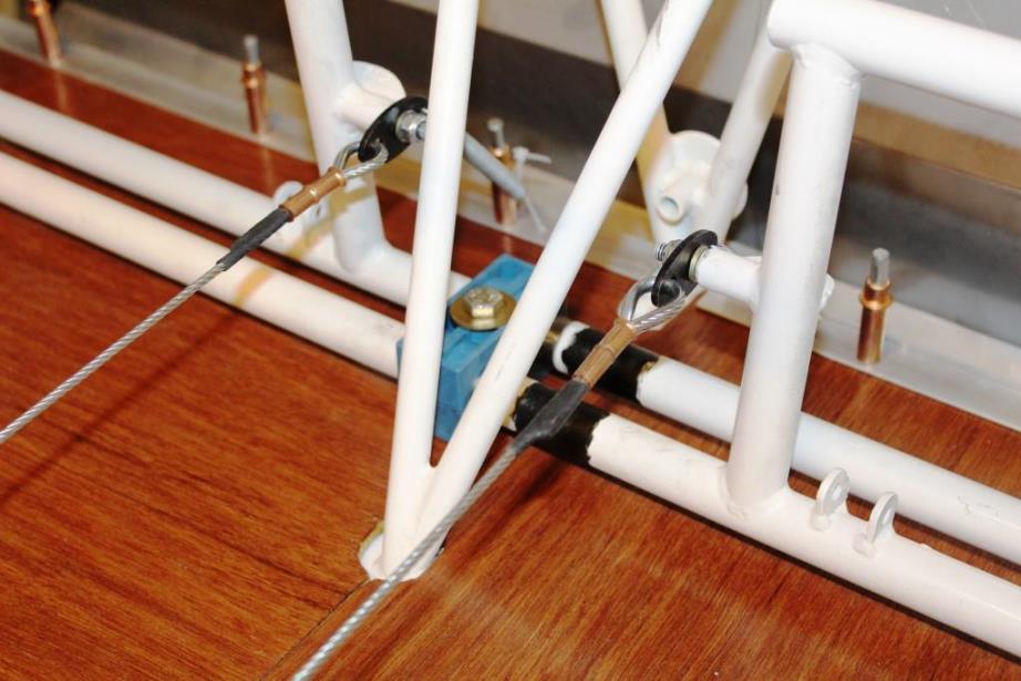

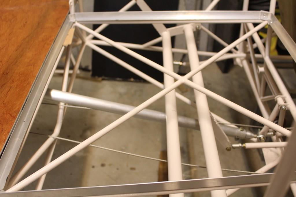

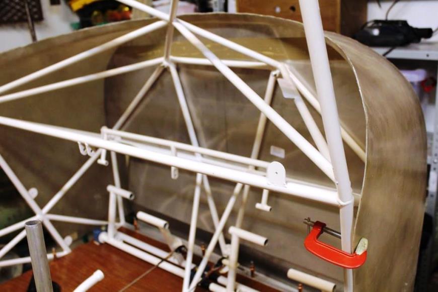

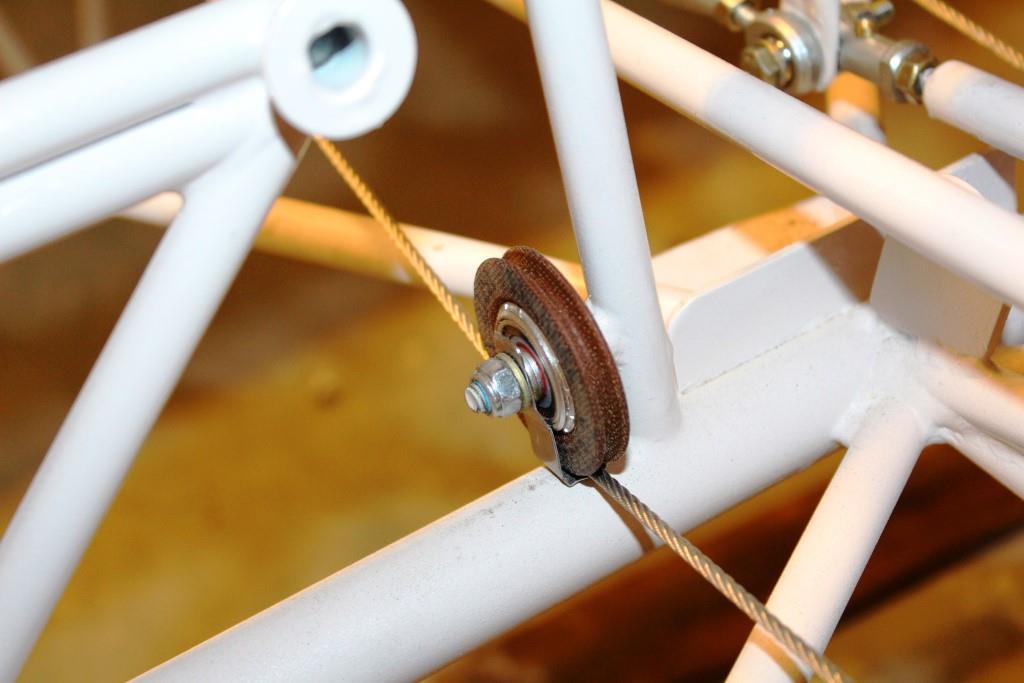

Most of the controls installed and set up. Busy with baggage bay floorboards, firewall installation and stringers.
Control Collumn and linkages all installed
Rudder pedals with linkage cables
Rudder Cable guiding pulley

Postby KFA » Mon Nov 24, 2014 10:33 pm
Onthou die kables kruis agter in die fuselage.....
Start with Firewall Fitting
Front baggage bay taking shape

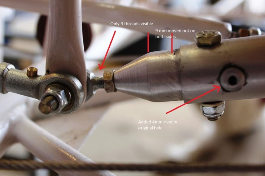

Postby KFA » Wed Nov 26, 2014 12:56 pm

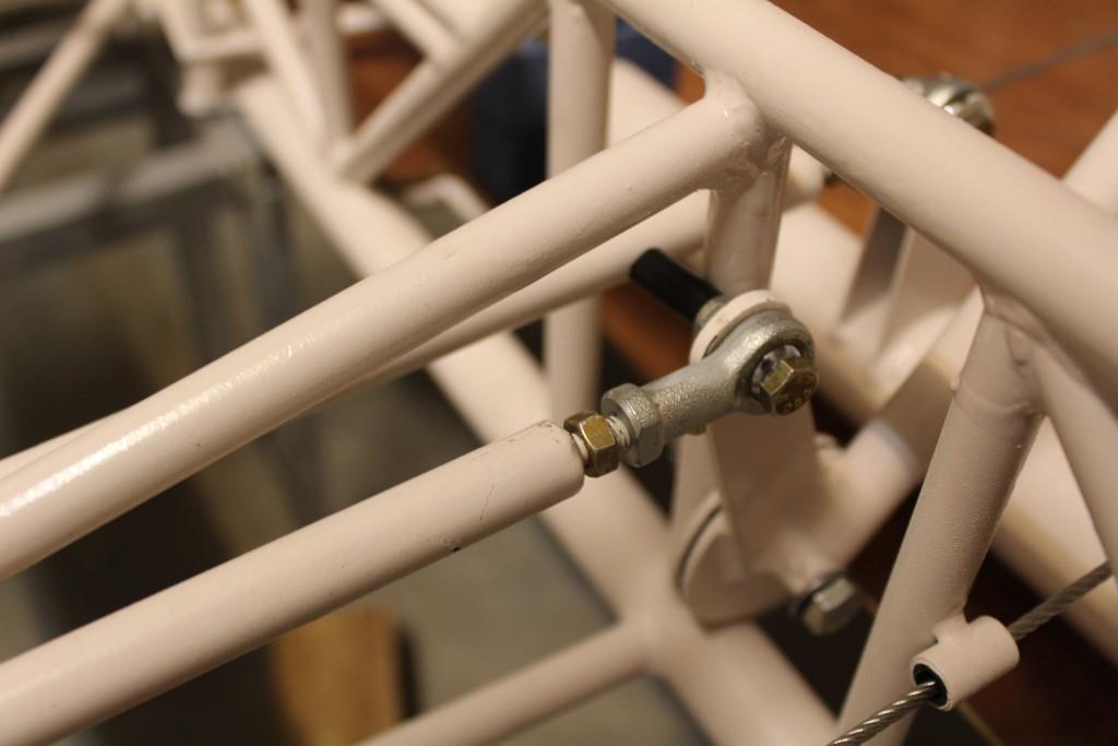

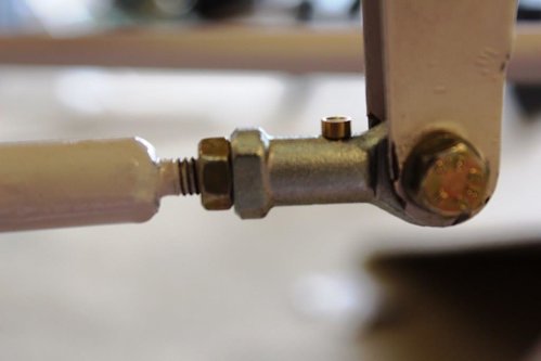

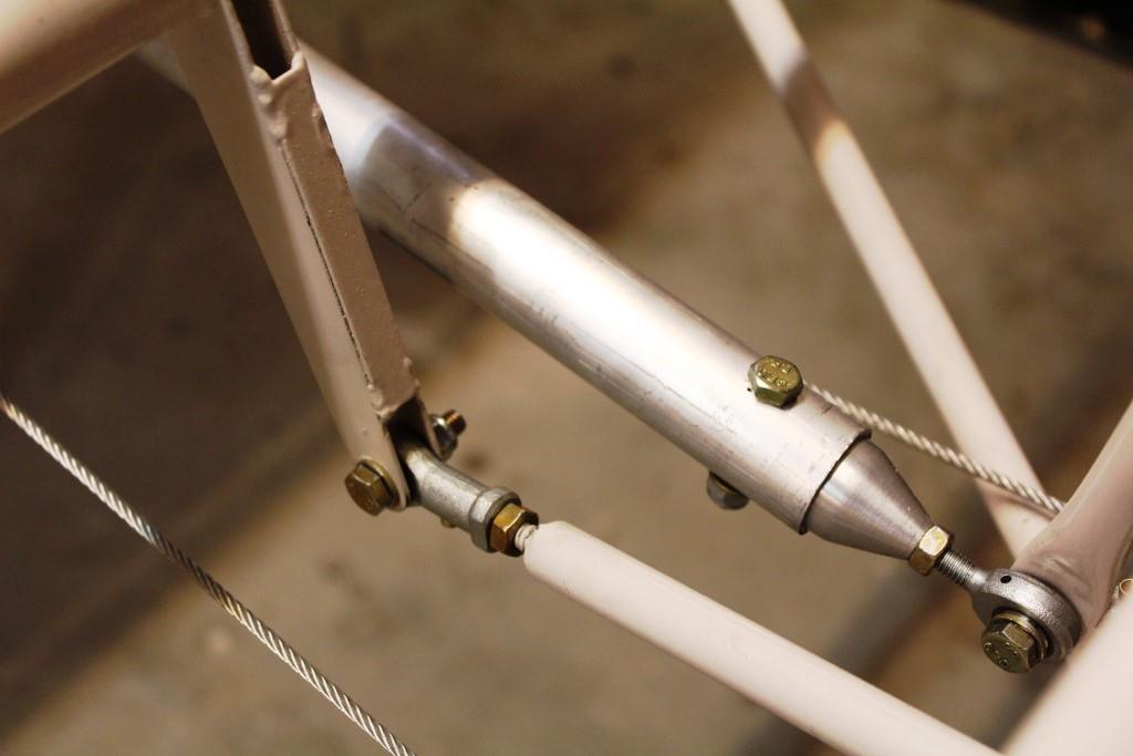

Daai Elevator push/pull se rod end is te ver uitgeskroef. Skroef eerder meer in die alli. Die staal een voor kan jy bietjie op steel.
Vlakvark
Posts: 12
Joined: Sat Nov 01, 2014 10:26 pm
Location: Bellville, Suid Afrika
Re: Safari Adventure in Bellville - SN 22-09-14 SAF
Postby Vlakvark » Wed Nov 26, 2014 1:21 pm
Stefan klaar reggemaak ** . Ons het die aluminium insert bietjie vorentoe geskuif. Al die rod-ends het ek net 3 threads uit (m.a.w tussen die lock nut en die tube)
Aluminium insert let out by 9mm
Aileron push / pull tube 3 thread only between lock nut and tube.

Postby KFA » Wed Nov 26, 2014 1:53 pm
(^^) Ek was net bang iemmand anders sien dit en probeer dieselfde. (!!)

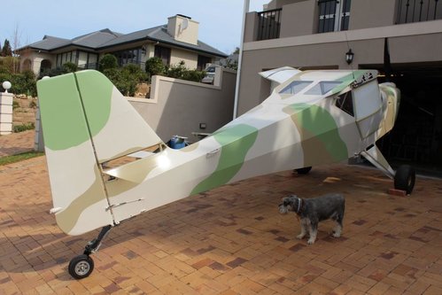

Postby Vlakvark » Sat Sep 12, 2015 8:19 pm

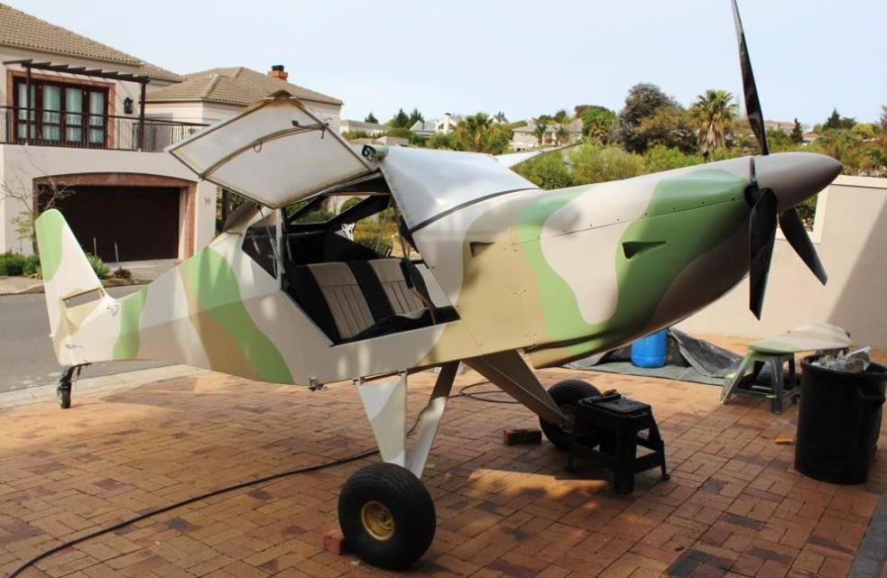

Uiteindelik staan ons nou einde se kant toe.....

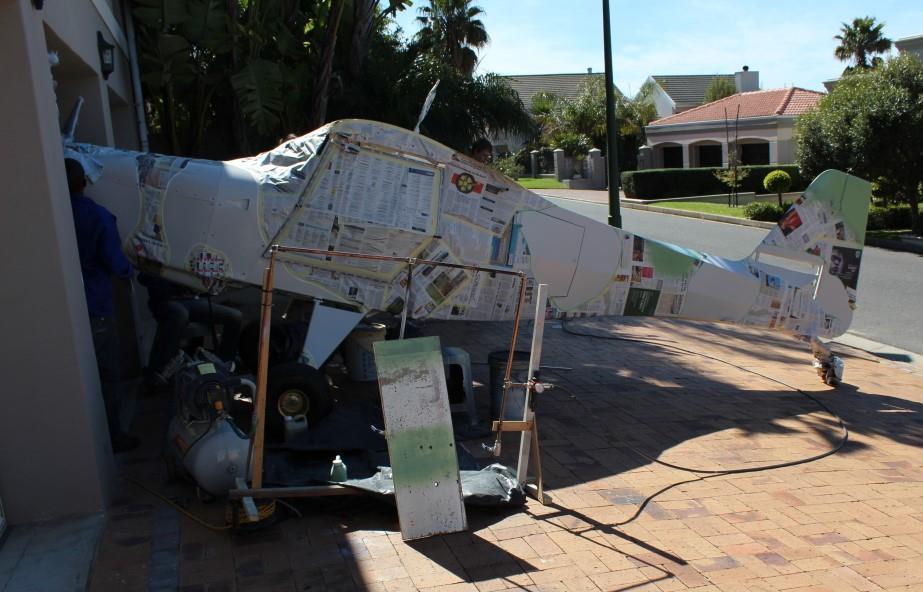

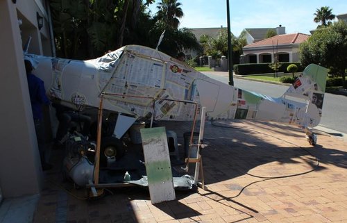

Prep Fuselage for camo
Fuselage done

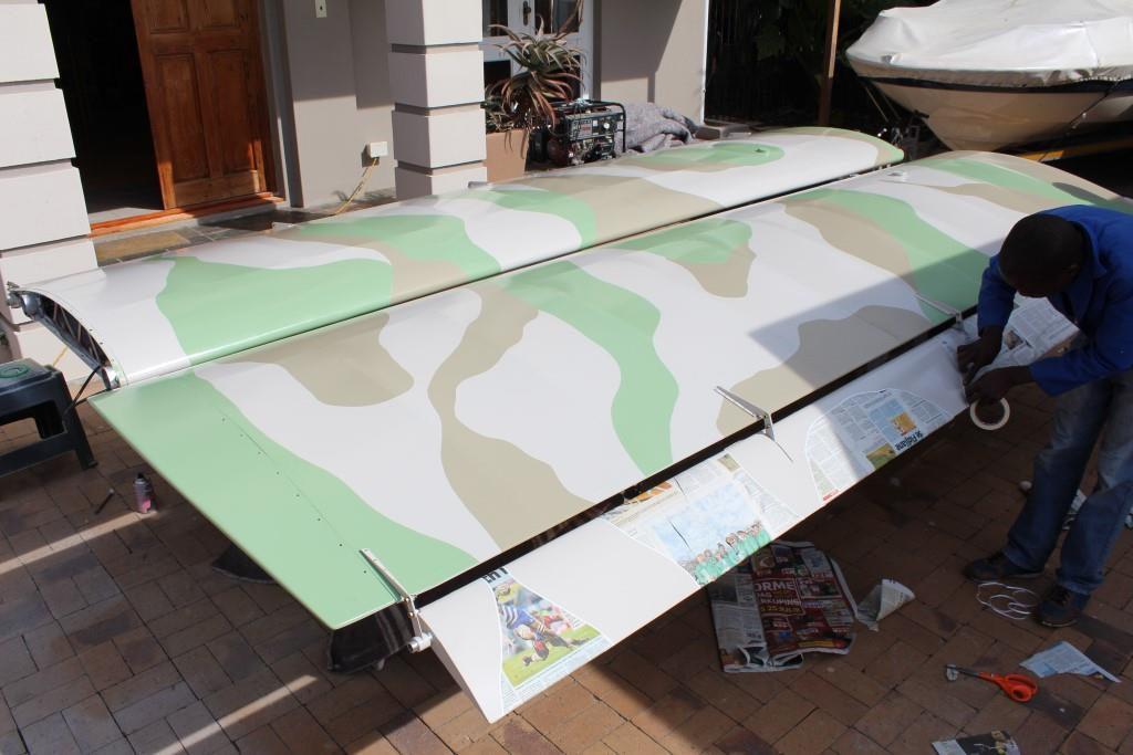

Wings done - now for flapperons
Now only those damm doors to finsh

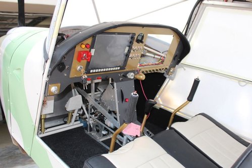

Spesiaal vir Boet Loubser - net die basics in die cockpit.....

Jaaaaa, NET die basics. :roll: Waar is die oorlog?? :lol: Panel sit darem nou op n beter angle!

Postby KFA » Fri Sep 18, 2015 6:50 pm
ZU-IGY
I like the colour scheme Gerard. (^^)
