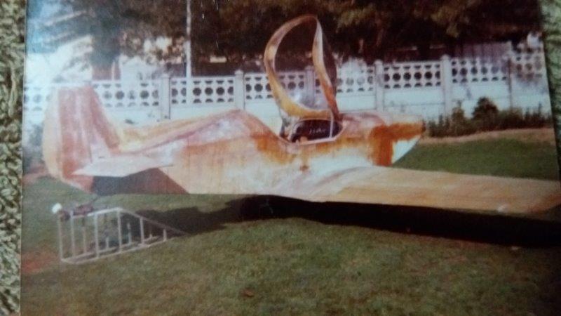

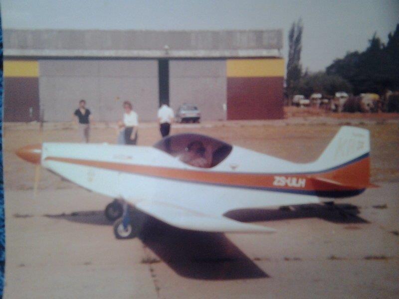

Recently I've found pictures of my 1st KR2 project that I completed in the mid 1980s. Also of the KR1 that I partially rebuilt a few years later. Will take photos of those pics & post here soon. Shame, I also found some of the much older pics of Sakkie Hallgreen & ZS-UKU. I feel so sorry for him. Building his KR2 & house at the same time with so much dreams for the future. He was so super conservative and yet someone else' stupidity cost him his life - putting lead in your spinner to compensate for a too far aft CG. The KR2 does not like spins - to enter into a spin in a too far aft cg configuration in a KR2 is going to cost you your life, that's for sure! All Sakkie did was test fly someone else's finished project. To this day I wonder if he knew about the lead in the prop spinner which cost him & the builder their lives.

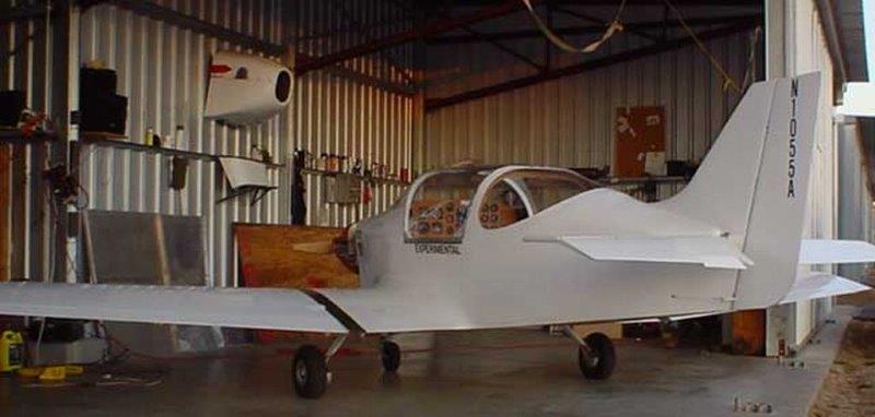

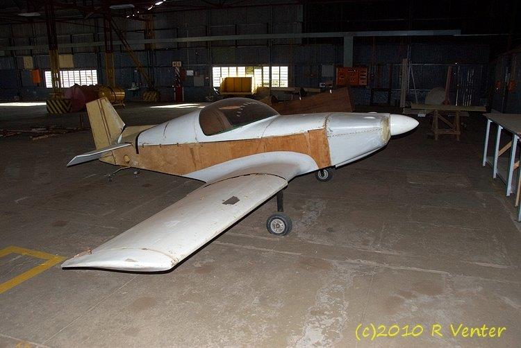

Re: Rotax 583 powered KR2

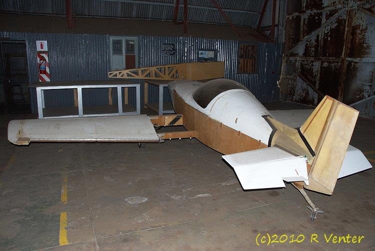

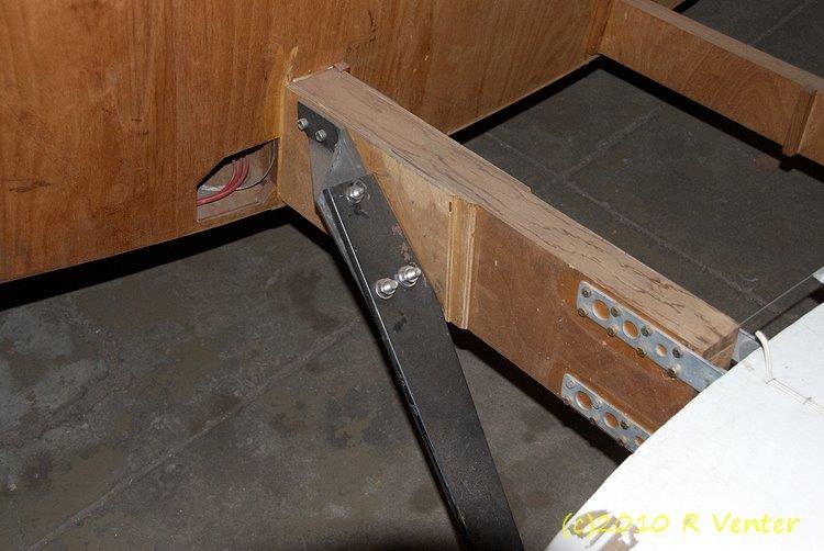

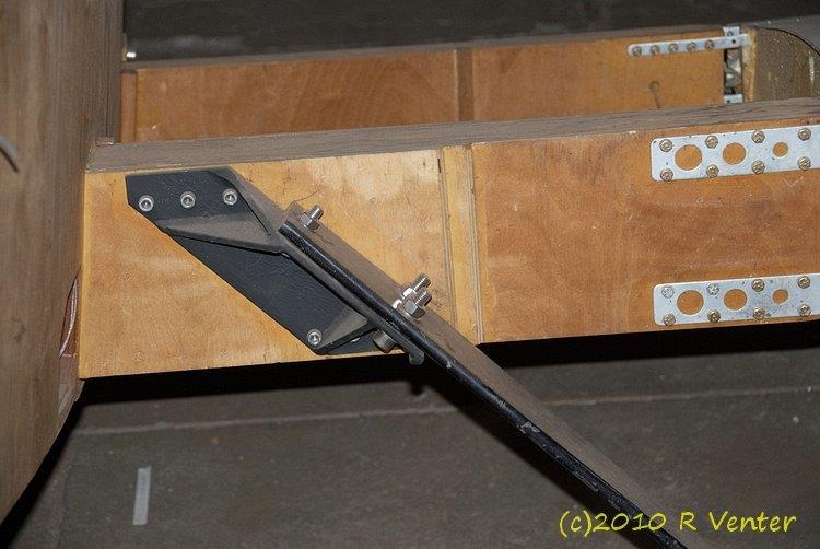

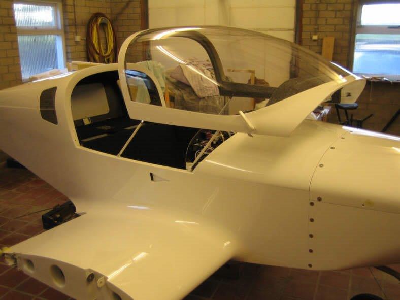

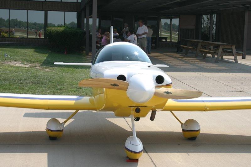

Thank you Rudix for agreeing to sell your project to me.
The following pics show this project as is and the only modifications I plan to add to it (described in photo captions)
Henni
Henni

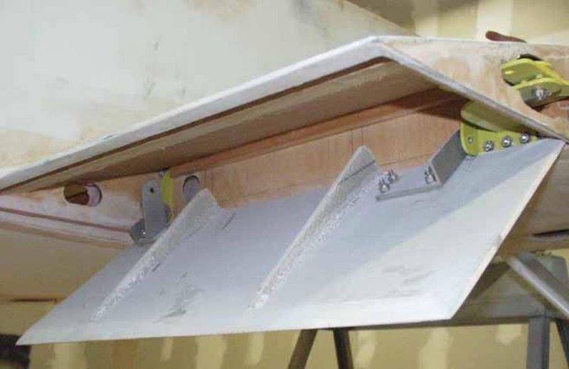

Hi Hans,

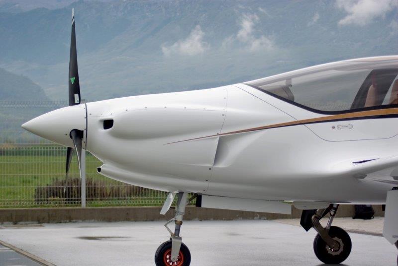

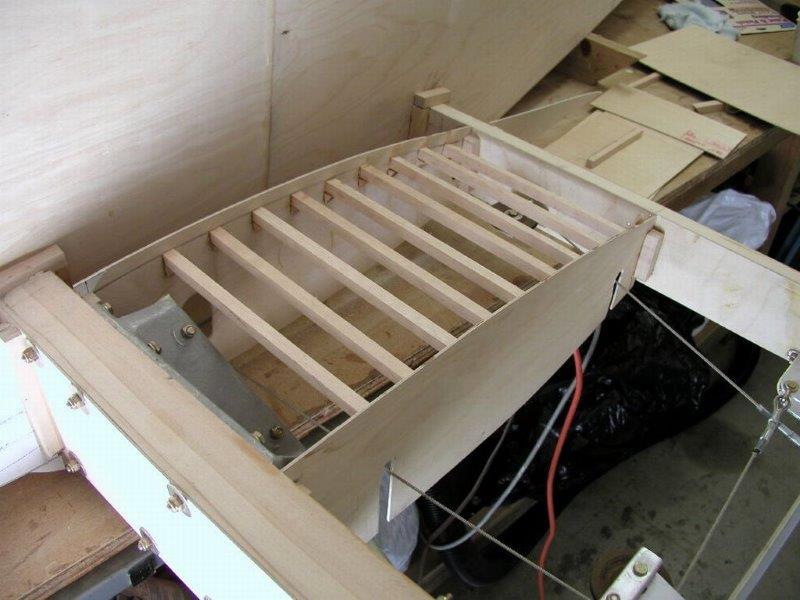

1. KR2 het beperkte dwars wind hantering vanwee die sterwiel. Dis hoekom so baie nuwe bouers vir die neuswiel opsie gaan. Ek het baie KR2 videos. In een staan die loods amper regop in die sitplek met die canopy oop om te sien waar hy taxi. Verskil in neuswiel en stertwiel gewig nie baie groot nie. Skuif hoof wiele slegs na agterkant van main spar - gebruik selfs dieselfde gate. Links voor gaan na regs agter en anders om. Neuswiel is castering, so nie baie werk nodig nie.
2. KR2 kom baie, baie vlak in vir landings. Plus die sig oor die neus is baie swak op finals. Die split flaps is maklik om te maak, weeg min en help vir altwee hierdie simptome. Weeg feitlik niks.

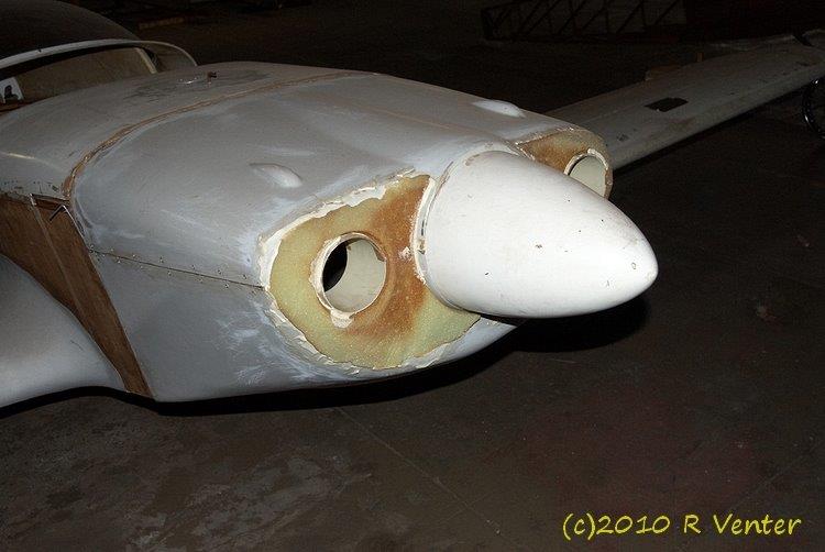

3. Vir die cowl inlets - sien huidige cowl foto waar die vorige bouer reeds hiermee begin het. Ek hoef dit net af te rond. Geen gewig impak hoegenaamd.
4. 'n Sy cowl outlet is baie meer effektief. Die lae druk bokant die vlerk suig letterlik die lugvloei uit die cowl uit. Geen gewig impak hoegenaamd.
5. Die 6 silinder Jabiru weeg minder as die turbo Volla, maar lewer 120 perde. (Dit hang van my finansies af - huidiglik net 'n droom) Ek dink 'n 2e handse enjin vanaf 'n Bantam sal nie veel meer kos as opgeboude 'n turbo Volla nie.
6. Agter venster gemaak van dun mylar - weeg baie min maar gee baie beter gevoel van ruimte plus baie beter sig na agter.
7. Wingfold - hierdie is rerig 'n baie eenvoudige konsep met verbysterende resultate. Dun aluminium pyp en nylon bushes wat rerig nie baie weeg nie.
8. Ek oorweeg nog die canopy oopmaak metode.
9. Wingwalk - die standard KR2 verg 'n geoefende kuns om in en uit te klim deur direk boop die main spar te trap. Goed vir die eienaar bouer - nie noodwendig vir alle passasiers nie.

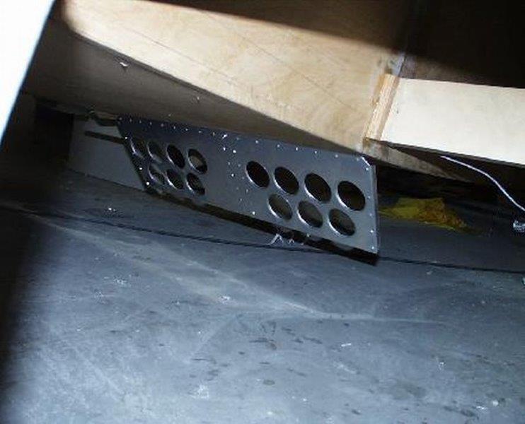

10. Belly airbrake - nie rerig nodig met split flaps nie (ek skat albei werk ewe goed) My 1ste KR2 het 'n belly airbrake gehad, sonder die gate. Die effek daarvan op die grond op 80mph is werklik stunning. Lees my verhaal erens op hierdie thread. Ek gaan eersdaags fotos van daardie projek hier pos - moet eers fotos van fotos neem en werk tans lang ure.
11. Ronde rudder - lyk heel anders - verg amper geen modifikasie. Sien hoe ek dit voorheen gedoen het. Wat jy agter aan die rudder sien is slegs dun ply wat met 'n lagie veselglas aan die huidige rudder geplak is.
11 Ek gaan die standaard canvas slingseat gebruik soos per die planne - hierdie weeg letterliks niks nie. Die sitplek ingeboude "kussings" le slegs bo-op dit. Sy sywaartse seksies word op dun, dun ply gevoeg wat net oor die stringers aan die kant van die romp le. Lyk uiters luuks, weeg so te se niks nie.
Wel, daar het jy dit. Ons almal droom, myne is van 'n spesiale KR2. As dit nie uiters lig kan wees nie, dan uiters vining. Al die idees hierbo genoem vlieg reeds op KR2s regoor die wereld. Ek voeg net die bestes saam, did al.
Vriendelike groete,
Henni

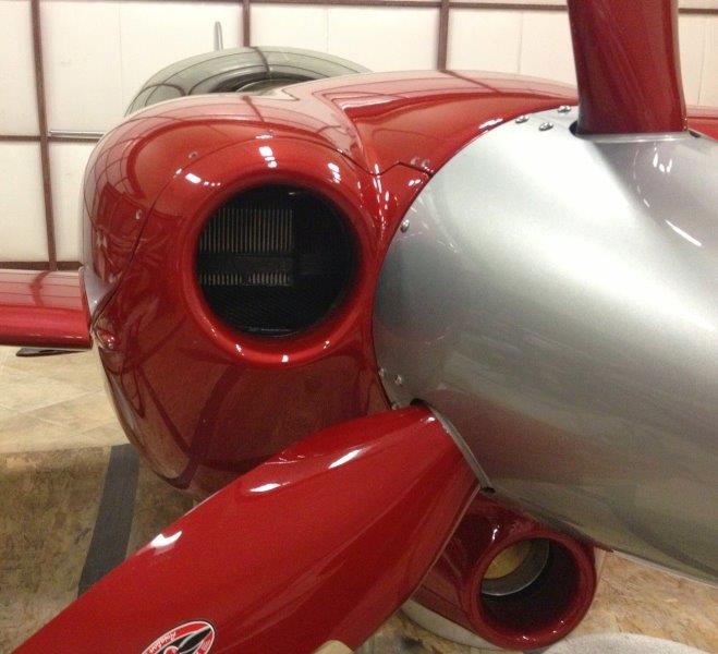

From a KR2 newsletter:
If you were going to improve the performance of your aircraft,
what single i tem would give the best results for the least amount
of work? I mean a real improvement as much as a 20% decrease in
parasite drag , I'll give you a hint, one of the greatest sources
of parasite drag is the cooling system of an air-cooled engine ,
You EAA guys know by now what I'm talking about • • • a cowl flap. This
is the easiest, most effective, single thing you can do to increase the
performance of your aircraft.

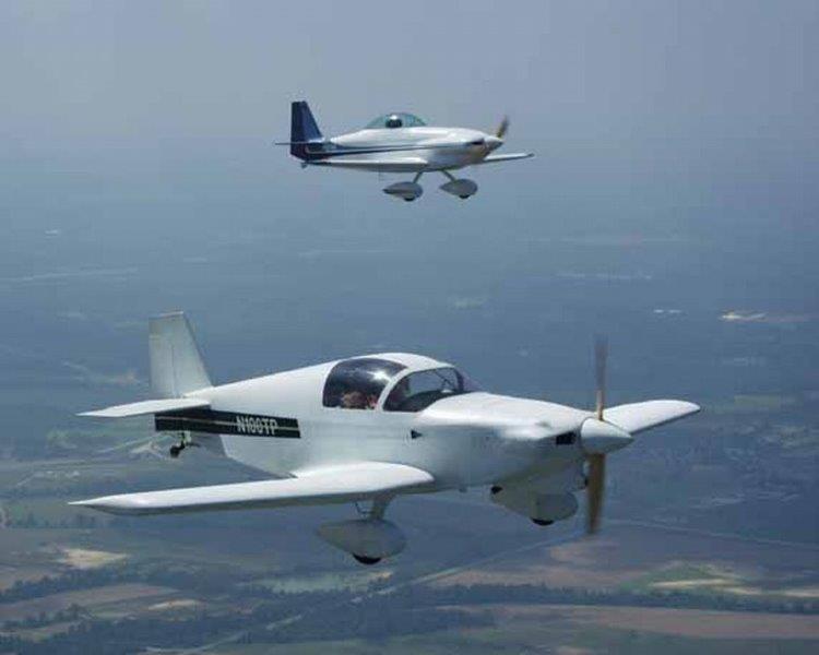

Hi all,
This KR1 & KR2 each have a confirmed level flight top speed of 230mph. The KR2 has normal length wings & uses a 120hp Continental engine.
Cheers,
Hennie
Cheers,
Hennie

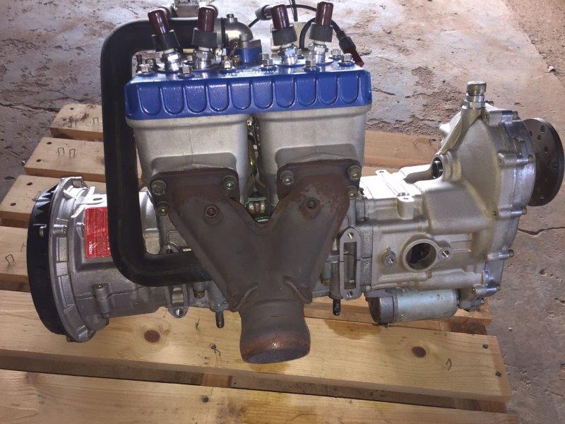

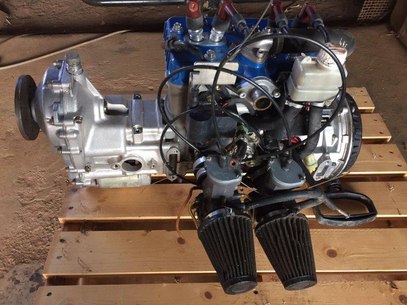

Hi all,

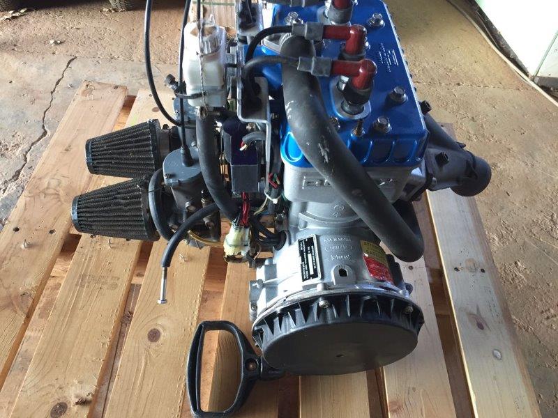

Secured her engine. It will come home with her on 29th July 2017. It is everything that I've wanted & much more reliable than the Rotax 583 originally considered. This will be one very light, very roomy KR2. And performance should not be too bad either. She will take off & land like a microlight, that's for sure! a Very long runway would not be required at all, I'll make absolutely sure of that.
I purchased two new gazebos that will be used to house her outside & also where construction would commence. I think I am now mostly set up and progress photos should once again follow shortly. This KR2 will be unique at least in South Africa.
