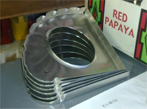

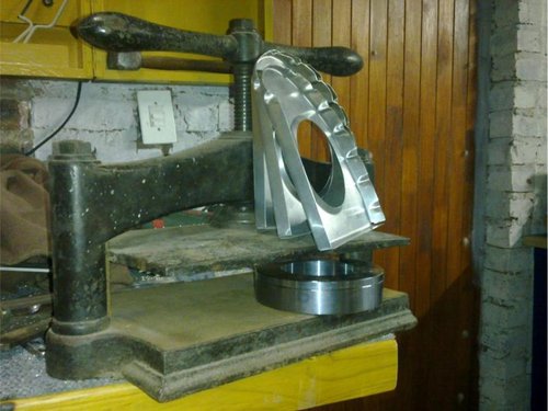

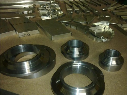

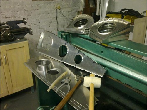

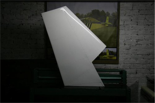

Hello all, as long as I can remember I have wanted to take to the skies in an aircraft that I have self built. I finally ordered my plans for the Zenith ch-750, which arrived mid January. Sourcing materials has been a bit of a pain, and so far I have been unable to find a suitable supplier of 6061-T6 angles. I started by making formers, dies and special tools required for the construction. I placed a small order on sheets to get going, and have cut out and formed most of my ribs already. My first part I assembled and riveted was the rudder, for which I had most of the materials. As I write this, can turn around and see my first completed part in paint. I think I need to build some more, before I find myself running around the house with the rudder in hand making aeroplane sounds
Here are a few pics of my progress.

Hello crosswind,Thank you, I will be building a Savannah S kit in a month or so when it arrives, so my 750 project may be on backburner for a few months. The only reason I painted the rudder section, was because I wanted to see something completed. I also read on another forum, where a builder said he preferred to paint the parts bit by bit then the spray job wouldnt be so big at the end of the build. The rest I will do in primer, and then final paint when assembled.cross_wind wrote:Nice!!! I can appreciate what a project you are undertaking as building a kit 750 is a lot of work. I guess the advantage you have is if you make a mistake, you can manufacture a new part.I have to order one from Zenith.
How long do you estimate it will take you (as opposed to my 650 hour estimate). I also see that you have opted to paint individual parts before final assembly - any particular reason for this? I am considering both options, but haven't made up my mind yet.

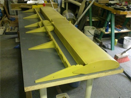

Completed the horizontal stabilizer skeleton today. It's a good feeling to see the larger parts come together. The more I build, the more I like the design of the 750. I dont know why I wasn't doing this years ago

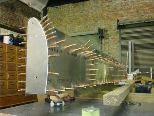

The skinning of the horizontal stab had me finding words I hadnt used in years. I learned a lot for the effort tho.

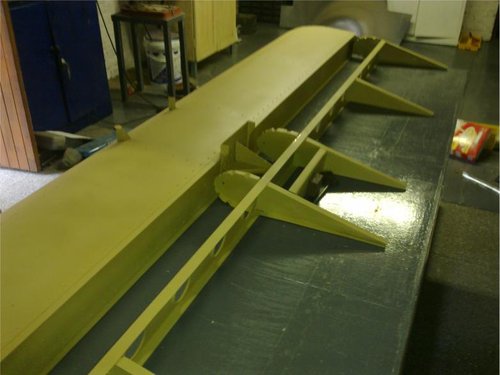

The horizontal stab and elevator took a while to decipher from the drawings. I had to refer to the ch-701 assembly guide to make sense of them. The h/stab showed me that the skeleton has to be absolutely square before skinning, with the nose ribs all protruding the same distance from the spar. On my first attempt the tip ribs were a few mills shorter than the middle three. I pulled up the straps and realised I was wasting my time expecting the gaps to close. The solution was to remake form blocks and the two outside ribs. This time I only cleco'd the outside ribs when I had the whole assembly standing on the leading edge, with all nose ribs on the same plane. I would have skinned the elevator already, but unfortunately ran out of material. I guess its a good time to take stock of what I have already cut out and what still is required.
