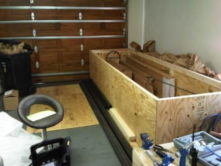

After thinking about building my own aircraft for the past 5 years, I have finally taken the plunge and decided on a Zenith CH 750. I purchased the kit from Phil @ Bundu Aviation and started construction on the 08 Feb 2011. I have taken photos using my Blackberry, so the quality isn't the best (since all my building is done at night).
Spent Saturday night unpacking the crate and trying to dispose of mountains of wrapping paper
06 Feb 2011.jpg (28.38 KiB) Viewed 26677 times

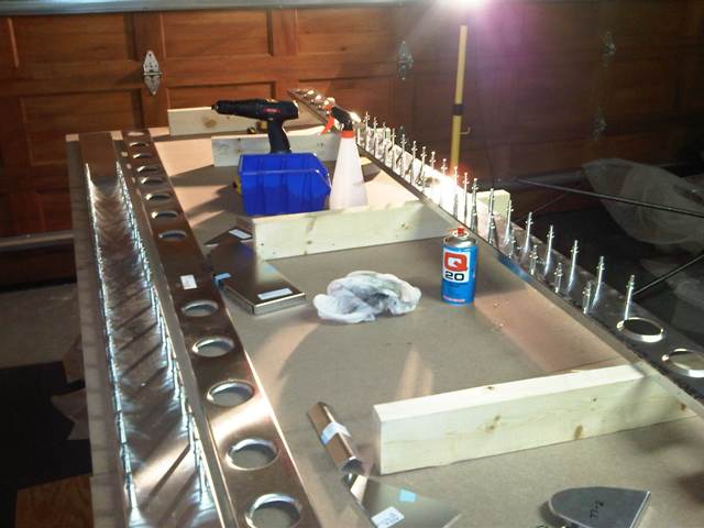

cross_wind
Posts: 225
Re: Conrads CH 750 Project

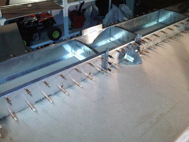

Postby cross_wind » Wed Feb 16, 2011 12:01 pm
Stabilizer cleco'd together.

cross_wind
Posts: 225

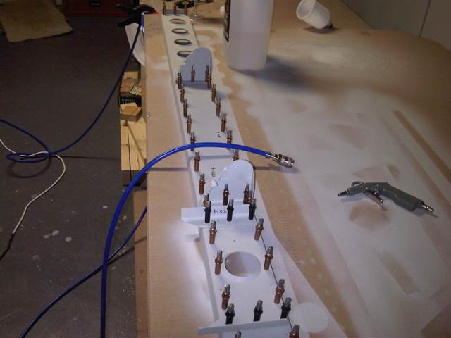

Postby cross_wind » Wed Feb 16, 2011 12:04 pm
Strip cleco's, debur, scour, clean, degrease, prime, re-cleco - yup all that. :? :?

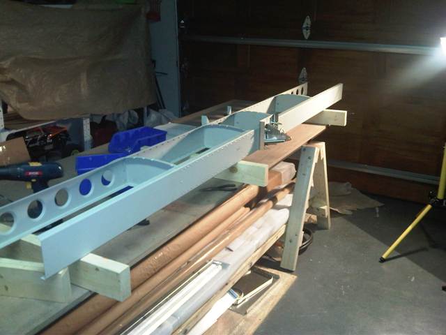

Postby cross_wind » Wed Feb 16, 2011 12:06 pm
Stabilizer skeleton finished.

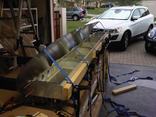

cross_wind
Posts: 225
Postby cross_wind » Wed Feb 16, 2011 12:09 pm
Starting to strap on the skin.

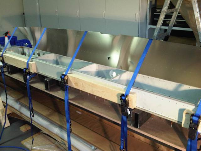

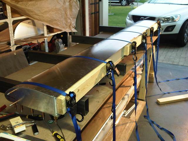

cross_wind
Posts: 225
Postby cross_wind » Wed Feb 16, 2011 12:10 pm
Strapping.

cross_wind
Posts: 225
Postby cross_wind » Wed Feb 16, 2011 12:12 pm
Finished strapping, now to cleco, drill to final size, re-cleco, strip and prime.

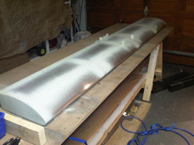

cross_wind
Posts: 225
Postby cross_wind » Wed Feb 16, 2011 12:14 pm
Ta da - stabilizer finished. I will start hunting for all the elevator bits tonight... (^^) (^^) (^^) (^^) (^^) (^^)
