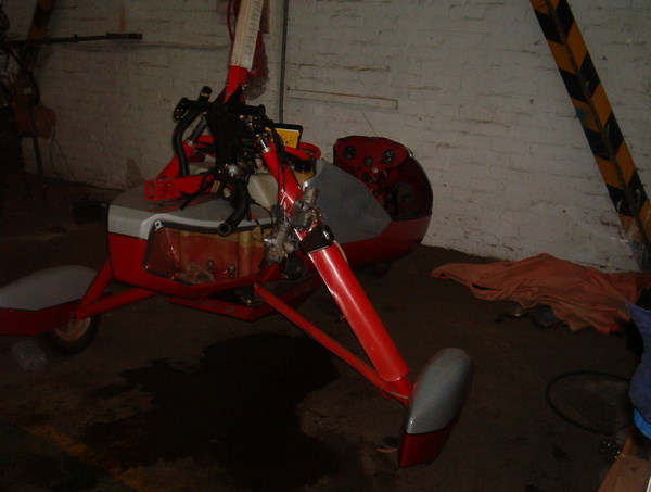

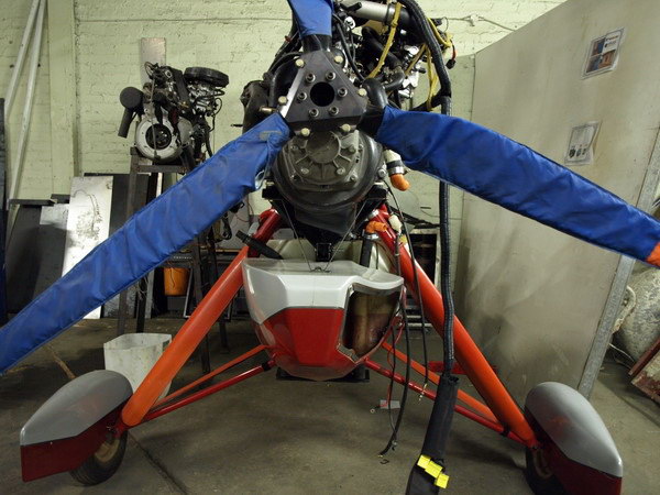

Before pics with 582 and Big D ;)
Off to workshop for upgrade!!

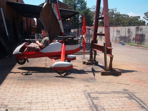

COG Test for before and after comparison
Stripped trike, 58Kg lighter without 582 (Radiator still on)
Engine mount test, with 10g load

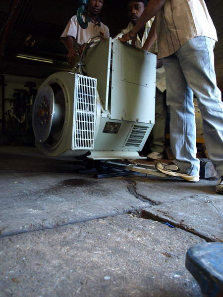

AFTER Workshop testing of 5 engines, see another engine in background...busy fitting victor

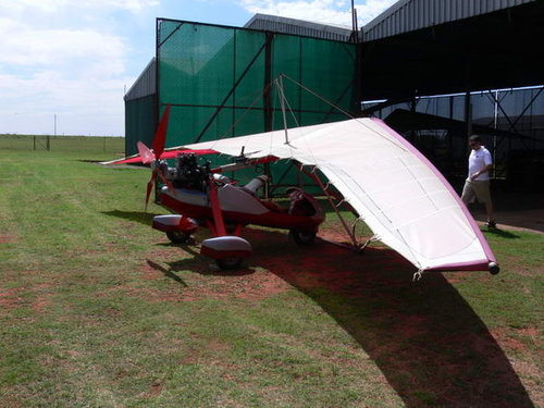

Avg weather conditions chosen for testruns, nice and quiet ;)

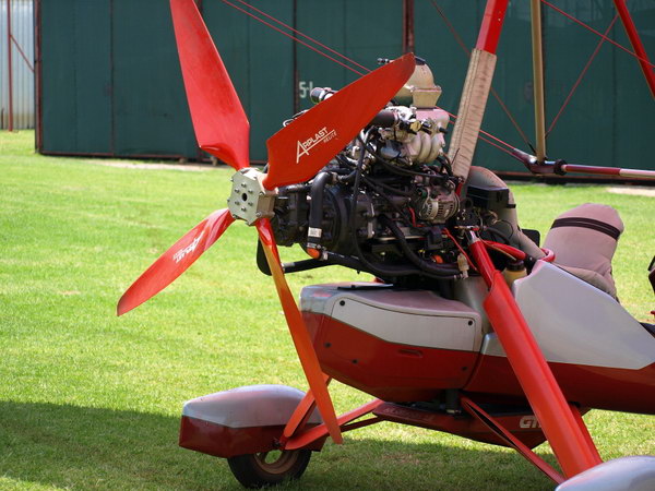

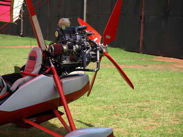

After install V1 mod
Must find V2 and V3 mod pics later...these are 2yrs+ :oops:

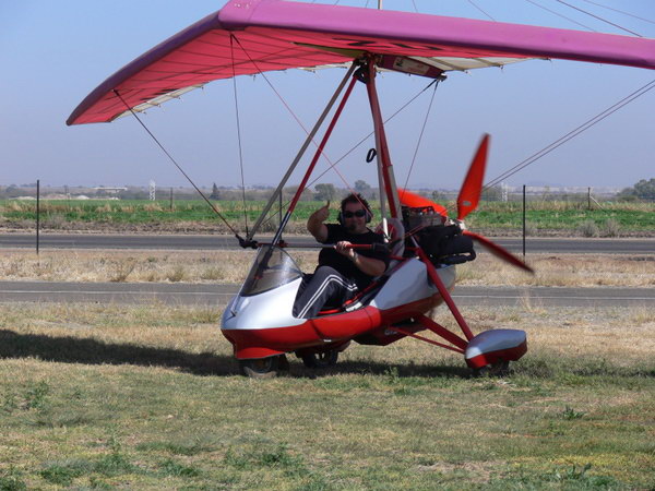

Test runs on V3 start tomorrow or bit later today

Looks very nice but give us a bit more detail on the engine and gearbox .
Looks like a smartcar engine

To me it looks like a 3Cyl. Suzuki.
Did You have to add any extra weight to the front to keep that front wheel so low ?

It's a 2.5 Gearbox Ratio with a Suzuki G10 Turbo. I have a Smart Car engine infact it was one I tested in the workshop, it was cheaper but I had a few issues.
Here's a link, sorry for my editing skills first time.
http://www.youtube.com/watch?v=EeqXgqyiZKA
Jaco, I didn't need to add weight, however I did move as many things as I could from the onset, forward. On my trike the Radiator and battery already sit forward. I was initially concerned about frontal weight as I removed all the analog instruments and replaced it with a MGL unit.
The installed weight is around 5kg LESS than a 912.
Apart from my "elementary" vibration test above the rest were pretty much stat driven. Around 20 hours of ground runs. 10 of Crow hops.
Seems you guys doing the Yaris stuff got it easy (!!) , CAA wanted me to do a drop test. (**)

One small surgestion : About the open pulleys on the front of the engine :!:
A Couple of years ago a girl's hair got cought on a Gokart's axle which killed her instantly by breaking her neck.
A Scarf or any loose clothing :shock:
We closed all moving parts in the front of the motor with a thin aluminium cover.
Cheers.
DieselFan
Posts: 1080
Re: DieselFan / Tobies' Experiments
Postby DieselFan » Fri Mar 26, 2010 10:57 pm
I heard about a hair story, not sure if the same. I had an allu cover on till recently. Shot for the comments :!:
I have got a clip of a circuit too when i was doing initial flight tests. Shortest take off avg both directions on run way was 53m to clear 15ft, acc to mgl unit.
