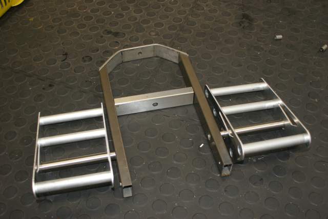

Since my last post I got most of my stainless steel and I have started on the fork. All the metal has now been cut and drilled for the fork and it must now be welded. Here is a photo of all the pieces.

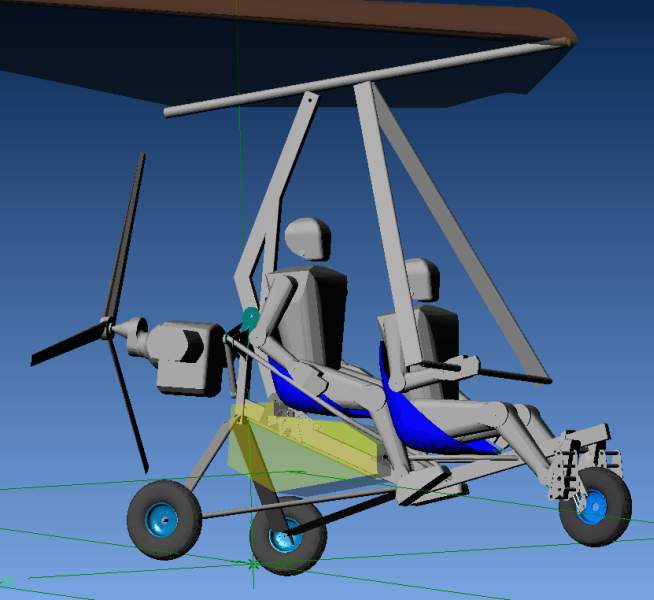

I have also worked on the CAD drawing. I have added some detail and added some of the major components. An engine (a genuine box engine) and a wing was added just to get a better idea of what it is going to look like. Currently the engine and wing are attached to the frame with "sky hooks". I will add details of both "sky hooks" in future since I will have to make these parts. I am working on a new hang point actuator design that will be a bit different from existing ones and I hope will be easier to make with just some basic tools and easier to operate. As soon as I have all the niggles sorted out I will put it on the forum for comment.
One thing that I have not mentioned before is that I have made the trike about 150mm longer than a 'normal' trike. The reason for that is mainly to make more legroom for the passenger. I do not take a lot of passengers but normally they complain that it is a bit tight at the back so I thought that it is a good idea to make it a bit longer. Here is an image of the latest model.
Trike with wing and engine

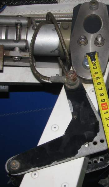

Good question. It can actually go forward all the way. On the DTA they have a bracket at the top of the pylon that stops it. Below is a photo of one (black bracket that looks like a boomerang) This one is in the down position to remove the wing. The stop needs a bolt through one of the three holes to act as a stop. The position where it stops is determined by which hole you use.
I have seen at least one DTA flown without the stop so I do not think it is really necessary for the stop but it does make you feel safer.
You might also want to know how you tie it down without the front strut: the bar is normally tied to the seat.

Aaaaah ok!
I thought it might be something like that. What if the bar is snatched out of your grasp during turbulence?
