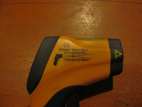

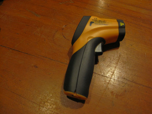

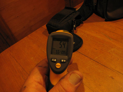

Those infra red thermometers are very handy - I use them at work. Just a cautionary note - The reading depends on the emissivity of the surface (dull, black surfaces will read hotter than metallic silver surfaces even if they are at the same temperature). But it sure beats touching something to check if it's hot!

That slight difference is of no importance to me. It sure beats having to take a probe out and put it in boiling water and then adjust the 100 degrees with altitude where you are to calibrate the probe . Now you are in the ballpark immediately. On the four strokes we tune EGT. If you tune Lambda you are at maximum EGT and on full power you are going to run in to trouble. In cruis and at reduced power you can go maximum EGT or even on the lean side of peak and use Lambda, I'm not greatly in favour of this because then the exhaust flame is an oxidising flame. On the rich side of peak it is a reducing flame much less aggressive. The GAMI injector people run on the lean side of peak. The big radials on the DC$'s and sixes and the Constelations ran lean of peak. For our microlights we are not flying trans oceanic and that little bit of fuel I will gladly pay for not having a hole in a piston. The two strokes have different rules.

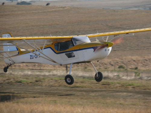

While we wait, maybe a trip down memory lane for Oupa G...
I traded this beauty in on the RV6 and saw Oupa G as first reg SA owner in logs
Thanks George that was a lekker aerie. The silence will be broken I flew the Bosvark on Sunday after the wind subsided. There was a long Saga and in case the loyal site hitters have wondered what happened , here is the story. As I said before I will do honest reporting here it follows. Before X-mas I was on my way testing the fuel consumption when just airborne the engine lost power I switch to all the systems switched the fuel pumps on , no power so I elected to do a forced landing. Luckily no scratch on the Bosvark and I trailered it home to the hangar. I pulled the engine and opened her up and found that somebody had worked on one cylinder and had never tightened the camshaft pulley. Needles to say this destroyed the engine valves and everything moving on the one side of the engine I looked at the engine and have decided to scrap this engine. I had the engine that I changed from a RT to a GS1200. My brain went into mechanic mode and in no time I changed the engines not thinking a serious case of tunnel vision. Objective change engine do not think. The engine was swapped and ground run all temp OK luckily the wind was not nice for flying so I opted for some ground running on the apron lifting the tail. Initially I had good power and then suddenly I lost control over the tail and had a prop strike. After the prop strike I had a low compression on one cylinder. Holidays came and went and coming back from vacation I did the compression check , one cylinder low. That was like 5 minutes running time. I lost control because I had lost airflow over the tail. I stripped the engine and it had ingested metal from the aircleaner I had never inspected. The first engine had blown back so much metal and pieces of valve stem that were all stuck between the butterfly and aircleaner. I went into thinking mode and replaced the engine cleaned out everything replaced the air-filters checked everything also checked all critical torque values, fitted the engine as first test ran it and flew the first flight on Sunday. All temps are superb and the fuel consumption test will continue. Then the net went down, but I'm back on line. To crown everything today somebody lost control over their Hi-Lux bakkie and drove through the workshop wall into the workshop. My whole workshop is a total shambles. However the test program stands at 20 hours and continuing.
