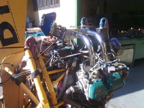

Did some tuning on the A's 912 and got some great results. The egt's are now within 10 degrees at 4200rpm's. Wing is on and ready to go..

As you can see the 912S with fuel injection , The ECI of course is an Eboxi it is amazing how unequal the EGT's run with the original manifold and if you change the induction pipes to equal lengths the EGT's also become equal. Interesting things coming up in 2010
