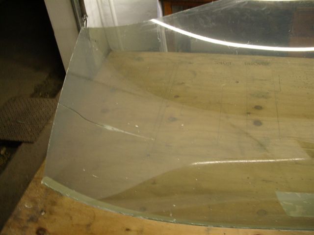

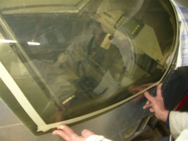

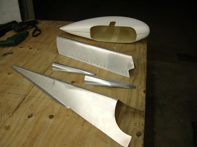

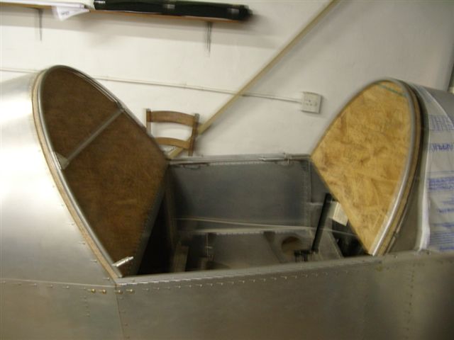

Ok, so I broke my canopy!!
Fortunately the factory automatically send two, knowing that most people will break one. So, now building a wodden framework, to hold the canopy. This thing is EXTREMELY brittle, and cracks / breaks for absolutely nothing!!
Also busy with fairings, wheel spats etc.
Pics below
L
Pics below
L
