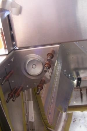

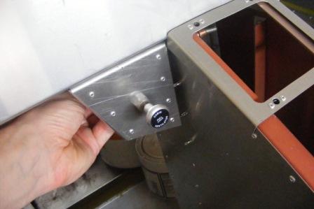

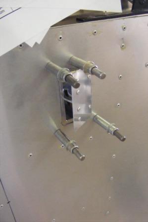

I saw an aluminum scoop vent from an RV 10 kit that I wanted to add to the Zodiac 650 as I don't want to mess around with the fragile canopy installing a scoop there. The scoop might be overkill but with a canopy the size of the 650 it is likely to be very hot under there. I have fabricated a location for the cabin air bowden cable control which will push/pull the scoop's lever open and closed. Unfortunately due to the construction of the scoop there might be a tiny gap but I have ordered a couple of springs to hold the scoop door shut in tension but they might not be needed if the bowden cable does the job on its own.

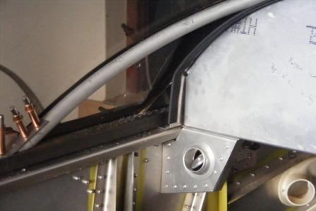

Fabricated and installed a matching (mirror) location for the eyeball vent purchased from Spruce at a R1000 a piece it is sh*t expensive but a well made piece of kit. The intention is that the scoop provides cabin air to the torso of the occupant and the eyeball vent provides air the face.

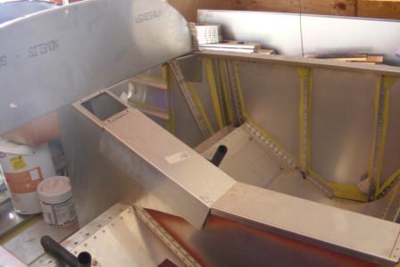

The last photograph is one of the set up of the throttle quadrant. The vast majority of Zodiacs utilise a vernier throttle which I am not particularly keen on so I have ordered and received the lever style throttle with mixture control. This means that I have had to fabricate a centre console to support the throttle quadrant. The last photo is a progress to date photo and was made using cardboard templates which when cut accurately were transferred onto the aluminium.
RV 10 Scoop Vent
Bowden cabin air cable
Over priced aluminium eyeball vent from Spruce.
Custom throttle quadrant set up.

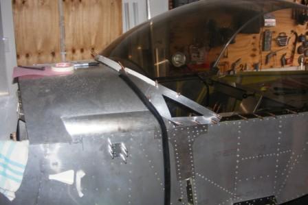

Spent the last few days attempting to install some form of custom flashing to pretty up the front of the canopy. The plans purely call for the front canopy hoop which is then visible through the canopy and doesn't really look great so I have been working on a fix to that. :roll:
I did not want to lose the visibility through the triangular gap between the canopy arm, instrument panel and canopy hoop so I have made a cut out in the flashing to keep this open. The interior photo gives you an idea of what I am talking about. The rubber trim on the exterior will run all the way across the front edge of the flashing (hence the gap) to ensure a tight seal.
There are a couple of cock ups on the flashing and I will remake the piece (mainly to remove both the join and cover the gap between the forward canopy arm cover and the flashing (d'oh). Think it looks good...any suggestions?
Exterior view of mock up.
