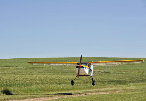

The fairest has not been the fairest the last few days I'm busy installing the new gear. But I have to drive to the hangar and the weather has been extremely wet. But as soon as the weather plays ball I will come up with the figures. All I can tell is the take-off is not a take-off before you have given a gentle full throttle she is already in the air feels about 100m or less. The pictures show less but I will report once I have measured it. What I can say is that it must be the easiest aircraft that I have flown controls very balanced and a wonderful rudder control. A very easy taildragger with no funny vices. The flaperon control is with the fingers and she was a hands free cruiser from the word go. With the 72X52 de Necker prop and pushing it a bit she runs 100mph, but then I'm at the top of my rpm limit.
I have now reinstalled the Arplast prop and on the first flight she over revved the prop was pitched the same as for a 912s I have increased the pitch with 3degrees but haven't flown it yet. Just a photo of the approach to land I'm still coming in a bit to fast. That will change in the near future after I have tested the stall speed.I see the visits have gone past the 64000 mark. I would never have dreamt that that is possible, thanks.

Still fast on the approach

Ek glo die maggic nommer is 60mph Oupa. Approach en climb. Die Vx behoort so 56-58 te wees en die Vy omtrent so 62-64. As jy alleen en lig is kan die approach afkom na 55

Dual my baby stalls at 49mph and solo 43mph. So using the X 1.3 rule I approach over the numbers at 65 dual and 56 solo. Be interesting to see how this baby performs. What does she weigh empty?
