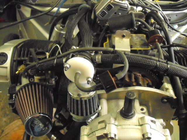

Nice work. Maybe you can use this. Installed the black/brown vacuum delay valve on the fuel pressure regulator and the MAP sensor, this sorts out the vacuum pulses at the short intakes and works fine for me. The tip of the injector is subjected to vacuum which will suck more fuel through it at idle than at WOT without a vacuum line on the regulator.

the pressure regulator gives 3.5 bar pressure in the common rail and the suction you are talking about you should tune with the software and the opening time on the injector that is the reason BMW uses the TPS for acceleration and not the manifold pressure. I have the one way valves in my system but I use it for my manifold pressure so that with a variable pitch prop you know what power settings you have thus RPM verses Man pressur=boost. When you are supercharging the engine the you can connect the the static side of the regulator to the turbo boost. Give me a tinkle and I can explain it better on the phone . We have no problems idling whatsoever.

Ystervark actually looked at the exact opening and closing time of the injector he built a special circuit to see this on the scope and calculates the injection timing from that. In theory you do not want to change the pressure there are the newer common rail system where the fuel pump pressure is regulated electronically but we are sticking to the KISS principle. At present our starting idling cold start, acceleration of the engine on sudden adding of power like a go round etc is sorted out as well as the altitude compensation. The three major factors are the prop, the exhaust system and the airframe. These factors influence the final tuning. Ystervark is busy doing the aerospace reliability testing which so far is going well. In the end the aim is safety.

In the photos of your built process it seems like you are not using a vacuum line on your fuel pressure regulator. All I wanted to point out was that I use the simple way by putting a vacuum line on the pressure regulator. As far as I understand it this is very important because if you subject your injector tip to different vacuum levels created by engine load, butterfly setting and other criteria it will have an affect on the amount of fuel sucked into the engine for the same opening time of the injectors if not corrected by some means. I am sure one can compensate for this with special lookup maps or calculations on a system, but in my opinion that is not simple for the DIY man.

I looked at your manifold compensation I am using the same little one way valves ,once you have sucked the lower pressure are you releasing otherwise when you have to accelerate suddenly there is still a low pressure on the diaphragm of the pressure regulator and you will then have low fuel pressure , Have you measured the in line fuel pressure alteration with this set-up it normally should be stable at 3.5 bar. It would be interesting to hear your results. The idling is not easy to do we have managed to let our engine idle happily at 1000rpm with instant throttle response that is what you want at a go-round situation.
