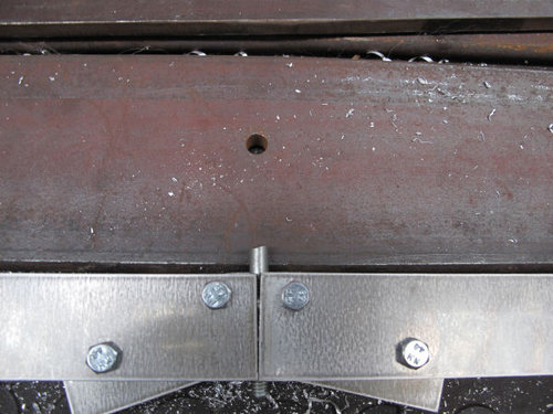

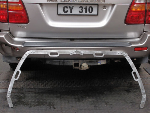

The template was finally assembled and the picture of the whole template shows the width of the gear and wheels is the width of my Cruiser that makes any "spoor" in the veld a possible spot to land at least in an emergency. I'm also showing the pin that centres the template on the steel section that will become the final gear-leg. So I'm ready to roll. Meanwhile waiting in anticipation. Had Colette come back to me regarding the test pilot application I downloaded the relevant forms and gave them the summary of my logbook but CAA wants another two forms filled in that are not on the website. So Van Zyl Aviation promptly got the forms and sent them to me . I'm trying to be such a good law abiding Citizen I pay all my taxes but the system is trying to get me down but I will not surrender.
Enjoy the pics
Cheers Oupa-G

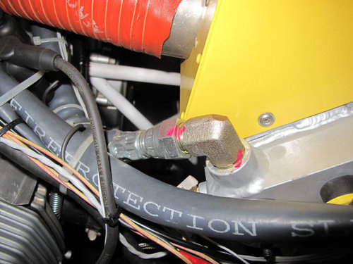

I had a call from Derek who has the Whisper with the BMW engine. They are at the taxiing stage and have a slight oil leak. I took some photo's of the connections of the Bosvark. I machined the fitting and cut a thread in the fitting and then used a banjo fitting. All pipes were properly crimped.
Cheers Oupa-G

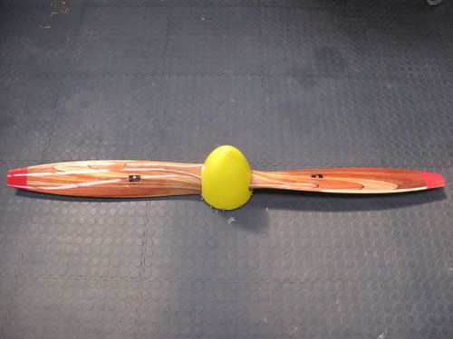

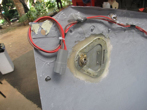

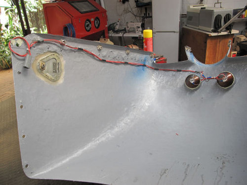

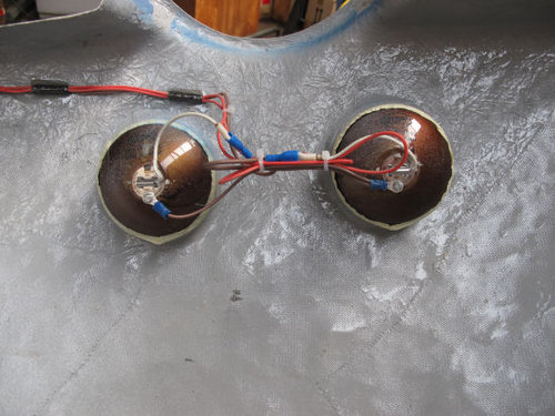

I'm waiting . Have had so much tragedy in my practice, and in perspective moaning about papers is like moaning with a loaf of bread under my arm. So the papers cannot stay away for ever the easiest is to just wait. Meanwhile the under carriage is being worked on and I have put some wires inside the cowl so that I can disconnect the recognition lights with one plug. The attach points are carbon fibre tubes stuck on with epoxi, I use the same method for the brake pipes on the spring steel gear, there are some photo's some where else on this site.Was given a 72X52 de Necker prop with yellow spinner by Paul van As. So the test flying will be interesting. Applied for my test pilot rating got all the forms of the net filled them in but was then told there are another two forms to be filled in which are not on the net,so another SpeedServices envelope to Van Zyl Aviation and so we plod on. Microlight meeting tonight Mike and James are there from Sling fame and RAASA and it is the AGM.
Enjoy the pics
Cheers Oupa-G

MYR
Posts: 127
Joined: Fri Aug 08, 2008 8:41 pm
Location: Reunion Island
Postby MYR » Wed Oct 21, 2009 5:12 pm
Where do you buy these little doors ?
I remember you said it is in Capetown.
What's the name of this shop ? Has it a website ?
