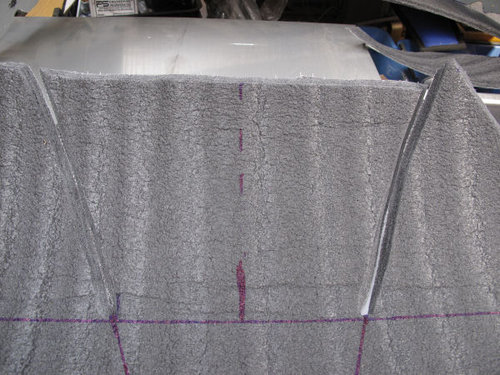

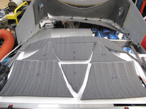

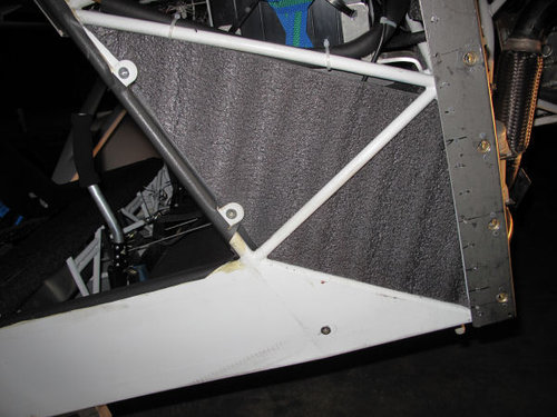

Transferred all the dimensions to the soundproofing material. Did the bevel cutting so that the bevel can wedge under the pipes of the frame.When all was cut and bevelled, the total weight of the material was 200gm . A weight that can almost be ignored I hope I get good soundproofing. Another source of noise is the floor under the floor boards, there I will make a double layer from the firewall to the gear-leg part that also runs under the fuselage that will also be more aerodynamic, this area is where the exhaust barks. Another source of noise is from the tail and I will see how I tackle that one.

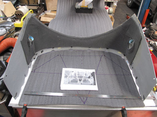

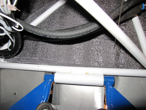

After a long days work took a 2hrs powernap and then went to the hangar and fitted most of the sound proofing. The weekend promises to be nice and I still have high hopes for a fax or something from CAA. The sound proofing will be finished tomorrow. Thebevel cut that slides and wedges behind the pipes of the frame works well it must just be cut accurately. I'm going to sleep now enjoy the pics.
Cheers Oupa-G
Sidepanel soundproofing
Left side above rudder pedals
Right side

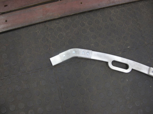

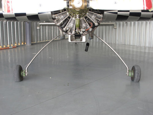

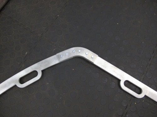

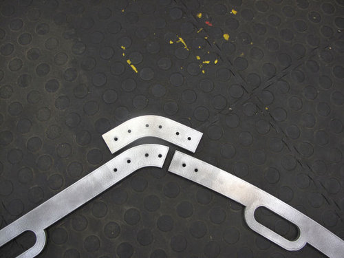

While the big wait is on I have tuned the Voyager and Vliegvark sat at his computer and designed the curvatures of the new gear. From the taxi trials we know that the gear is nice and springy without being to soft. Once you have the design in your head you also look at every possible gear around and the aircraft with the most beautiful spring gear must be the Yak 55 the Russians are masters at shaping the gear and it is also out of titanium. Titanium is out of bounds for us for us it is EN45. We decided that to get the correct curvatures the spring steel workers must have proper templates to work from. So Vliegvark's drawings were sent to the WaterJet company and out of 10mm aluminium plates the templates were cut. The area where the angles are have plates so that the angles can be changed if necessary. the handles are so that the template can be better handled. So the shape of the gear should be the way we want it and we can repeat the recipe . Enclosed some pics
Cheers Oupa-G
Yak inspiration

Postby Oupa-G » Wed Oct 14, 2009 4:29 pm
Checked the templates against the under carriage of the Bosvark and all the dimensions are OK. So the next step is of to my friendly spring maker. I'm taking time to do all these refinements. This coming weekend I'm putting a "trekskaal" behind the Bosvark and I will test all the static thrusts of the various propellers.
