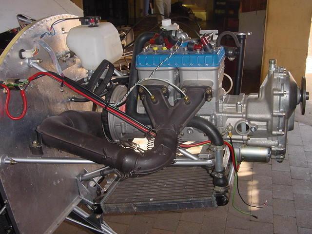

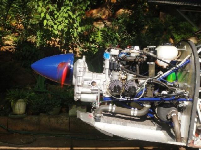

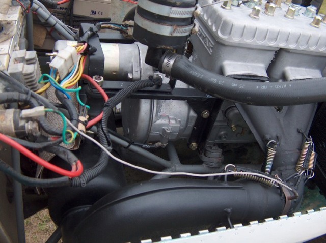

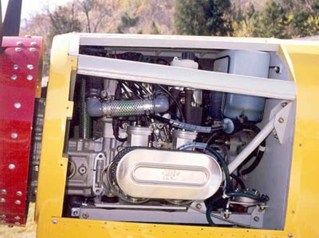

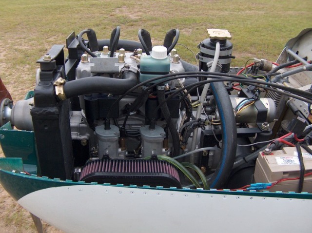

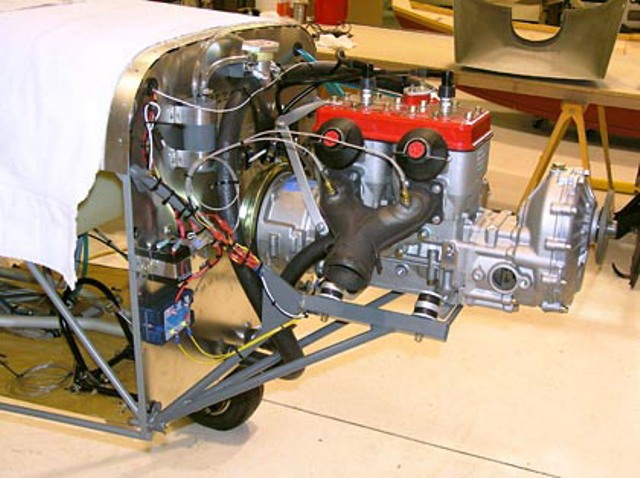

Re: Rotax 532 powered KR2

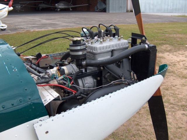

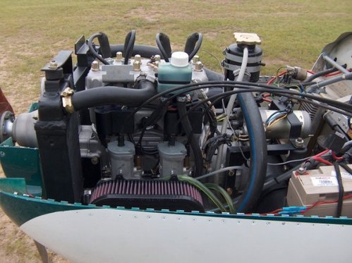

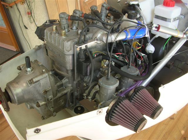

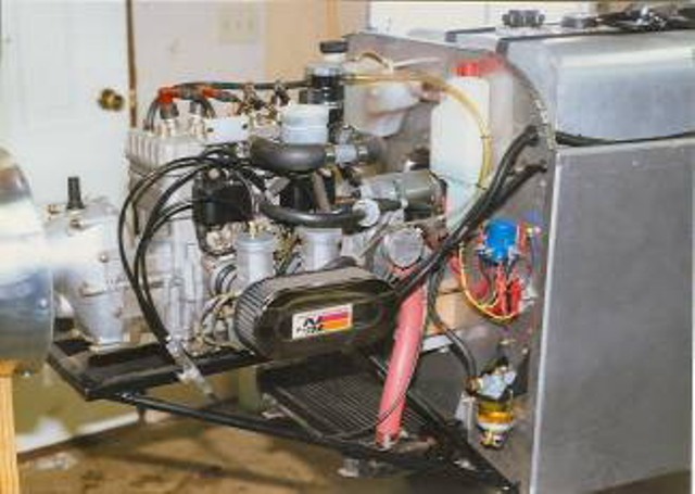

Hi all,
Just a few interesting installation pics I've found.
All the best,
Henni
All the best,
Henni
