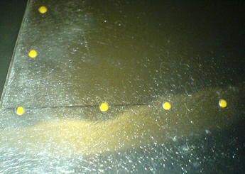

Been rather busy last week, and this weekend, but had the chance to do an experiment:
Apparently filling the holes in the rivets is worth a few mph in the cruise (and it looks a bit better). But it is a huge pain in the *rse to do.
To try and do this in an easy and effective way, I mixed up a brew of Zinc Chromate, thinners and micro balloons. Loaded it in a syringe with a nice big needle, and injected the slurry into the holes.
Seems to have worked quite nicely. 3cc did about 1/4 of one side of a wing, and only weighed just over 1g. Only took 5 minutes to do. It will probably be well worth the effort to do the whole plane.

Aaah, but now, would you be so kind and inform us mere uninformed mortal souls out here, what in the horses ar$@ is Zinc Cromate and micro balloons. Don't worry about the thinners though. But why do you mix that particular substances together and how does the initial mixture looks and feels? You've put it in with a siringe, so it must be a liquid. But does it harden later on and will it stays in the holes with temperature expansion?
Post some pics of the wings so that we can see how they differ from the original wings.

Zinc Chromate is a primer paint. Microballoons is a lightweight filler consisting of microscopic glass bubbles, used in the composite industry where low weight is important. Its looks like a white powder and is easy to sand and finish once the resin (or in this case paint) is set.
You can see Justin has a background in RC modelling since microballoons is often used for models. (As it is in Composite homebuilt aircraft)

Yup - the microballoons are a filler. They make the slurry weigh very little, and because they form the bulk of the mixture, it doesn't shrink much when drying.
The mixture also only weights about 3g for 10ml ;-) .
The only thing I am not sure of is using Zinc Chromate as an adhesive to bond the slurry. It does stick very well to aluminium, but how well does it stick to glass? Fortunately dimensions are tiny, and stresses are low, so even if the bond is not good, it won't really be an issue. Also completely non-structural, so even if it does crack/fall out, it is not a real problem. That is the only real reason I am willing to experiment with this...

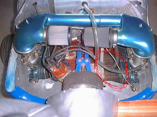

Boet wrote:The oldest VW powered BB still flying is ex Louis Chanu`s BB, CNL. I designed his baffling system as wwell. This engine had other faults, but it definately never overheated. It was used for some serious adventure flying. Here are some pics....
Hallo Oom Boet
In the photo of the VW engine the cooling fins look rusty. I have circled them in red. Is this normal?
Pieter
Re: Justin's Raven
Postby Boet » Mon Aug 03, 2009 6:05 pm
Skerp. BAIE skerp. If you look carefully, you will see that the engine block has been painted a rusty-red metallic colour. The "rust" you see, is overspray.
