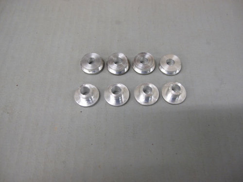

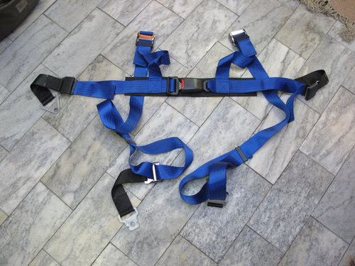

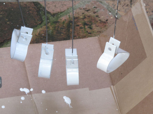

Friday afternoon I see the visits have passed the 45000 figure. Have been doing final touches. Made the bushes for the safety belts and also painted the clamps for the jury struts that Vliegvark made. and tomorrow off to the airfield. I also have to drain the oil on the Vansin I'm getting it ready for the trip to Bethlehem for the AP get together and the EAA weekend. Also I'm on call for the RedX so the weekend promises to be busy. I also bought a nice inclenometer to finally check the rigging of the Bosvarkie. Boet has rigged it and it looks spot-on with the eyeball technique but there is no harm in double checking. Sean Curran will then give it the final dual check on everything and then the CAA paperwork. When one has been building you can only admire the Sling effort by Mike and James and there Mammoth trip. It is wonderful that it can be done under the NTCA rules and this type of aviation has surpassed the store bought planes. Just give a responsible person freedom and look what happens. I think the response to this section has been so great because it is the deep down desire for knowledge. The exciting part of this site is going to start when we get the performance figures. I'm now waiting for the paint to dry.

Fitted the jury struts actually they were fitted by Vliegvark then the seatbelts are in and then we started serious tuning with the engine at operating temp. One nice thing to report is that with all the serious ground running we never had any temp problems what so ever the drop of temp from the hot side of the oil cooler to the exit oil temp is 30 degrees with the oil temp never going higher then 85 degrees C that is when the thermostat opens and the cyl head never went higher then 105 degreesC. Both the systems are now Ok and tuned so the serious taxi tests can now begin Paul van As came with his Explorer to visit and I had a quick flight in this docile aeroplane . She is a honey to fly and land. So the Bosvarkie should be the same.

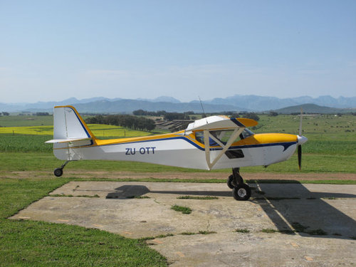

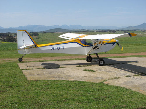

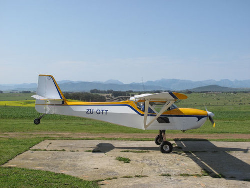

Rudix thanks for the encouragement I have been working hard and the high speed testing is going well. the wind however turned west our strip is quite narrow and I want to be super cautious. She feels very boyant I have been told that they could see free air below the wheels. I'm enclosing some pictures where I'm testing the tail lift capebilities. Except for the glare shield the aircraft is now officially finished. On monday all the paperwork is of to CAA. EXTENDED RUNNING ON THE GROUND HAS GOOD TEMP. Sorry for the caps locks. Enjoy the pics and Rudix I will look up my supplier for the exhaust parts.
