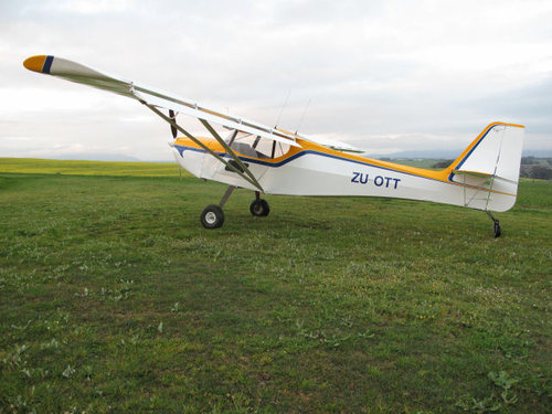

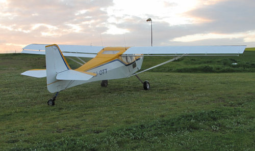

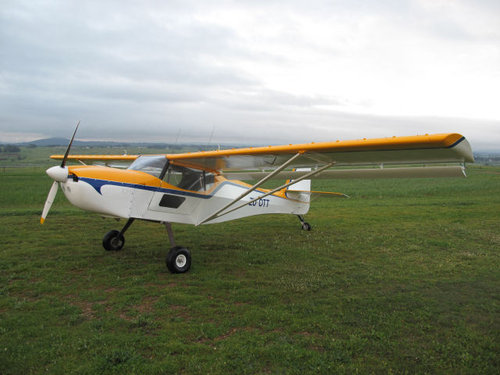

The long weekend could not have come at a better time. I worked really hard. I finished all the little things and as soon as you have finished one item another one turns up. The consolation is that everything you finish is done, from a building point of view I,m 99% finished. Late this afternoon when the wind dropped I had the photo session and did some taxiing. She feels very docile I managed to lift the tail and she is very stable and controlable. The brakes work well the Voyager is wonderful the magnemometer showed that our runway is 203 degrees which corresponds with our landing compass. My taxiing was ended by the end of the day and darkness set in and the new baby was put to bed. Tonight is paperwork night because now that I have the photo's my paperwork for CAA is completed. I'm going to show some photo's tonight so Iwill make some more posts.Enjoy the pics.

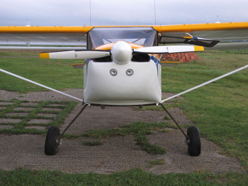

I see that we have had 44000 hits and now 47 pages The readers must not despair the interesting part is now coming reporting on the performance. To start of with the fuel in the wing tanks and no leaks we are now carrying enough weight to judge the gear. The present gear legs were overstressed on the little wagon and have taken an abnormal loading but they are doing well and give me assurance that the 12mm thickness is OK . The new gear will be cut the axle centre will come another 25mm further forward and the angles will be slightly different. Enjoy the pics

It looks like the Undercarriage is a bit sagged - the wheels are tilting a bit inwards -instead of vertical or slightly outwards - this will presumably be corrected with the new set?

Dear Andy Capp
I promised to give the honest information , the new gear will come on the site as soon as it is finished that is why this one is not painted. ALSO THE BENDS WILL BE LESS ACUTE. But what I know from this gear is that 12mm is sufficient thickness 10mm would be to pap and 14mm would be an over design.

Today I looked again at the photo's of the Bosvarkie and you must all agree now that everything is together that the cowling masterly shaped and made by Boet really makes the airoplane. Boet you are actually an artist at heart I salute you.

Can you talk a bit about the reasons for moving the axle forward?Oupa-G wrote:...The new gear will be cut the axle centre will come another 25mm further forward and the angles will be slightly different.
Dear Griffin
The Bushbaby spec's are the centre of the axle must be within 25 to 50mm behind the leading edge of the wing. At the moment the axle is 25mm behind the leading edge. At the moment I can pick up the tail holding the brakes and giving power. That is fine on reasonably smooth runways and makes for a very agile taildragger, which can be manouvered lifting the tail and holding one brake around the wheel that is being held by the brake. If however you want to use the aircraft on softer soil the plane is more easily nosed over. If you look at a Cessna 180 and having flown it the axle centre is quite far forward of the leading edge.
This makes the aircraft more stable against nose over. On take-off the aircraft runs with the tailwheel on the ground till the wing starts lifting and the take-off can be done provided the angle of attack is between 10 to 12 degrees. This is also a very safe tak-off because lifting the tail has an affect on the gyroscopic forces on the prop affecting linear stability. Just watch a P51 Mustang taking-off. So it is a compromise for the handling qualities you desire. The Bosvark's AoA on the ground is 11degrees , and after my taxi tests I would like it slightly more tail heavy. The carrier blocks of the steel gear can also be angled more or less. So summing it up I will fly the aircraft and change the axle position till I like it. Luckily I went solo on J3 Cubs 45 years ago, so deep down in my brainstem the taildragger love is engraved. Griffin I hope this clarifies this topic. I see you are at FAFK so pop over and we can talk more on this very fine balance.
