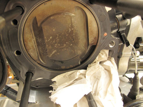

Dear Myr I'm swapping the engine today and will take pictures of the new engine the timing marks and all the detail. You have been of the air for a long time. The reason for our detonation was two fold .We were running 12:1 compression ration with both systems sparking. For that high compression ratio we should retard the timing and I was running the GS advance. I was over eager to see the full power it was tremendous it pulled the prop over 7000rpm and I had to bring in courser pitch. But short lived she detonated and within 3seconds she created lots of expenses for me. I'm swapping the engine because I'm going to open up the other engine to check for any damage further down like the connecting rods etc. I'm also changing the engine to GS specs that is a change of pistons and camshafts. But this weekend I'm going to tune the high power on the new engine. I will keep you posted.
Cheers Oupa-G
Oupa-G
Posts: 883
Postby Oupa-G » Wed Jul 22, 2009 11:22 pm

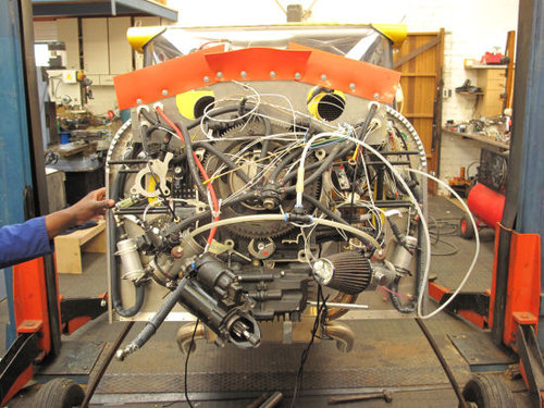

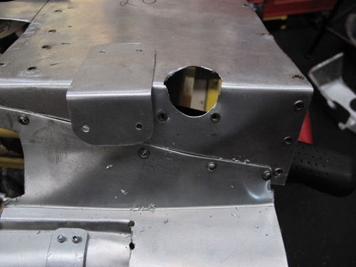

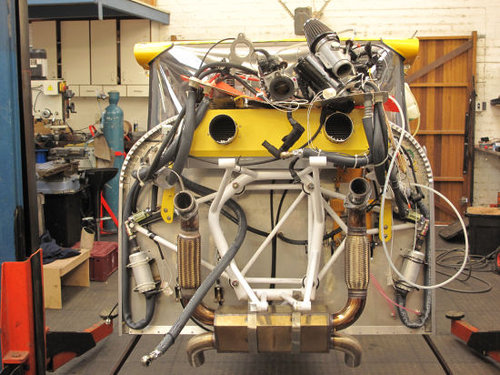

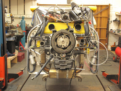

Back from holiday today I jumped in changing the engine first I'm showing the top of the piston the skirt above the ring broke off. I decided to change the engine not to slow down the Bosvarkie. Later I will inspect the engine completely before it is put into my Trike. It was very easy changing because all the wires and fuel lines pass through the top baffle so all the piping and the wires were disconnected the engine removed it is only hanging on two through bolts. The new engine was hung everything connected and by late afternoon the new engine started ready for the weekend high power tuning, this time I will tune gently and from the bottom power range up. I have put nice marks on the crankshaft so that I can check the timing advance with the timing light. I see the visits are passed 41000 I hope you enjoy the pics.
Cheers Oupa-G
Piston top
Disconnecting all vital connections
Everything folded back

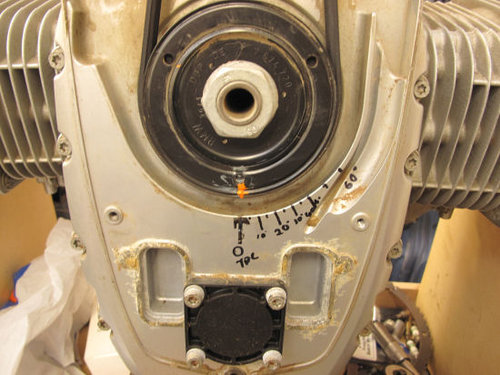

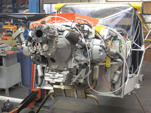

Some more pictures it shows the engine mount and then the new engine in place. It started immediately because all lines were still full and primed from the previous running. Also a picture of the timing marks.
Cheers Oupa-G
Engine mount bare
New engine in place
Timing marks

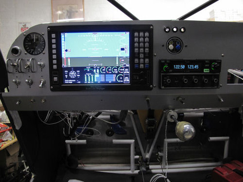

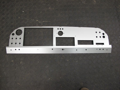

The panel is painted and is going back this evening. Base coat gray and matt finish poly-urethane clear coat to make it more wearable. Will post pics later.
Cheers Oupa-G

While Mike and James are flying ZU-TAF to America and further around the world, I plodded along in the workshop cable tying the loom and heat shrinking various bits and ends , installed the Voyager now for keeps no more taking out and fitting the Icom 210 was fitted with the already finished loom as well as the King KT76 transponder the wiring was made such that the transponder gets the altitude information from the Voyager. This instrument from MGL designed by our own brilliant Rainier Lamers , is flying at the moment in ZU-TAF and it also flew with Chalkie Stobbard to England and back. Isn't this NTCA movement stunning and the innovation is just mind boggling. What exciting times do we live in. The cross pollination of knowledge and to think it all has just started. Today I also with the help of Ystervark7 accurately measured TDC to make sure that the Eboxi is getting the correct info from the crank sensors. We have checked the actual firing point of both sensors and the correct polarity. A swapped polarity makes a 3 degree difference. After my last episode I leave nothing to chance. Then we ran the engine and set the box to Zero degrees and checked both ignition systems with the timing light. I'm now happy that the info is 100% correct. Also connected the Pitot,Static and the Angle of Attack lines and fitted the fuel drain on the header tank.
Just a few pics, I'm tired and of to bed.
Cheers Oupa-G

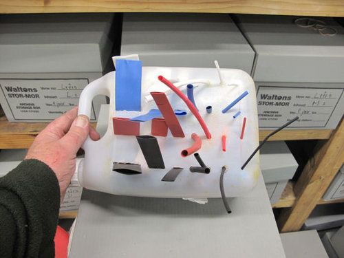

I have to be ready for 2010 because I'm not standing in any line to buy tickets so I will watch it on theVoyager big screen. This weekend been very busy. Put the baffles back and did some more wiring and generally making the wiring neat . In the process heat shrinking is part of the day's activity. I got so gatvol that I made a plan with the heat shrink the photo is self explanatory. All I can say the system works. Also made some access openings for the maintenance of the lower spark plugs in the baffles.
