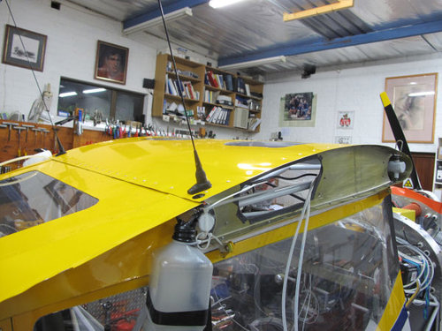

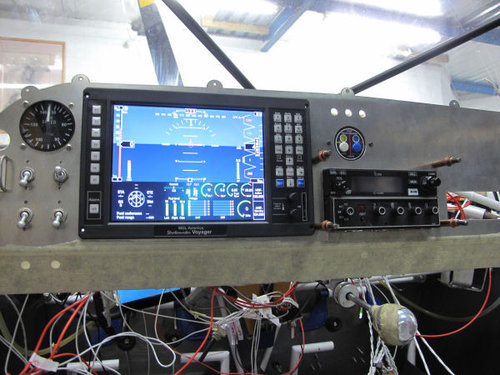

I see we have passed the 34000 mark what a wonderful response. Been busy all weekend, made time consuming radio and transponder brackets , installed the final panel also installed the aerials. Then to come the final linking of the altitude encoder of the Voyager and the transponder.All the little things eat up a lot of time. I'm aiming at finishing everything in the home workshop and then take it finished to the airport. The mating of the wings we have already done. So I expect no snags there. The week is starting again tomorrow. So I will have to go and sleep. Just some pics.
Cheers Oupa-G
Cheers Oupa-G

Things are nearing completion have Friday afternoon earmarked to do all the paperwork and the dual inspection of all controls. Boet is coming on friday and then we will inspire each other with the paper war he is more experienced then myself. Things are now exciting.
Cheers Oupa-G
Cheers Oupa-G
Had a quick peek at the Bossot this morning. Man, all those wires ……! Frans/Jan, your baby looks beautiful, (even without wings). Looking forward to see this major achievement realize in a perfect “take off”
