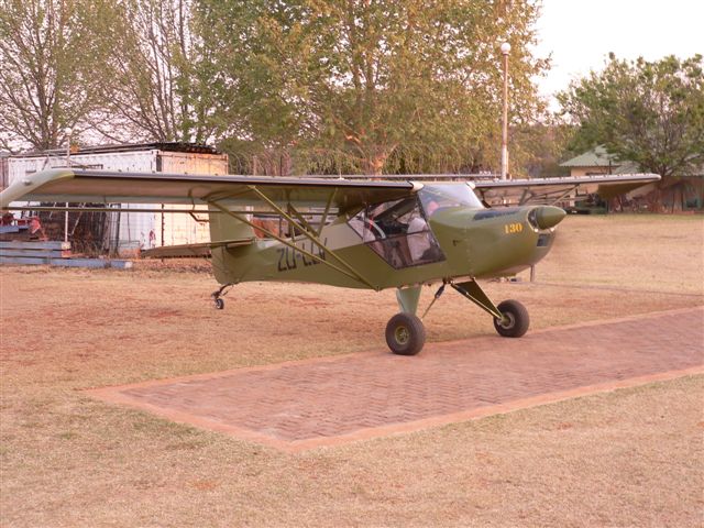

ZU-LLV had her maiden flight today late afternoon.
Mike Cathro was stuck in traffic for hours and could only take off at 05:37.
She flew just as well as any other Bushbaby, but has a small list of snags to rectify.
Radio became very noisy during the flight.
Needs right rudder imput all the time.
Angle of horisontal stabaliser to be reduced, could not get her to stall.
Flap handle returns to zero, needs to be tightened [ again ]
and some other small items.
Get them sorted this weekend and will fly again for further tests next week.
Werner took a vidio and I a few still shots, should be posted tonight.

Re: Bushbaby Explorer # 130
Some pics

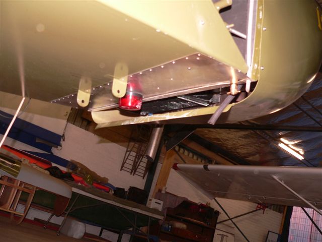

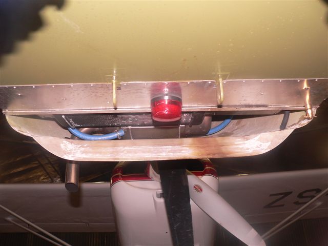

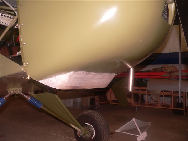

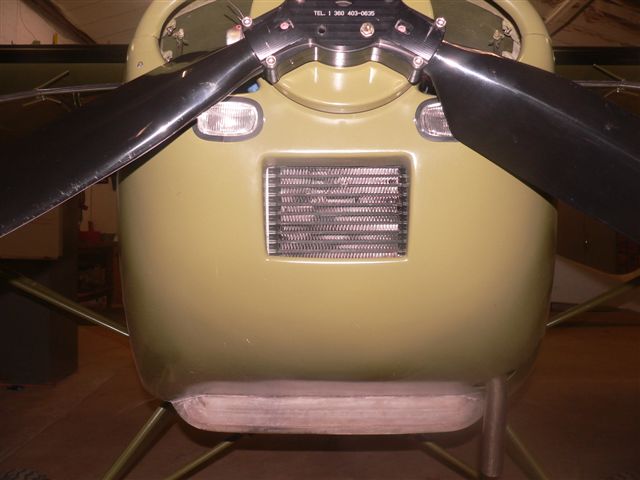

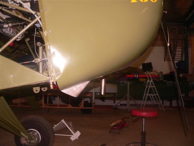

# 130 had another 20 min test flight by Muke Cathro and then he collected me and I flew 25 min and did some turns and touch and goes.
What a delightfull plane, so sensitive on the controls and very responsive.
Couple of problems, prop / engine vibrating very badly, so foo woith the prop and will try something else to establish cause.
The ASI seemed to over read by 20 Mph but took to Dart who tested it and showed 2 knots more at 60 Mph.
We had no idea actually at its touch down speed and cruise was 90 MPH with an over read?? will need some testing.
Busy with the undercarraige legs as they are flexing and need beefing up.

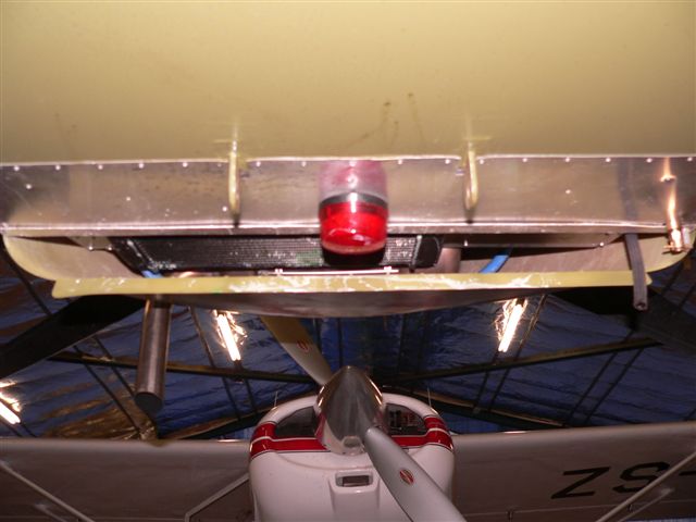

The attched pics show the new venturi I made and all temps suddenly now just where thay should be, or cooler, but it was not a hot summers day.
Now that holidays are here, I will be finishing my conversion and then need to fly out the hours.
Cheeres for now.
Now where did one learn about that nifty looking venturi underneath the cowling??
The flap handle tends to loosen up and creep after a while, so I have done away with the 6mm bolt as it does not do a good job, and replaced with an 8mm bolt. No more problemo. You are mighty quiet, done a lot of flying lately?

Hi Boet.
Wow, havent been to this site in many months.
Yes,I wonder, just who gave me he venturi idea.
Thanks, it works 100%, never had the engine get close to hot, not even on the max all up clinb test in 27 dg. temps.
