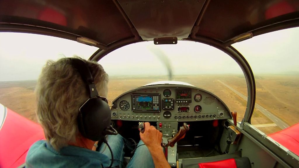

Finally looked like the first good day for test flying with the available test pilot. Got to the airport at 06h00, but suddenly the fog came rolling in
. After checking airplane again, wait and wait and wait for the fog to lift. Fog lifted enough to do a couple of runs on runway and just lifting of and fly above runway, playing with the power to keep it airborne. All handling was as expected. Then wait again for fog to lift. By 11h30 it lifted enough to do a circuit.
Johann took off into the wind and climbed out at 110mph. Turning downwind he throttled back to 4600rpm and airspeed 120mph......Okay, this aerie obviously does not fly to slow. Johann did a couple of turns over the runway to test handling. Handling is excellent with a very good roll rate. Pitch is not as sensitive as other Ravens, probably as pointed out by Induna, because I have lengthened the control stick for my arms. The plane also handles very good in the wind. All temps and pressures was in range with no abnormalities.
Johann says it flies like a jet fighter
. That's good enough for me
. He then came in to land because the ceiling did not permit to go higher for more tests. Now we wait for the next good weather day.....which is not close by
But as far as the speed goes, the aerie will definitely cruise comfortably at 125mph. Does not have the stall speed yet, but it lifted of at 70mph at 4900rpm with the Rotax 912uls.
