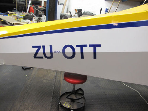

This weekend was rainy in the Cape and time was spent on all the tiny titbits that need to be finished . Put an extra spring on the centre section of the undercarriage and this has improved the roll stability and so the tapered section can be more active. The test trailer did not have wings with inertia. Our in house "Rocket Scientist" wired in the second system and late afternoon I was running the engine it started running erratic and now I also know what it sounds like when you run out of fuel. I have thus proven she won't run without "motion lotion" . Also Vliegvark decorated the tail with the future registration. Were moving forward but are now in the 10% stage that takes 90% of the time. Enclosed the ID of the Bosvark.Rest well tonight there is a long week ahead and a new month.

Postby Sukkelaar » Mon Jun 01, 2009 7:37 pm
Oupa g
Die OTTer lyk goed, en sonder die vark griep vhpy vhpy

Postby Boet » Mon Jun 01, 2009 8:41 pm
Looks good! Long week ahead indeed Full steam ahead. vhpy

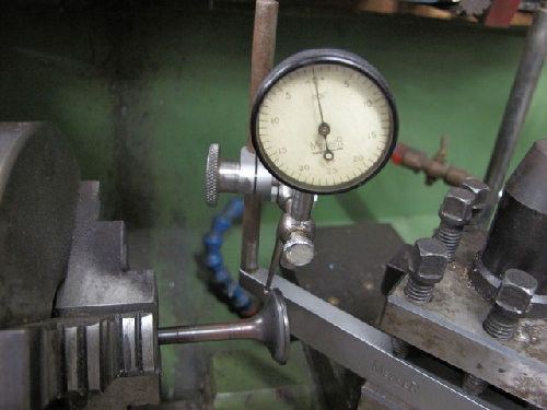

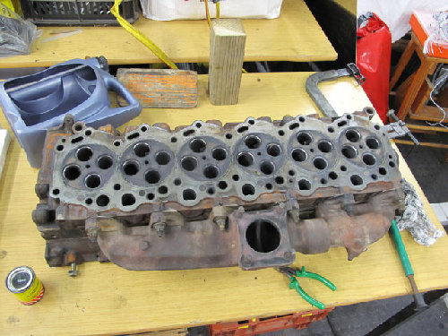

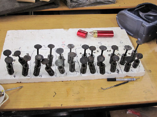

Had a busy weekend and the new week started with a bang. The weather is bad in CT so my attention is focused a bit on the engine of the Cruiser Only one valve bent out of 24 that is not so bad but at the the rocker end it is still a bit like the aftermath of a small hurricane, at this stage is a bit difficult to locate certain parts. Some of the rocker assembly bridges only come with the cyl head because every thing is line bored.I show a photo of the measuring of the valve on the lathe for out of round. Will have to resort to the Landcruiser club on the net . While waiting for parts I work on the Bosvark and when I can't get the necessary parts what is wrong with machining them ourselves. Between Waterjetting the parts and then machining them anything can be made even an aeroplane. Just some non-aviation pictures.
