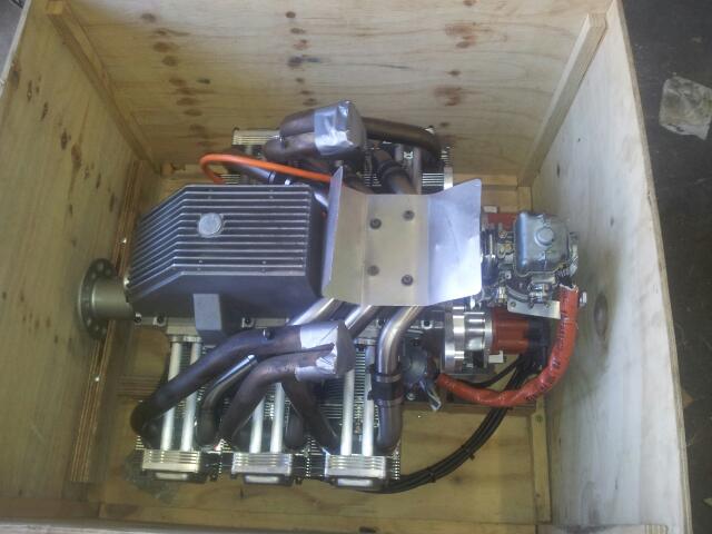

Just a brief update. After months of waiting, the various FWF bits arrived from Oz. The Jabiru factory just ran the engine in the test cell, and according to Giel, it is the best he has seen yet - a solid 2900RPM on the test prop.
All the bits and pieces should ship tomorrow, and I will start fitting this weekend!

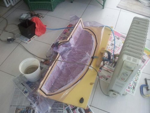

First, as a sideline, I have been making a new instrument panel. Need to improve maintainability, and fix some non-ideal ergonomics on my first one. Live and learn...

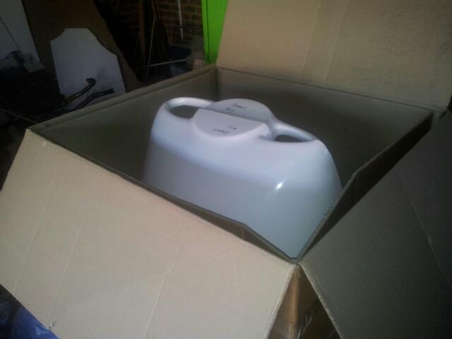

Here is the new panel in its mould: And the big fun - opening the boxes that arrived today! Still have some work to do before hanging the engine. New battery box is just about ready. New Jabiru air box does not quite fit - so I will need to 'edit' it a bit. Laid up the components for the oil catch bottle. And need to finish the panel. But the big things are the bits that go against the firewall, behind the engine, as these must all be fitted before hanging the engine. Will see how much progress I make this weekend.
