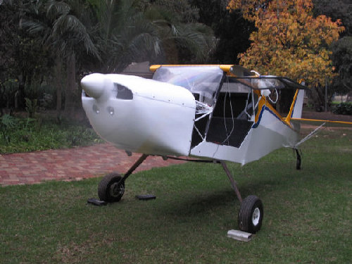

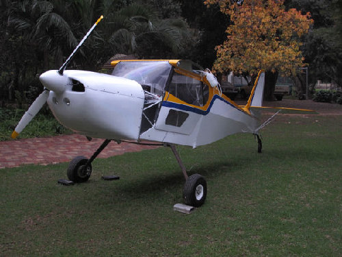

Anton`s cowling has now been sprayed. What do you guys think?? :) Self is dog-tired too, just stopped at home after the long drive from The Fairest. Going to keel over and cut down a BEEG forrest. zzzzzzzzzzzzz (**)
Postby Boet » Wed May 20, 2009 11:15 pm
Eish. VERY tired, forgot pics.... here dey are! :oops:

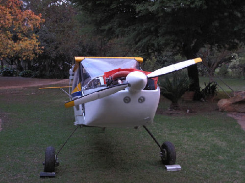

Back in the swing of things flew REDX last night came back in the early morning hrs with a RVR of 600m and landed, had problems taiing back to the hangar. The help from Pieter Rau the app controller was superb,he was in the tower and he never saw me the vis was done to about 20m . Team work is what it is all about. Today started the running of the engine on the lawn. I had the prop setup by the factory for 100hp at the designated rpm on full power she pulled the prop past the theoretical redline and I had to pitch it more luckily it is a variable ptch and the pitch is set by the stops of the microswitches by the looks of it I should be getting 110hp for take-off. To-morrow we will set the map for this prop engine combination with the help of our in house "Rocket Scientist" I'm enclosing some photo's of the lights they came out very well. The Midas spotlights have the same diameter as a KOO jam tin. Nothing like standerising ! The necessary fine liner tape has been bought and the rest of the paint job will be finalised in Durbanville. Quickly flew my trike this afternoon and it was just stunning weather. Otto was training his engine out landings and on his last landing I could only hear the whistle of the wing ending in a perfect landing. Just some pics enjoy them.

Oupa-G wrote:I should be getting 110hp for take-off
Hi Oupa-G, Are you sure it is 110 hp ? With your exhaust line and with the gear box, the power is certainly different. Do you intend to put your motor on a test bench ? It would be very interesting to know how many hp you lost with the gear box and how many you earned with the exhaust !
This make me think the power of most of the ultralight aircrafts motors are measured before the gear box. Don't you think so ?
PS : You have a nice garden.

Postby Oupa-G » Sat May 23, 2009 10:04 pm
Myr I take the hp from the BMW technical blurp You have prop losses gearbox losses exhaust losses but luckily all aircraft have that in the end we do not stare ourselves blind against all this but we look at rate of climb and weight and then we can talk about available hp. I,m not intending to build a test bench but I will definitely look for a Bushbaby with say a 912S and then compare similar weights and then do climb performance tests , then you are comparing apples with apples.All I can say that at full power I need two people holding the tail down . But if I had a choice I would not mind a windtunnel can you imagine how nicely one could refine the aerodynamics, my garden is big enough.
