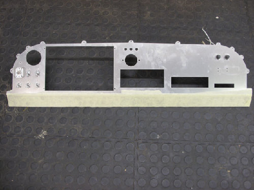

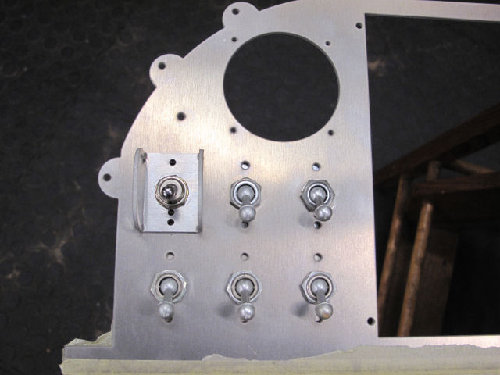

5 hits short of 26000 what a wonderful response. Today was not a good working day for me, spent most of the day in the operating theatre working on people that believe that cars and alcohol can mix but life and lamp poles prove them wrong. But they can sure spoil your day. So it will have to be to-morrow. It promises to be a nice morning and flying the Trike is on the cards. Every time I walk into the workshop the engine gets started cannot resist the lovely sound of the engine and silencer. I have started on the final panel it is ultra simple and is laid out with cockpit flow principle. That is the flow on the panel and cockpit is such that it resembles the flow of a check-list so actually you use your cockpit and flow as your check-list so the the switches and instruments are fitted as such. Once the panel is fitted I will elaborate on this a bit more. Sleep well

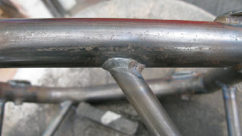

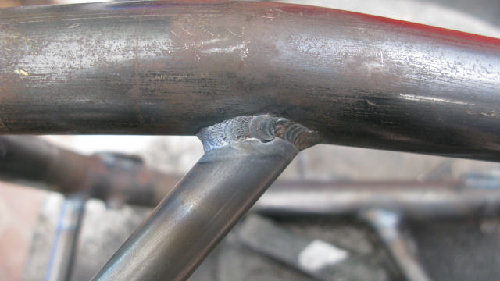

Oupa-G wrote:ID of Safari #141
Oupa-G

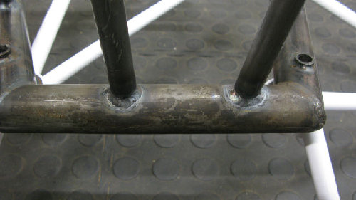

I don't know who did the welding in this pic but BOET!!!! Do you call that a lekker weld?. Don't tell me it's ugly but it's strong.
Postby Boet » Sat May 02, 2009 1:06 pm
I think you must query Vliegvark about THAT one. I plead: NOT guilty your Honour. Then one could hardly call the number a structural member. Can we? :roll:
bloody nitpickers. :evil:
Oupa-G
Posts: 883
Postby Oupa-G » Sat May 02, 2009 6:58 pm
Dear Tauruck
I agree that that specific welding is not of a high standard but I'm enclosing structural welds in the two Safari's and you will have to agree that they are nice. I have some more welding pics on the Exhaust that are superb I also have some pics of the welding done by the Cessna factory and that would not pass our critical eye, we are aiming at a higher standard because we are free to do so under NTCA. But we like critical eyes and are always open for positive comments. And if it makes sense we will apply the suggestions.

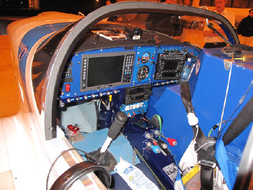

Thee long weekend went by in a flash between working and flying RedX coming back in the early morning 4'o clock flying an ILS close to minima's with fog blowing down our necks with the temp and dewpoint 13/13 C. in the Cape that means fog if it is a no wind night. A no sleep night sure destroys energy for doing anything the next day. Managed to replace the O-rings on the brakes of the Vansin with the help of a flying friend. Gunther is of smaller build then us and he did the difficult under panel work. The having to pump the brakes is gone and much more comfortable on a narrow strip. The filling of the system I do with a syringe from the bottom and that saves the tedious bleeding process. Had the panel remade to improve the cockpit flow, heavily inspired by the PC12 type of flow. On the very upper left the airspeed indicator, that is important during landing, your eye can look outside and with just a movement of the eye you can read the ASI. If you have to turn your head it is in the wrong place. I see many panels with superb workmanship but the poor ASI is sommer put anywhere. The switches are all of the breaker type except the master that also has a physical guard. On the right hand side are the 2 circuit breakers. One for the main system and the other to isolate the alternator. Enjoy the pics

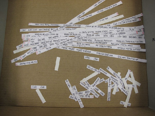

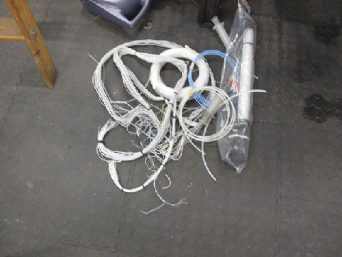

Been busy now on the second harness for the backup system. The labeling of the harness is so important and luckily our in house "rocket scientist" came up with a good idea . He made the labels in duplicate and then each separate cable gets marked with two labels which have sticky backs and then the loom gets made to fit the aeroplane. Then the terminals can be crimped, in that way mistakes are eliminated. Before binding the loom all labels are cross checked. It also helps with tracking any faults later. Because we use Teflon wire and every wire is white identification is imperative. Friday I'm going on a short holiday the whole plane building team is coming along we are going on a trip from Luderitz to Walvis Bay and the Loeriesfontein branch will have to work on the Bosvark soap opera. Enjoy the pics of a budding Afro hairstyle.

The Panel

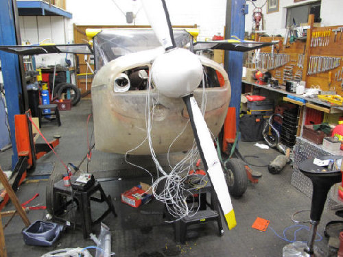

Yesterday morning I woke up, feeling very un-well. Went to Dr. Dr said to stay in bed or risk dubbel demonia or somfin. Gave anti-biotics pain pills and tackies gor my runny nose. GOING TO BED??? Sorry, no time to lie down. Sleep a bit later and knock off earlier. Staying out of the cold air helps somewhat, but right now my chest sounds like I swallowed a lot of rugby-ref whistles. We had another VERY busy week. Oupa`s bosvarkie`s cowls are painted, but I cannot do the final colour trim, because obviously I will need the rest of the plane for that. While the paint was drying we tackled two more BB`s that is in dire need of some TLC. Oupa and the rest of the "Super Team" is still in the Namib somewhere, hopefully NOT pushing Prado`s around. Anton`s Bos-Ot is getting its yellow trim sprayed on tomorrow. Weather willing. We have a big cold front coming in from the coast. so it seems flying is going to be out for the weekend anyway.

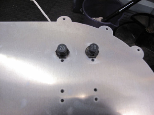

I hope Oupa will be happy with his 2 lights that we installed, using some tried and tested rain-gutter genuine aeroplane parts. :roll: vhpy vhpy vhpy vhpy
