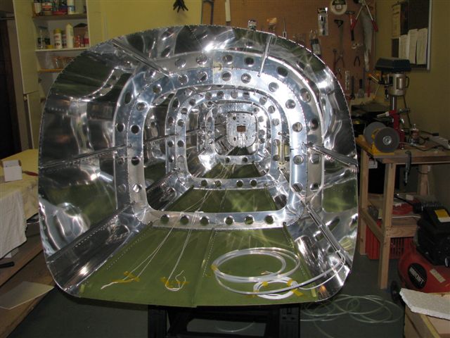

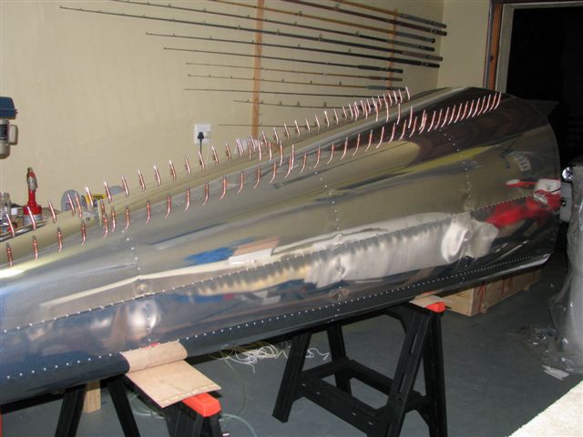

Re: Reilly's RV 12
Ok as promised the updated pics.
The tailcome was actually completed some time back but no pics posted. This completed the empenage kit comprosing of the vertical and horizontal stabilisers, rudder, trim tabs and the tailcone.

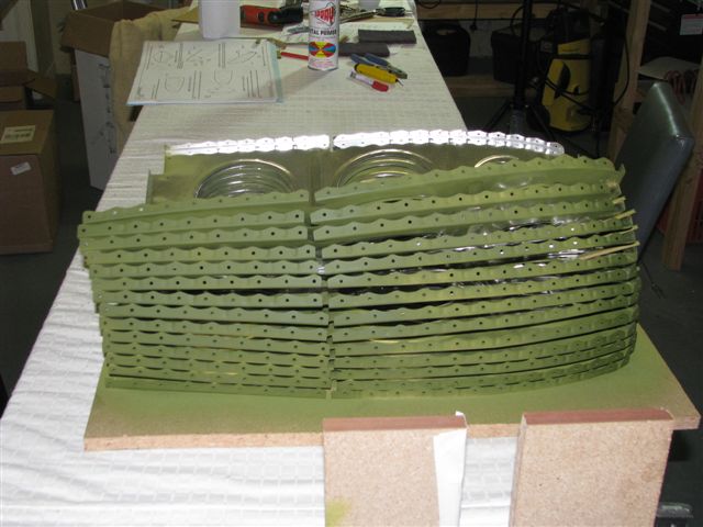

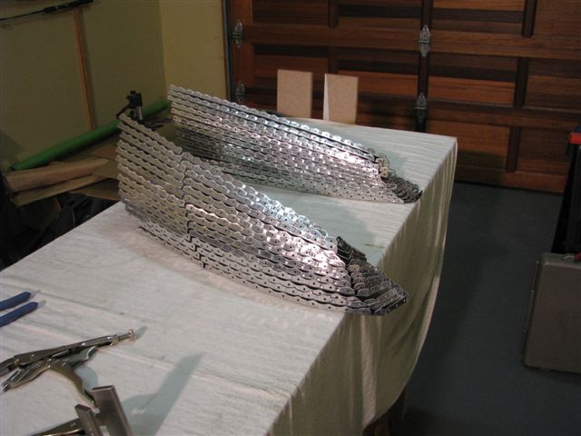

Re: Reilly's RV 12
Working on the wing ribs is a painfull and boring job. There are 54 ribs
Firstly all of Vans alluminium parts come covered on both sides in this blue plastic for protection. It is a ball-ache to remove and also wastes a lot of time but hey what can one do.
Once the plastic is off, deburr all edges and holes including the lightening holes. Here the right tools can make it a lot easier. As I mentioned before many of the ribs get trimmed in different places as well.
Then all ribs have to get fluted which is to crimp the flange in the right places by the right amount in order to get them to a straight position. The main ribs were a lot easier than the nose ribs but one does get the hang of it after a while. Also need to make sure that the flanges are at 90 degrees. This will ensure that you minimise the dents when it is skinned.
Lastly I have primed the mating edges. This is not necessary as the 1024 alu is alclad but it is just an additional anti-corrosive measure.
