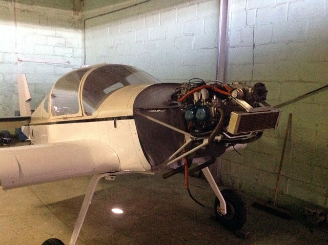

Today i installed the engine. Tomorrow will be a general cleanup and also completing the control cables. Still have to make trays for the autopilot servos...
Will upload some pics tomorrow... :)

This week has been productive... All the small stuff that takes most of the time to complete.
The engine has been fitted, oil tank, radiator, oil cooler, exhaust system, etc has also been installed. I also installed the aileron autopilot servo, electric trim and all control cables.
J.

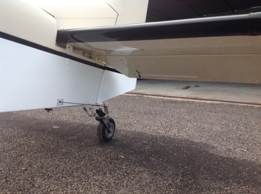

One thing that bothers me is the angle that the tailwheel is connected to the rudder. It makes steering harder and actually stresses the rudder attachment.
I would maybe like to connect the tailwheel cables to the rudder cables closer to the fuselage. this way I can decrease the angle thus needing less force to steer and no bending of the rudder horns.
Any ideas??

Bout n staal "doubler" onder die rudder horn vas. vhpy

Dit klink na n plan Boet, maar dit maak die stuur moeiliker, selfs al tel ek die stert op as ek toets met die wiel weg van die grond af...
