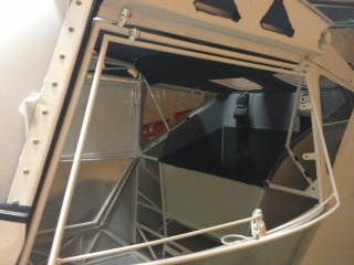

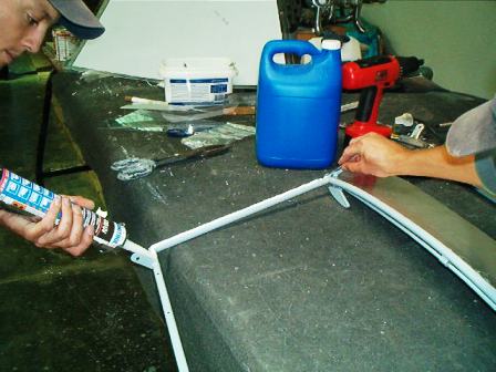

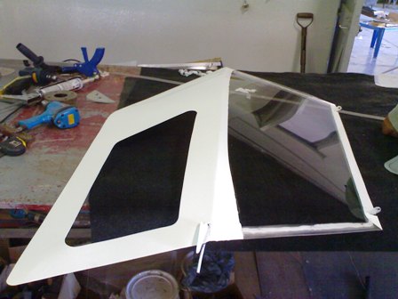

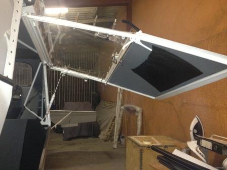

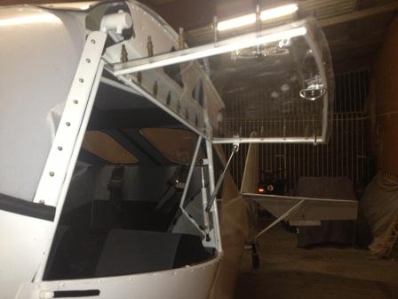

Hi Gents
I have fitted a window frame to my door frame and now scratching my head on how to cover up the outer tube frame the door to the base of the butt rib.
Could anyone enlighten me with a couple of pictures???
I would really appreciate it... Or email
gavin At haps dot co dot mike zulu
Re: Building the Safari in Maputo
Postby Boet » Sun Mar 10, 2013 8:13 pm
Look at the pics. We use a poly urethane sealer / adhesive to stick the panels on. Sikkaflex or Dinitrol) You can buy these products from panel beater shops or automotive paint suppliers. Sand and clean the frames and the glass panels off with acetone or Sikkaflex cleaner. If you have a "loose" flap-up window, just make the edges wider. And we use a few 2.3 countersink rivits just to hold things in place untill the glue has set. You are building fast. In a Hurry? Just make sure you do not screw up. The AP is not going to dismantle the whole dang thang to check you up. DO THINGS properly! ......please!

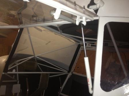

Postby Mozfly » Sun Mar 10, 2013 8:38 pm
Thanks!
Trust, making SURE of things before just rushing in. Stephan will be doing the wings, engine and electronic installation.
Anyway, my door is abit different to yours, as I said I have a window frame installed on in the door frame. Now if I fit the window that it stops just under the but rib, the door or window frame will not open. So ideally it needs to be riveted to just over the widow frame, leaving me with a nice big gap between the tubes of the door frame an the base of the but rib.
I already know I'm gonna have to re-do the other door...

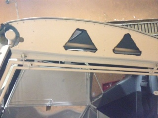

The frame
KFA
Posts: 2789
Location: Now at Petit (FARA)
Postby KFA » Sun Mar 10, 2013 8:42 pm
Best just to leave it. I will make a plan. You need vents in any case for the hell hole you will be flying in and out of....... 8) 8) (-)

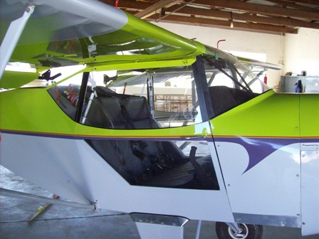

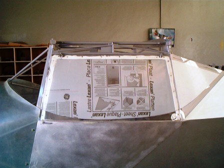

Hi Guys,
Due to a great lack of time, I have safely take my Safari to Petit where Stephan will complete the build.
The following pictures i will post is of the last few tasks i have completed.
I am sure Stephan will keep us updated with some pics over the next few weeks!
First Time
Mozfly
Posts: 100
Joined: Sat Oct 27, 2012 9:56 am

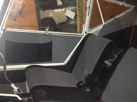

Postby Mozfly » Mon Apr 08, 2013 5:59 pm
Doors are on

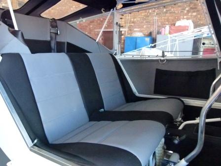

Postby Mozfly » Mon Apr 08, 2013 6:00 pm
Interior done!

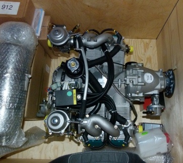

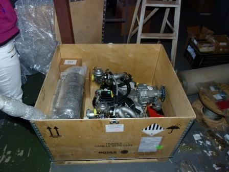

Postby Mozfly » Mon Apr 08, 2013 6:02 pm
Collected my Rotax 912 ULS (^^) vhpy vhpy vhpy

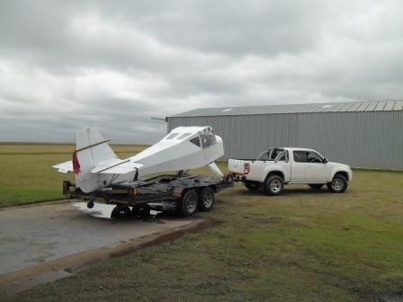

Trip and Petit

Postby Mozfly » Mon Apr 08, 2013 6:03 pm
Mozfly wrote:Trip and Petit
