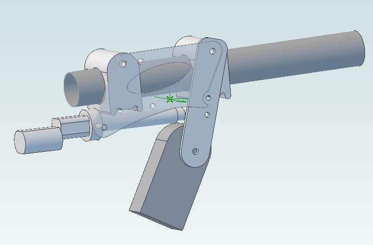

I have done some planning and design the past couple of weeks. Below is my latest 'creation'. If you guess that his is a new gun that you can use in a computer game, you are in agreement with my son. (He just wants to know if he can try it out.) If you guessed that it is a 'new' actuator design for a trike wing you are correct. I have not seen something like this so I think that it is unique. (I will probably find out that somebody has tried this 30 years ago)

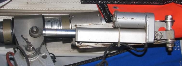

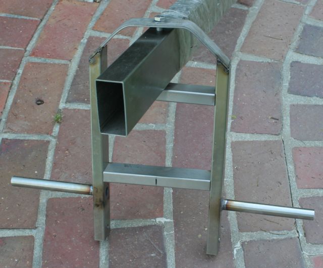

Most actuators that I have seen look something like the one in picture 2. There are 2 problems with this design: 1) it is asymmetrical 2) you need very articulate joints because the wing rotate in the mounting block relative to the pylon. It can also be difficult to mount because it can interferes with the sail.
With this new design the mounting block does not slide any more but can still rotate. (In fact I am using 2 fixed blocks in this design. I have a different design if I can find a shorter actuator.) The hang point is changed by swiveling the hang plates around the top bolt. The wing can still rotate inside the hang blocks and because the actuator is in the center, it is symmetrical. I will use the 2 bottom holes on the block as stops.
My only concern at this point is that you might need more torque with this design because of the lever that you create. I suspect that with the older design a lot of your torque was wasted due to the friction between the block and the aluminium pipe. I hope that I gain enough because I do not have friction to compensate for the higher torque needed. Also note that the design is safe against breakage of the actuator itself, if it does fail it should be hanging down more or less in the middle.

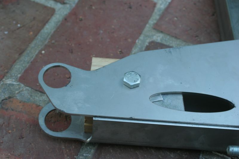

After a long break I have started building again - no excuses, maybe just needed some psychological preparation. Most of the frame is now cut and welded. Still trying to get a build number from CAA.
The first photo shows the fork tacked together and mounted on part of the frame.
This is the part of the frame where everything comes together, the jointing point between the pylon and the engine and the frame. I think that it is a bit of an over design but at least it would not break. All parts are spaced exactly for welding to ensure that it does not warp.

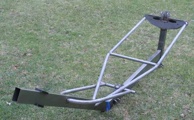

Postby ystervark7 » Tue Nov 30, 2010 6:34 pm
The frame is now partly welded and the seat frames are tacked. The total weight is 16 kg which is slightly less than what I budgeted for in my calculations. One or 2 smaller brackets such as the pod mountings and bottom pylon bracket are still missing which will push it close to the 20kg I originally estimated.

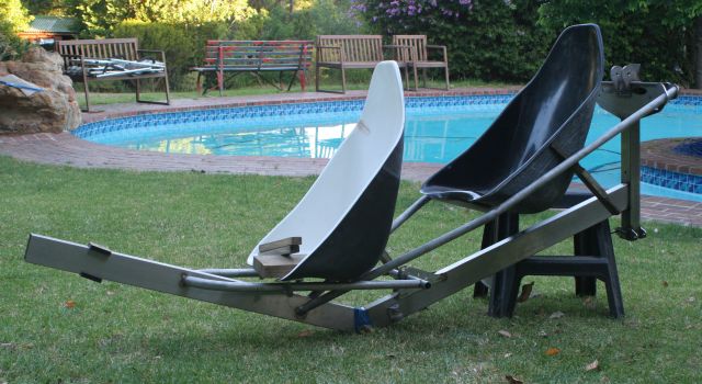

I borrowed some seats from another trike to make sure that everything more or less fits. The back seat will be a bit more upright and the front seat must lean a bit more to the back. In the final installation I might use a simple "webbing seat" such as used in the Spirit II for example. The back seat is not used that often and you only need the rigidity if you are flying the trike. This will save some weight and cost.

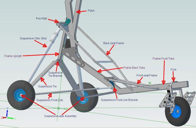

Making progress. Here is a 3D render of the frame and all its parts.

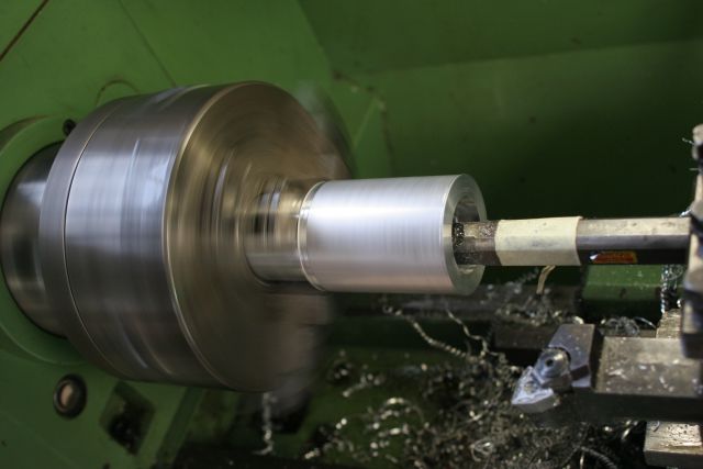

Lately most of the work is on the lathe. While I have done a lot of work on a wooden lathe when I was young, I have not done much work on a metal lathe so it takes a bit more time.

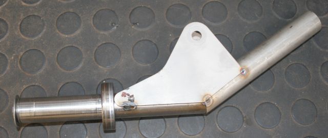

Here I am busy with the bottom part of the suspension strut that connects to the axle.
I finished my back axles yesterday and Jan tacked them together. This is the critical part of the back suspension because every thing joins at the axle and all angles must be correct.
I also got my oleo's yesterday. They were made by Oleg in Ukraine, more or less to order. They are just beautiful !! I will hopefully take a photo of the frame with the suspension tomorrow.

Postby ystervark7 » Mon Jan 10, 2011 6:31 am

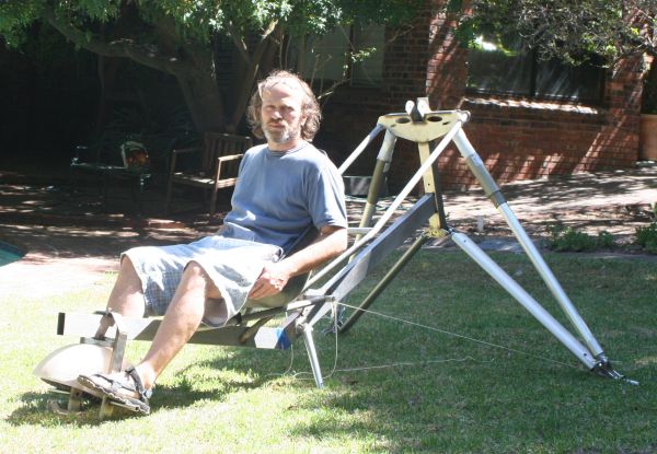

The frame is now standing by itself and it does not collapse if I sit in it!
Most of the frame is still only tacked together. The final welding will only be done by a certified welder when I have all the parts fitted.
