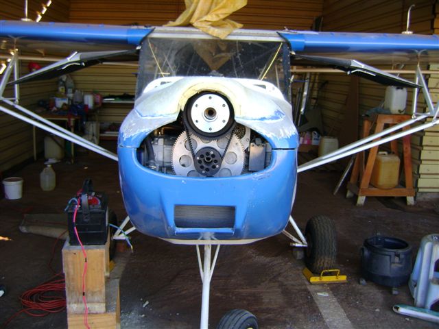

I have an interesting story to share while we are on the topic ($$) (!!)
This past week-end I visited an old friend who I haven’t seen for years. His father in law rebuilds aircraft engines and his partner classic aircraft (tube and fabric) anyway, the conversation went to "what do you fly" and we ended up speaking about engines. Rotax in specific and this guy pipes up “did you hear that they are removing all Rotax engines from the market" "No why?" He replied, “well the things are so unreliable, breaking down ALL the time" well I questioned him as to what seems to be the problematic thing on the said manufacturer’s engines. He said something like "oh nothing specific". The very next sentence I asked about all of the engines in the workshop in various stages of rebuild. I said but surely in one workshop here I see more Continental, Lycoming etc. engines with conrods through the block seized pistons broken valves and much more to mention. I swear there was more "real airplane engines" in that one workshop that we have commented on in total on our forum ## (**) ($$)
I just smiled and walked away.
Point is ALL things mechanical can and will fail for various reasons. If you make use of a machine, such as an engine, in a application that it wasn’t entirely designed for, such as a automotive engine in an aircraft, you have to accept that certain parts and or devices directly related to the operation of such a machine will need some serious rethinking :shock: :?
So it always takes one special person, like Oom Jan BMW, to make that first step. I’m sure that he will tell anyone that one of the most important steps in this long and tedious process is carefull documentation of each and every experiment that you carry out. I’m very sure that in any one of this documents you will never find a comment like “the thing is unreliable for no specific reason". That will be a waste of paper and time.
So, in my opinion, you can take any machine that you wish, redesign modify and adapt and if you have done half decent job you will be left with a piece of engineering that will serve you well. But hear this if you do this and that because your uncle’s, sisters husband’s brothers boss did this with his and it did or didn’t work, you meneer, are bound to become a statistic.
This is a long story because the next “real pilot” who flies a rented C172, on occasion, (**) tells me that “the dangerous things we risk our life’s with” :evil: makes us cowboys, and even more so because we dare to make use of something that isn’t certified, is seriously begging to get bliksemd. If you are going to be too clever for yourself, come into my hanger, tell me about air flow and pressure, ** please please sir at least understand what you are saying. You are just showing the rest of us precisely how dof you are.
OK now that Im feeling much better, and have aired my views Ill attach a pic or two.
Thanx for being a great bunch of guys puff
Oh yes, guys the rant is not because of the comments about the engine (^^) (^^) I appreciate those :!: :!:

Sanna, daai BosBaba lyk sommer baie mooi, weet hy gaan lekker vlieg, jy sal hom vir ons op Rhino Park moet kom wys (^^)

vhpy vhpy Ja se iemand anders nou weer vi my,hyt n wipneus so amper asof hy dink hy is beter as ander...... (-) Nou ja ons sal maar moet sien hoe hy gaan vlie :wink: Die eend se maar niks ek dink hy is so siek dat hy nie eers oppie net kan gaan nie, ag shame............

van die waarste woorde wat ek nog gelees het. Ek dink partykeer daai manne met die rented 7-10k ure een skewe twee`s moet die cowboy badges dra. Sterkte met die BB, dit lyk goed, jy bekyk die hele besigheid van die regte kant af.

Daai neus gaan vra vir n mooi spinner. :wink:

The Machine is looking Baie Mooi. !!!!
