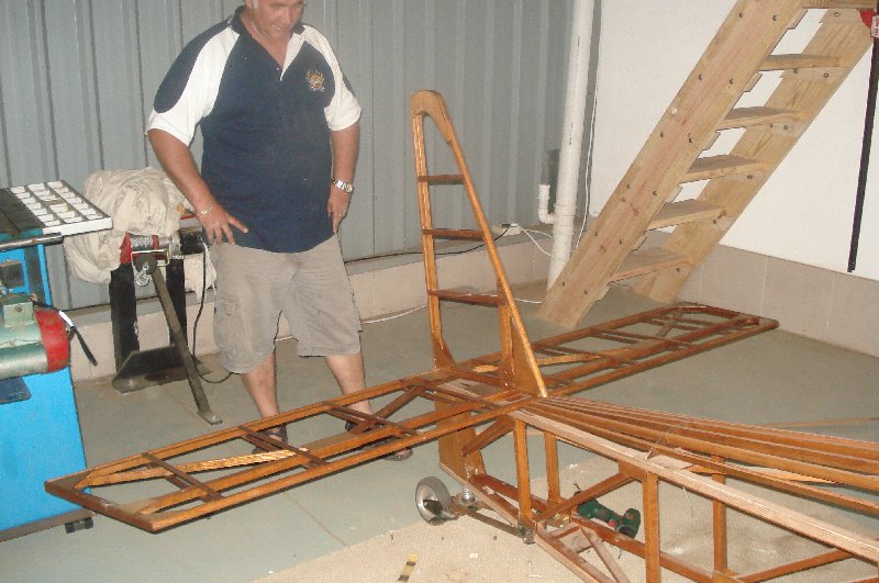

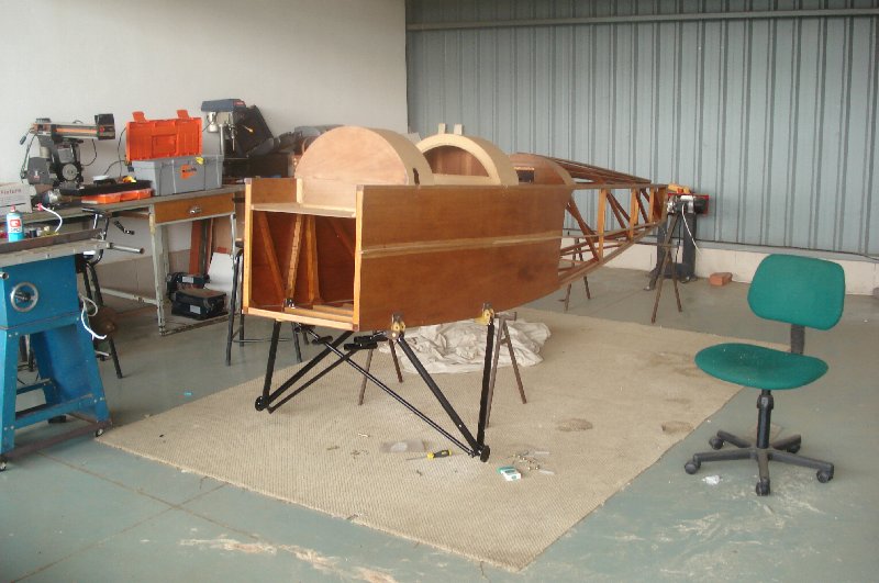

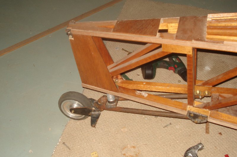

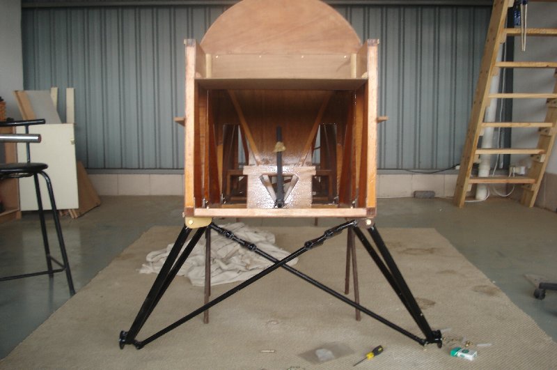

As promised here follows an update on the progress.
The main undercarriage, tail wheel and the fixed portion of the empennage was mounted.
I will need to replace the coil spring in the tail wheel assembly as the current spring is compressed very near it's limits with only the aircraft own weight on it.
The wheels were fitted with second hand tyres just to have something for it to stand on temporarily (Thanks Gerrie!!)
I will fit the wheels this weekend and hopefully the empennage control surfaces.
All main wing ribs received the final coat of varnish and is ready for fitting to the main spars during the next two weeks.
All of the metal fittings and parts will also receive a coat of paint during the next two to three weeks.
A lot of people are showing interest in my project and I really appreciate each and every person who walks into my hangar and discuss the progress.
Following is a couple of photo's to show the progress and general status of the build.
This is where I stopped on 17 October 2009
Beginning to take shape!!
Tailwheel assembly
Front view
Main undercarriage on
