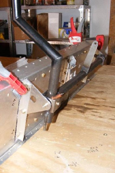

In the past few days I have attached the front end of the aileron torque tube to the main spar and drill through the spar (scary) to place the uprights for the dual control sticks. I had to remove the spar from the fuselage to do this accurately as the picture shows it sitting on the workbench.
Thankfully things seemed to go well and the control sticks seem well installed. A couple of tweaks required to ensure relatively frictionless movement but I will work on these later. Also decided to go for a matt black finish to all the steel components...so i primed and sprayed the control sticks and one of the gear attachments. It came out quite well in the end with some spray from the local hardware shop....hopefully it doesn't all scrape off though. :x

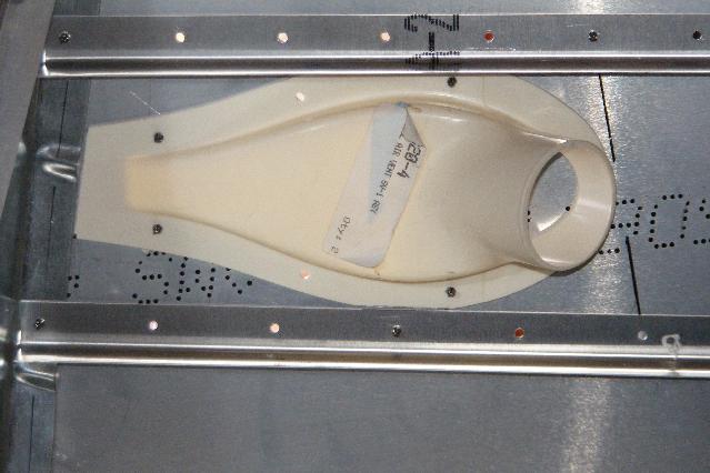

Another quick update...attached the NACA vents cockpit ventilation. Will have to start considering shelling out for some of those eyeball vents for the cockpit...I looked at the prices on Aircraft Spruce and they are not exactly cheap.

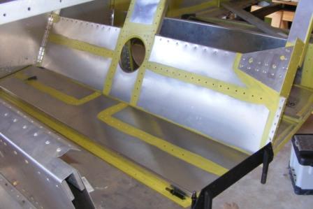

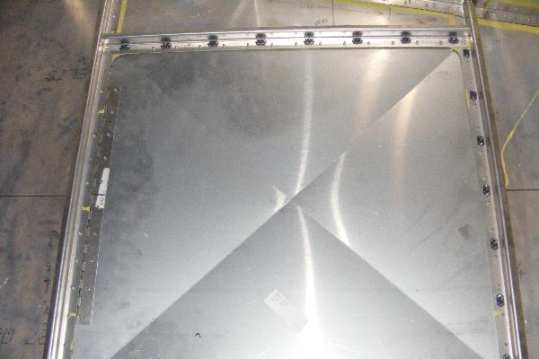

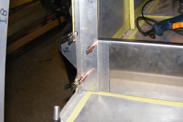

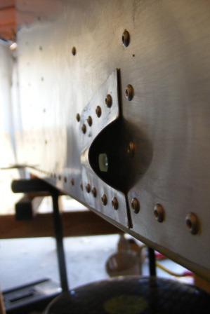

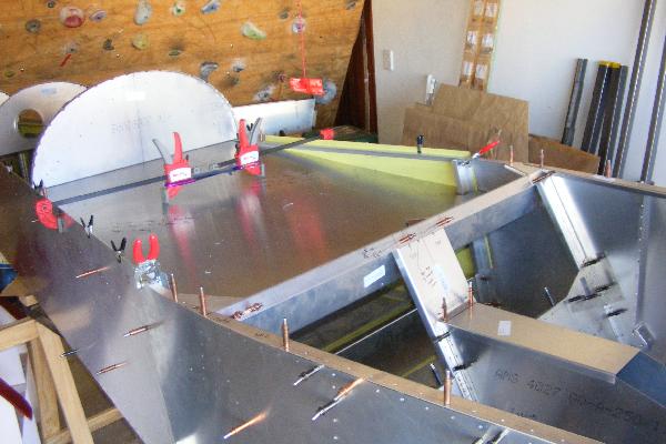

Made a reasonable bit of progress recently. Finished the access hatch under the fuselage and riveted that to the fuselage (see pic) only to have to drill it out as the beams supporting the fuselage prevent the door from opening and thus finishing the inside of the fuselage.

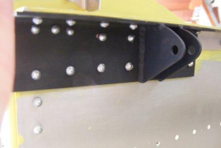

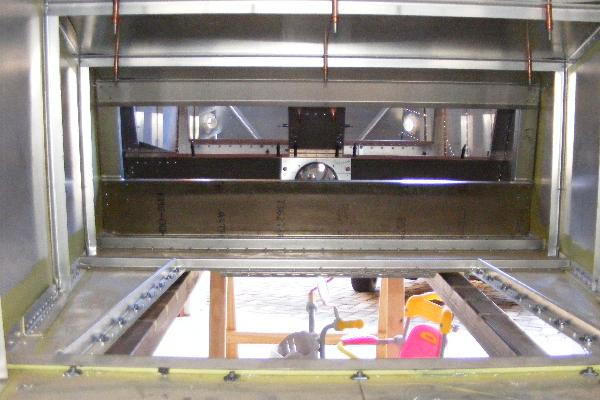

In the last weekend or so I added the horizontal braces for the baggage floor which run from an upright on either side forming a rectangular box shape (pic - inside fuselage). The lower corners of the rectangular shape are the location of the wings rear spar attach points (see other pic). In the last two pictures the rear spar carry through is the one that I replaced and upgraded to a thicker material to add further strength. The Zenith modifications mean that the rear spar attach point will also be upgraded to 0.125 and therefore I will use the existing ones as a drill guide to ensure that the holes are not elongated and placed accurately (instead of back drilling).
With the baggage floor mostly installed (cleco'd into place) the aircraft's structure has suddenly become quite rigid...which is reassuring.

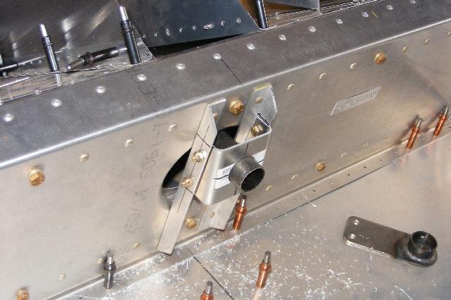

Riveting the final lower seat assembly with holes for the torque tube
Riveted the flap actuator mount to the seat assembly
Closed up the rudder fairlead holes
