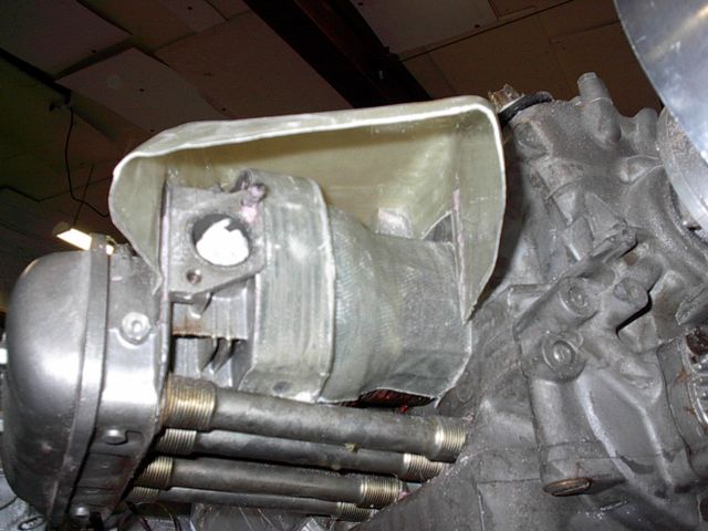

I was thinking of something like this (shamelessly stolen from schmelf on sonerai.net):
Any air the enters the baffle must leave through the fins. These guys race formula-V aeroplanes, running flat out at 4500rpm for the duration of the race (making around 100hp).
Admittedly, they have a 200mph air stream to help with the cooling...
