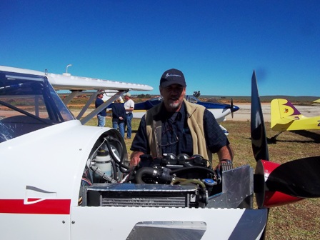

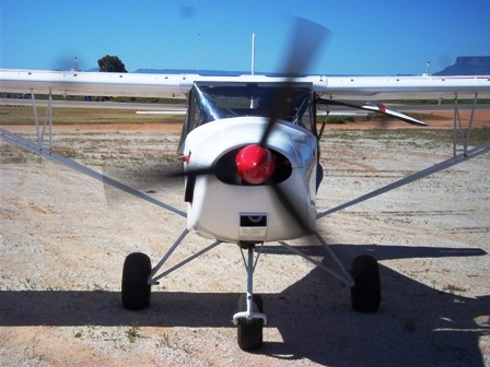

Taken at Vredendal Fly In
Didn't make it last year due to rain. Made it this year.
Johan Froneman's Yodel
Re: TOYOTA YARIS ENGINE
Postby Boet » Sat Sep 03, 2011 8:35 am
And here`s the man himself, and his pride and joy. This mod has been running faultlessly now for many hours....... The engine itself has not been modified at all, exept for the throttle bodies and the ECU. vhpy
DD 1.JPG (89.99 KiB) Viewed 12467 times
DD 3.JPG (97.1 KiB) Viewed 12467 times
