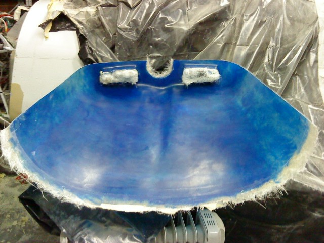

If I was a drinking man, tonight would be a good night to go get thoroughly sloshed... The culmination of 2 1/2 months work, and the bottom cowl stuck in the mold :( . 2 Really bad spots, but salvageable. I hope. The mold is also going to need a lot of work before it can be used again.
I can't really understand how it happened though. I have never had a part stick before. I had 5 good layer of wax on there, and not the slightest hitch wiping a soft cotton cloth on the surface - it was smooth, clean and well waxed. To make it worse, the really complex curves around the oil cooler inlet popped out perfectly - it only stuck on the flat(er) areas... And it bonded so well, that I pulled chunks of the mold's gel coat out with the cowl - bonded as if it was a nicely sanded and acetone washed surface!
I hope the top cowl comes out cleanly - that is mostly flat areas!

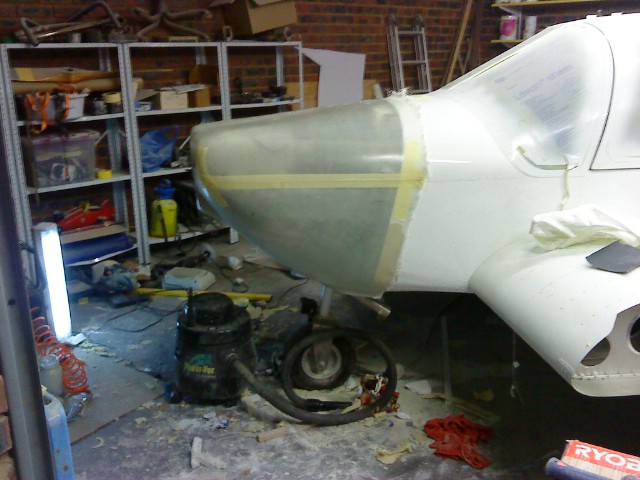

Rough trimmed, and trial fit the cowl tonight. Fits perfectly, and (I think) looks quite good.
Cowl attached with Super Universal Cowl Attachment System (masking tape):

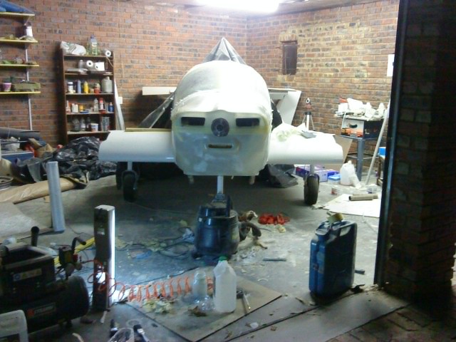

From the front, you can see the boo-boos on the lower cowl:
The cowl is pretty rigid all round, but probably a little too flexible on the large flat areas at the top and bottom. I will add a small reinforcing ridge tomorrow, as well as adding a flange to the nose section. As long as I don't get too cold/lazy, I should be done by the weekend!
