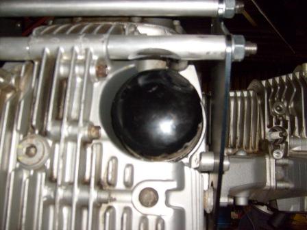

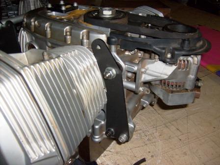

Went to visit the Trevor and the Thunderbird this morning and got some detailed pictures (Prentjies for the others). I am very exited and can't wait. Trevor cannot do the final assembly/welding before been inspected by CAA inspector, so now we wait.
The performance and handling of this Thunderbird is just going to be in a different class. The engine is way back and well within the C of G. The thrustline is 100% inline with the wings, not like previous 912 Thunderbirds where the thrustline was way, way above the wings and the engine had to be tilted to compensate for this. There is also no mods to the Standard MKII airframe so this will be a quick conversion for future Thunderbird owners.
Trevor has built jigs so that future mounts will be quick to built.
HOPEFULLY not long now.
Bracket on Top of engine
Top mount bracket.JPG (57.73 KiB) Viewed 4084 times
Engine brackets mounted
Engine Brackets mounted.JPG (81.59 KiB) Viewed 4084 times
Mod for oil filter replacement
Mod for Oil Filter.JPG (55.23 KiB) Viewed 4084 times
