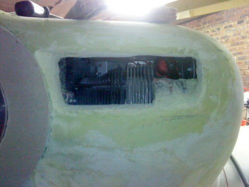

Re: Justin's Raven
A motto to live by: If at first you don't succeed, CHEAT!
Just could not get perfect half circles to round off the inlets, so instead went with rectangular inlets with simple quarter rounds in the corners.
Still need to build up, and straighten them, but I think this will work a lot better!
