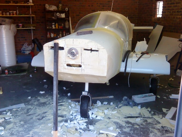

The pre-lunch session...
The big stick in front is my sanding block - the general idea is to use a long, straight sanding block to sand the plug parallel, and flush with the fuselage skin, so that it blends in cleanly all around. Once I have a nice clean reference shape, I will start profiling it to blend nicely with the nose.
Just need to figure out why it is not symmetrical - it does seem to be parallel to the fuselage skin...

Looking good Justin, funny how the discipline of a good job and a BIG stick work together......
Regards Jean

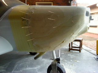

Made some good progress towards the final shape, but discovered an important caveat for building a tight cowl: The difference between 'That looks perfect', and 'What the hell is the exhaust pipe doing there?' is just one pass with a surform...
I will need to get some XPS sheet tomorrow to glue onto the plug to put a gap in around the exhaust pipe and oil lines.

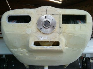

OK, I quite literally have PU foam dust coming out of my ears now, but I am finally approaching the shape I had in mind. Much sanding, swearing, filling in, and sanding again involved. Still a bit of tweaking to do, but definitely getting there.
Boet makes it sound so easy, but unless you are a sculptor at heart, it is a serious pain in the *rse...

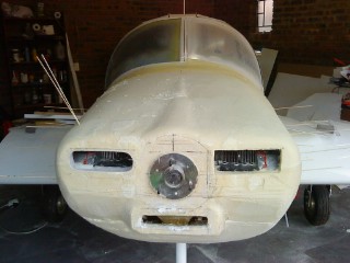

Justin, ALLES in die lewe is "maklik"........ as jy dit al n paar keer gedoen het. As ek nader aan jou was, het ek jou gou kom help. Maar ek is 1000 km van jou af. Die inlet gate se vorm kan jy so bietjie modify. Ek merk ook so n bietjie skeef op die "wange". EYEBALL Boet, eyeball. Maak net seker dat die gat onder groot genoeg is, sodat die warm lug onder kan uit. Ek sit liewer te veel as te min koue lug voor in. Volla enjins loop sommer gou te warm, en dan collapse die ou ringetjies. En dan is die ou vollatjie SISM, SISM.
